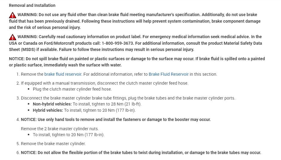

My brake pads were metal to metal so i replace the rotor and pads. Bled the brakes and had a pedal but it slowly goes to the floor. So, went through the calipers and the rear calipers were bad. Replace them now the brakes will not bleed i have no pedal.

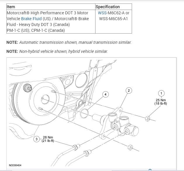

This sounds like you have a bad master cylinder as that is where the pressure is produced for the system.

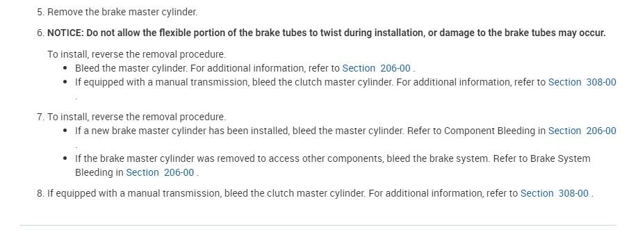

I attached the procedure for replacing the master cylinder.
https://www.2carpros.com/articles/how-to-replace-a-brake-master-cylinder
https://www.2carpros.com/articles/how-to-bleed-or-flush-a-car-brake-system
