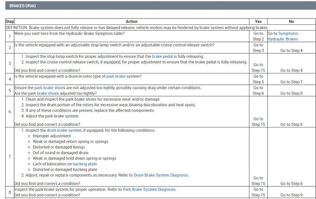

Did the click happen on the inside of the vehicle? Was it under the dash on the driver's side? I'm asking because it is possible that the brake light switch is sticking and causing the brake pedal to not full release. What can happen as a result is the brakes are slightly applied. Over time, they heat up which causes the brake fluid to expand until the brakes are locked.
Okay, that is a theory at this point because this isn't a common issue. However, if it happens again, I need you to walk around the vehicle and see if there is excessive heat coming from the wheels and which ones seem overheated.
I have to be honest. There isn't a solenoid that applies the brakes. It is a hydraulic system. Something is likely dragging at times and causing one or move of the brakes to overheat. That's why I suggested checking for heat.

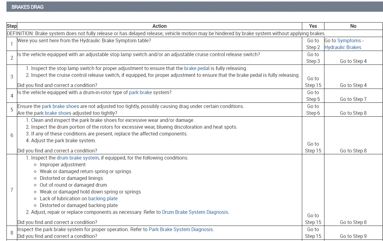

I don't know how comfortable you feel with working on the vehicle, but I am going to attach a few pics below that show the diagnostics related to brake drag. Note that it indicates the brake light switch among other things.
Take a look through this information and let me know what questions you have. I can't be sure, but I suspect the brake light switch is causing your problems. The sound you hear may be it unsticking. Let me know if when this has happened, if it was after driving a few miles.

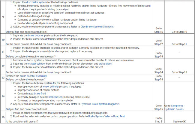

Thank you for the information. I thought the brake pedal, but checked that and it appears to work fine. It appears to be the right front that is hanging up. It gets smoking hot and the others are normal. You can drive it 100 miles and it won't do it then it will all of the sudden start. It is looking like it might be the caliper slide mechanism hanging up as the piston seemed fine. I'm looking at just replacing the rotors, pads and calipers on both fronts to keep everything even and new. And I think the right front brake hose as it has just been too hot in that area and its a fairly cheap part. Also the speed sensor even though there are no codes, it has gotten overheated too, so thinking it prudent to replace it. What do you think? Maybe I'm replacing a few unnecessary parts, but for a few extra dollars I'll have peace of mind.
Jan 10, 2021 at 5:34 AM
  • 110,244 POSTS

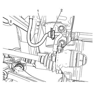

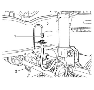

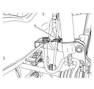

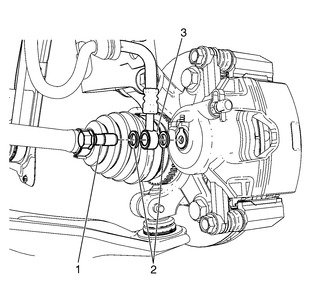

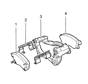

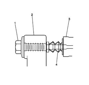

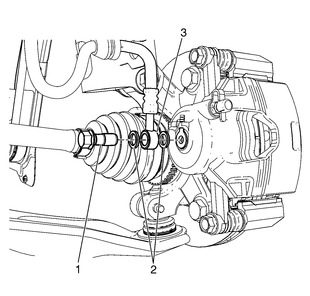

Since it is only one wheel, either the caliper piston has a problem, the hardware is preventing the pads from releasing, or the brake hose (rubber one) mounted to the brake caliper.
If you look at the first two pics, I attached the components needing to be checked. make sure everything is moving freely and not corroded or stuck.
The remaining pics are for the replacement of the brake hose. If you press the brake, it doesn't release and then does release when you open the caliper bleeder hose, replace the hose.
