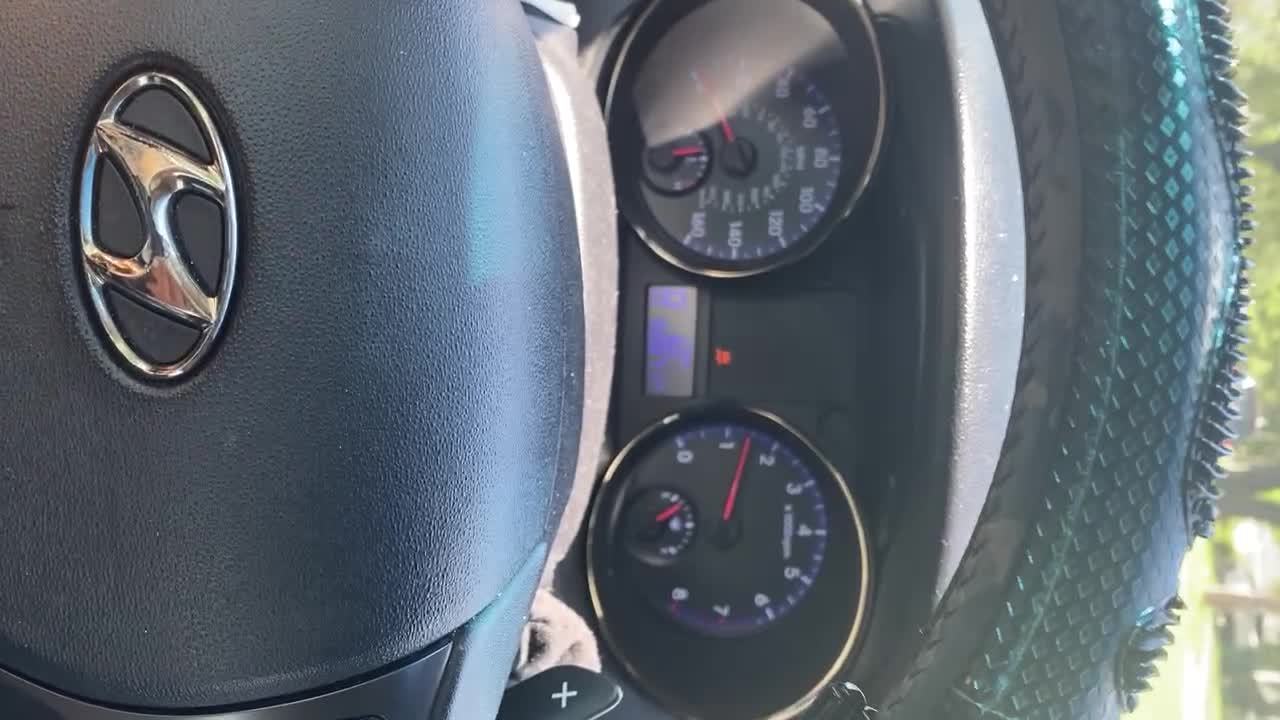

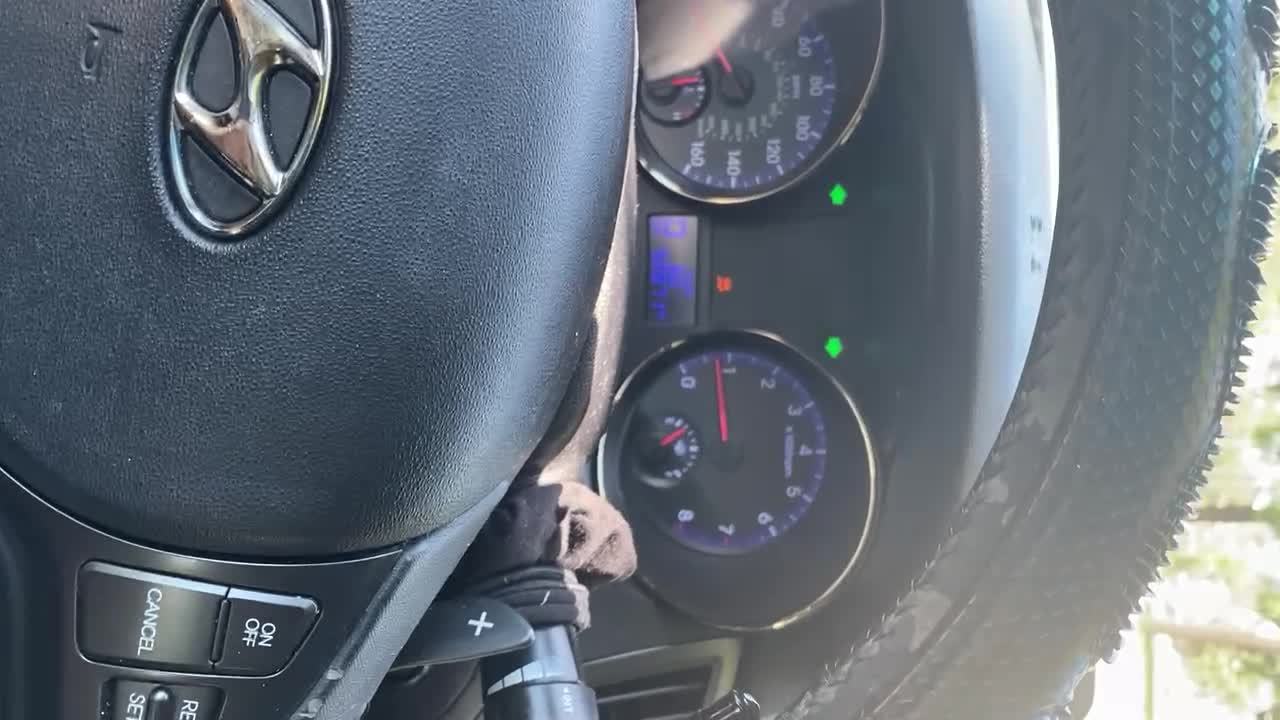

The original issue in April was that for several months prior, I was dealing with having to pump the brakes to get the car to stop. It was not something I needed to do every time I hit the brakes but it was occurring more frequently. The mechanic I saw suggested changing the master cylinder. We got the part from an auto store. He also changed the front brake pads. The car worked without any problems for about a month. Then the new issue started occurring with the acceleration acting funky and the brakes locking up. This was not a problem prior to the master cylinder being replaced. I do have some videos I can attach from May of this year when the new issue started happening. You will see in the video (hopefully the quality is okay) how the acceleration was lacking and if you turn up the volume, you can hear the engine roaring. Once this starts happening, the car eventually comes to a complete stop. If we try to push it to go by hitting the gas, the brakes eventually get very hot and start smoking.

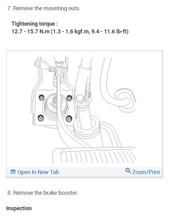

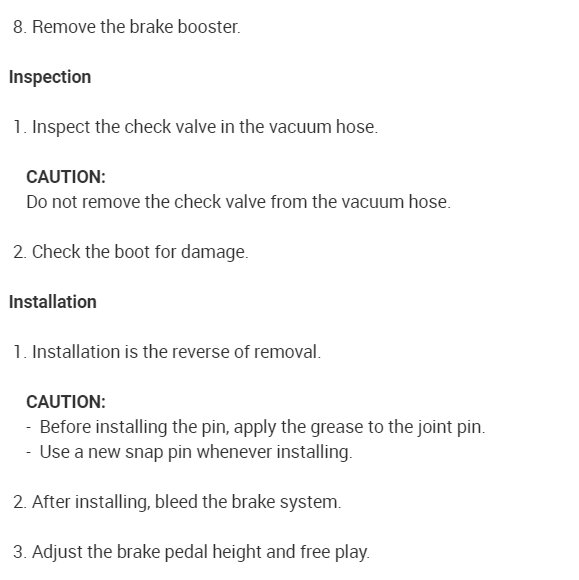

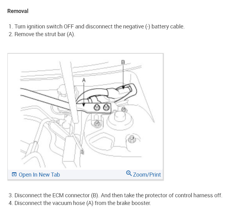

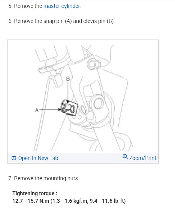

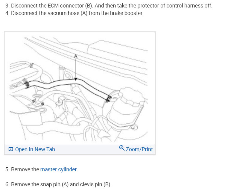

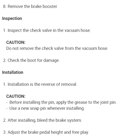

  • 55,402 POSTS
This happens when the brake booster needs to be replaced because it is not retracting fully and holding the brake on. Please go over this guide and I have include instructions on how to fix it in the images below.
https://www.2carpros.com/articles/a-comprehensive-guide-to-fixing-automotive-brakes-locking-up
