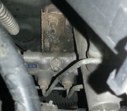

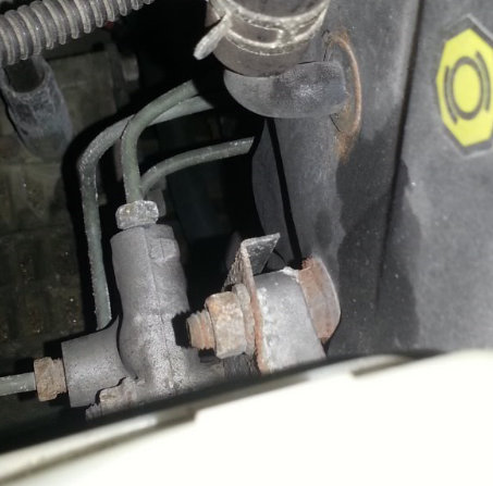

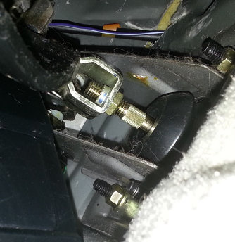

It is no longer an intermittent issue, the brakes lock every time after a few miles. I touched the front driver side lug nuts and they were sizzling hot. Front passenger side was not as hot. Back nuts temp were normal. I also noticed the brake gets so sensitive that the car stops before the brake travels far enough to activate the brake light switch. Can the pedal automatically lose adjustment after seventeen years of use? How about a warped rotor on front driver side, can it cause such locking?
I still have the original master cylinder and pedal and no one adjusted those ever. My vacuum booster also has a proportioning valve attached to it. Do I have to move the proportioning valve in order to remove the master cylinder to check the push-rod clearance (see photo)?
I tested the vacuum by pressing the brake pedal several times with the engine off and then holding the pedal down. Then I turned the engine on. The pedal goes down fine when the engine starts and creates the vacuum.
My vacuum check valve is not removable (photo).

You replaced that caliper, did you also go over the slides and make sure there is no binding. The brakes getting hot will cause the fluid to expand but I've never seen one that also made the pedal act up the way yours is. That is because of the bleed ports in the master cylinder, when you apply the brakes the pistons move and block those ports. When the pedal moves back up the ports are open and any fluid expansion should just push into the reservoir. Then there is the prop valve. It could be faulty and cause the brake to rub and heat up, but the way it's designed if it is holding the pressure the master cylinder shouldn't be effected either.
That's why I suggested the booster, if it is applying the brakes just enough that they start to heat up it could cause both problems. I would try disconnecting the booster, then see if the condition is still there. Next would be to drive it and once it locks up, use a wrench and loosen the lines at the master cylinder. They shouldn't have pressure there. If either or both has pressure in them then move to the proportioning valve.
One way to discover if the heating LH brake is causing the problem or if it's the result would be to remove the banjo bolt and replace it with a solid bolt the same size and see if the problem is still there. Just be prepared for the odd handling of only one front brake during the testing.

I haven't driven the car lately but I was able to use PB-blaster and safely unscrew the MC mounting bolt from the booster. The proportioning valve was attached to the bracket, so it moved as well. Some of suggested it could be a pushrod or pedal issue. I'll drive the car today or tomorrow and if it locks, I'll unbolt the MC and give it about 1/4 (quarter) inch slack for a minute and then bolt it back and report back to you guys.

If the calipers are OK the issue almost has to be in the proportioning valve. The pressure increase is causing the valve to block brake pressure to the rear brake, if it wasn't the rear would be hot from rubbing as well.
