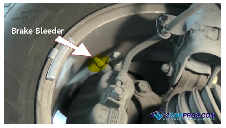

While driving (it's my mother's car and she was driving), the brakes suddenly locked up, bringing the car to stop and won't release. I tried disconnecting and reconnecting the battery and fuses to hopefully reset the electronics, but it didn't help.
This happened a few weeks ago and my mother took it to get checked out. Supposedly it's the ABS module.
What I'm looking for,
How can I confirm it is the ABS module that's bad?
If it is the ABS module, what do I need to know to fix it?

To check the ABS module would require a scan tool that can communicate with the module itself to see if it responds. However, I doubt the ABS module has caused the brakes to lock up. Are all wheels locked or is it one or two?
Do me a favor. Safely lift one wheel at a time off the ground and see if the wheels are all locked. If they aren't, there is a chance one of the brake calipers has frozen or even one of the rubber brake hoses has failed.
If you do find one of the wheels has locked and not everything, I need you to open the bleeder on the brake caliper to see if the brake releases. I attached a pic below showing what to look for. If you do open it, only leave it open long enough to check if the wheel starts to turn. Once that determination is made, close it.
Let me know what you find.
See pic below.

All wheels were locked up, which was a pain to get towed.
However, as an update and hopeful resolution, a new mechanic took an actual look at it and realized someone put engine oil in the brake fluid. Since we never touched the brake fluid, we can only guess that it was the last mechanic that actually worked on the car since they really hated us for some reason (their boss was nice enough though).

Wow! That would certainly cause it. The problem now is how the oil affected the rubber components. Anytime I've been faced with this type of issue, I end up replacing everything related to hydraulics in the brake system. Did the new guy indicate that?
Also, if you have the receipt from the last place that worked on it, I would check if they added brake fluid. If they did, I would go after them for the repairs. It can be expensive.
