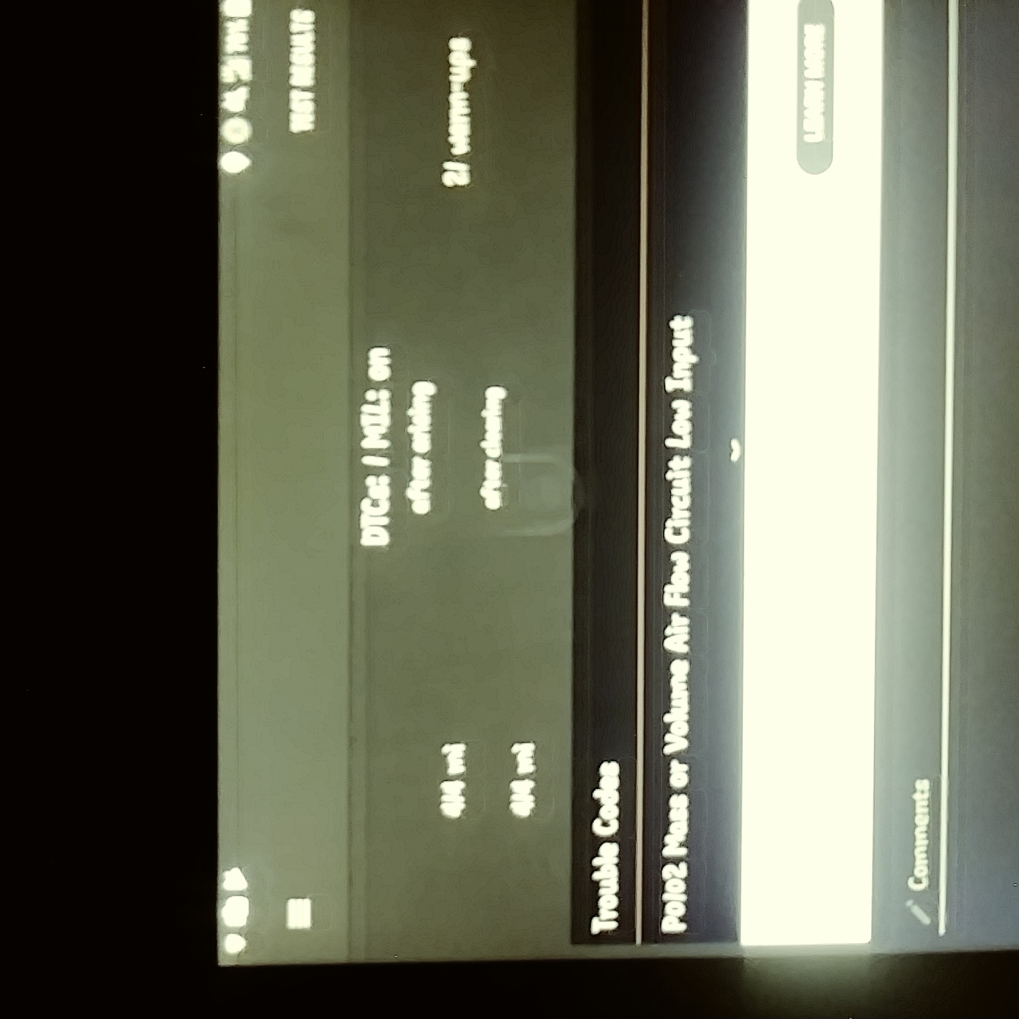

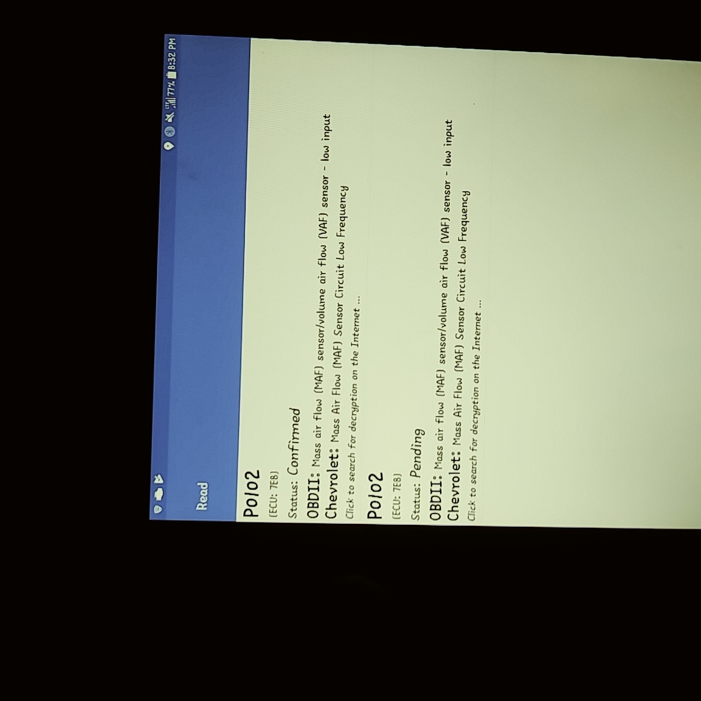

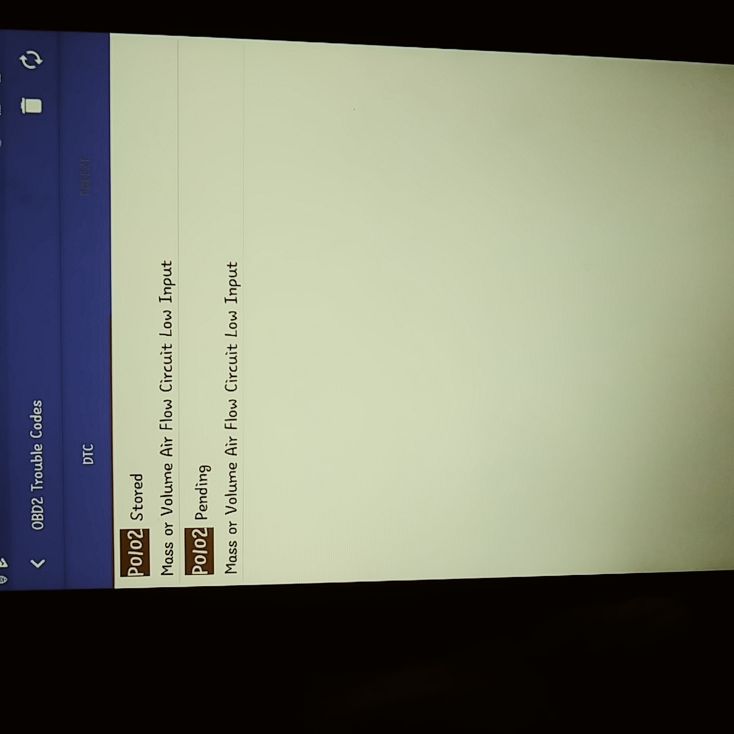

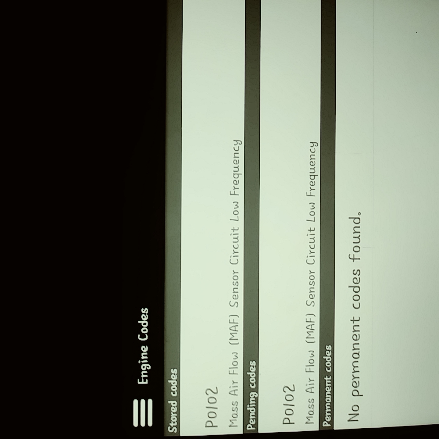

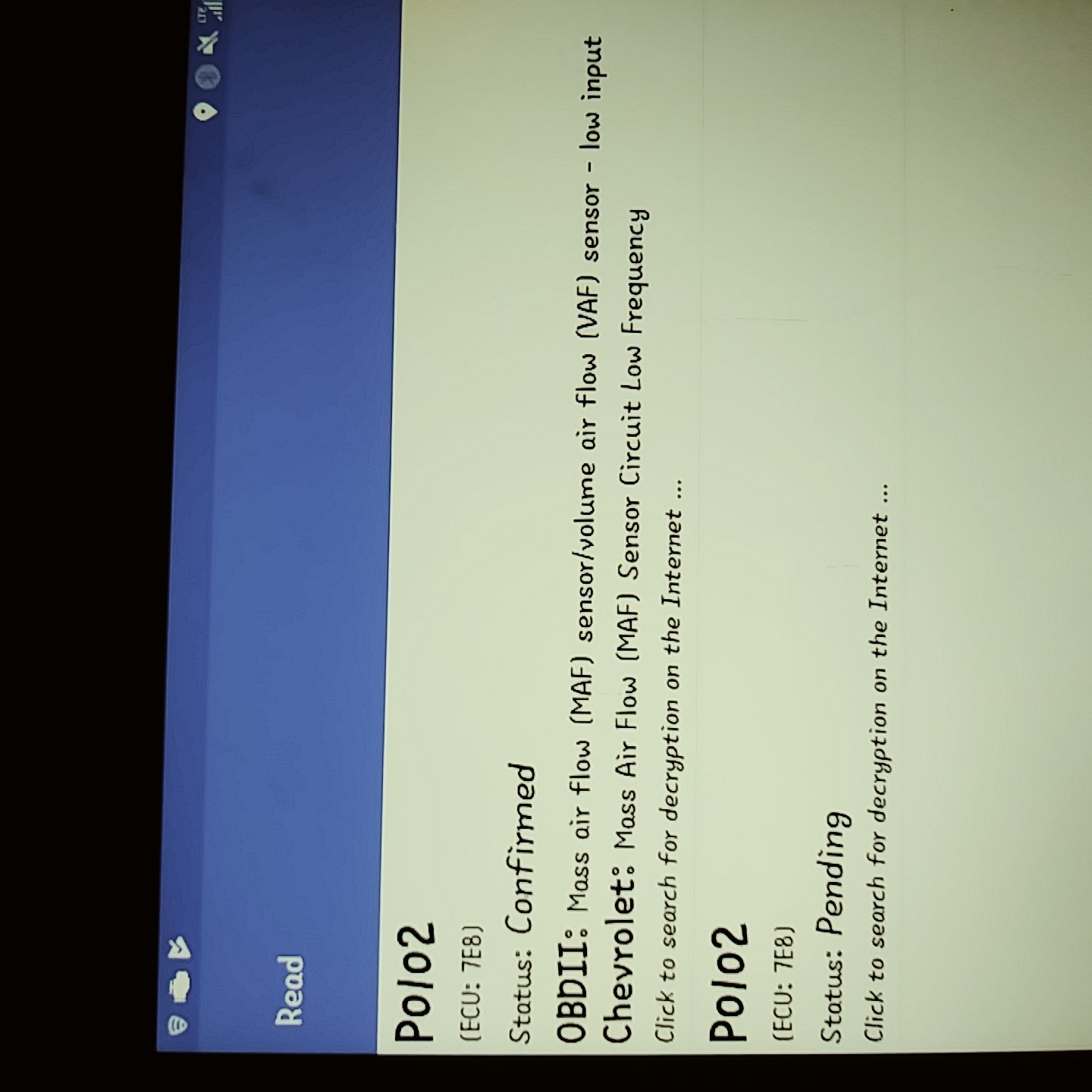

And this is why i am here. i have a Bluetooth obd2 reader and use multiple scanner software to double and triple check things. attached are 5 different readings all give only the mass air flow P0102 no ABS/brake or traction control codes. i did notice there is a electronic'y sound kind of like taking and rubbing a rubber eraser across a white board. these are from as follows (not in order) ChevoSys free, incardoc free, Car Scanner, Dashcommand, Torque Pro. I can give any information you could ask for so please ask away. i am so confounded. thanks for the help.
