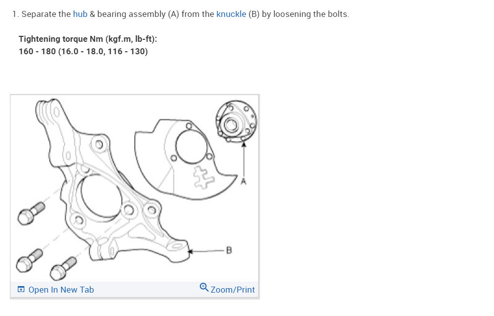

What I do for wheel bearings is identify if its front or rear first. But most of the time, we will put the vehicle up on a lift at the shop and have someone sitting in the car and running the wheels while another technician listens to each wheel, sometimes with a stethoscope. Because of road noises you won't always be able to identify which one it is by just driving. Did you find any brake pads that were worn down to the point of metal-to-metal contact and were grinding? I am putting a diagram of the bearing and hub below; another possibility is a bearing in the transmission. You can try having someone else drive and sit in the back seat, to see if you can identify which wheel it is that way.

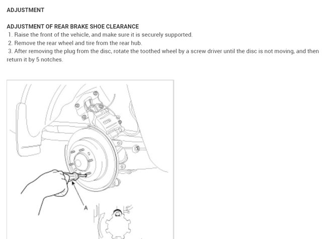

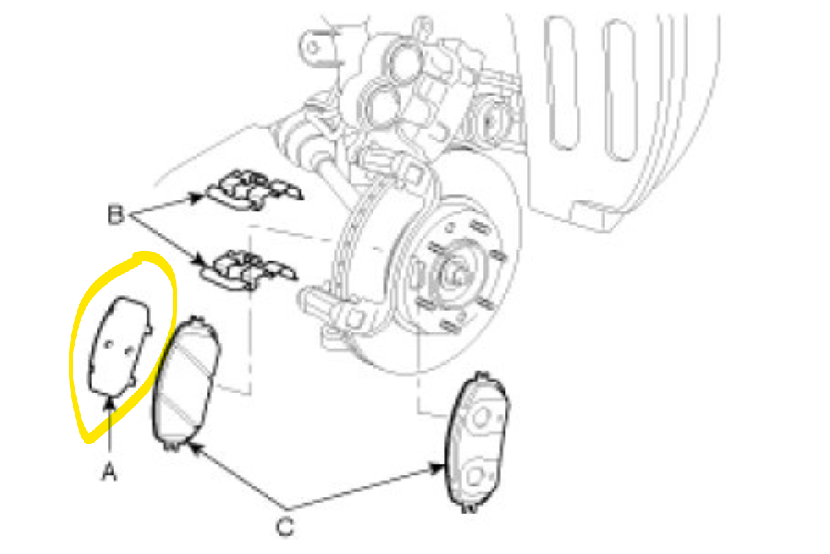

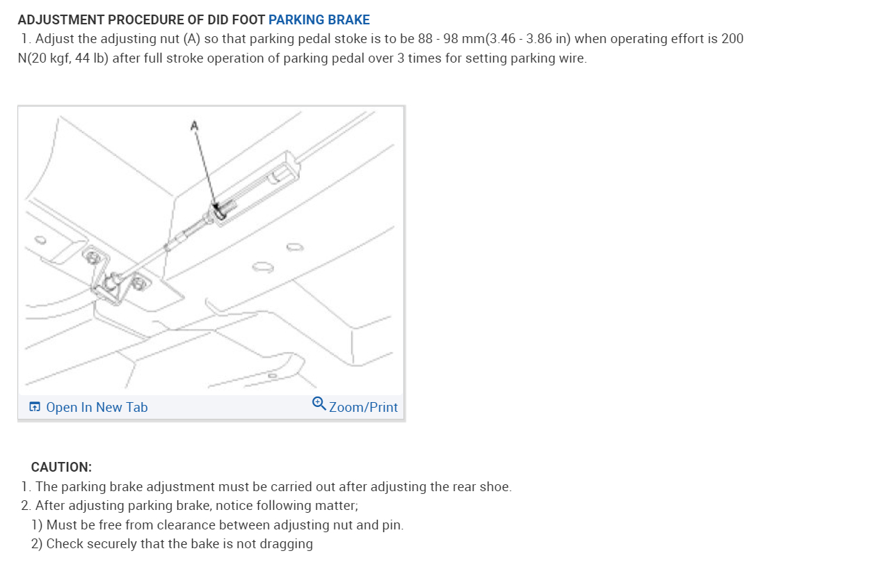

Okay, if you're hearing a noise in the front and everything is new, some possibilities, the pad shims that come with the kit can make a lot of noise, usually squealing type noise if there is no brake quiet put on them. But it's not a grinding noise. It could be the rear pads; I would inspect them next. The parking brake could be hanging up and it's causing the rear shoes inside the rotor to grind. The parking brake on these is inside the rear brake rotor assembly.
If you jack up the rear of the vehicle, see if you can turn the rear wheels by hand. Just be sure to put some blocks in front of the front tires so it doesn't roll on you.

It can be a wheel bearing that's just starting to go bad. Usually, they will make noise all the time, but again it really depends on where the noise is coming from.
