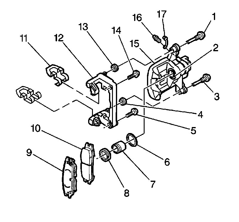

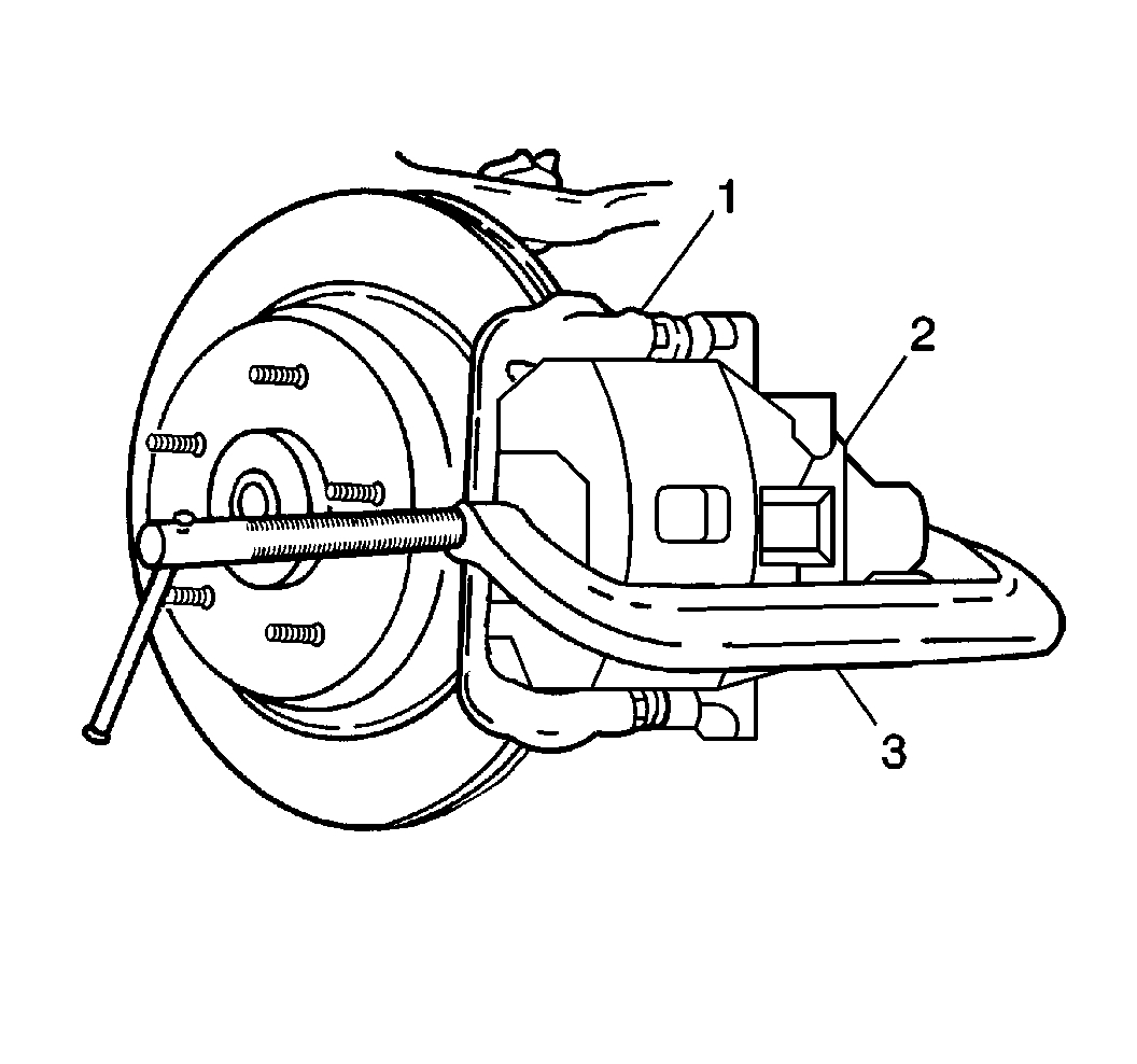

brakes are making a grinding noise then could this be rotor?
2007 BUICK RENDEZVOUS
133,000 MILES • 6 CYL • FWD • AUTOMATIC
PHARRIS65
When braking the brakes are making a grinding noise then could this be rotor or steering related? I think I need rear brakes.
Oct 14, 2017 at 4:11 AM
  • 110,194 POSTS
Replacing rear brake pads and rotors really isn't too hard. Plus, if you do it yourself, purchase lifetime parts so you never have to pay for them again.
You can expect rear brakes to last around 30,000 miles, but that changes based on terrain and driving habits.
To get started, here is a link that explains in general how it's done. Use this as a guide.
https://www.2carpros.com/articles/how-to-replace-rear-brake-pads-and-rotors
Here are the directions specific to your vehicle. The attached pics below correlate with these directions.

6. Compress the rear caliper piston.
1. Install a large C-clamp (3) over the top of the caliper housing (2) and against the back of the outboard pad.
2. Slowly tighten the C-clamp (3) until the piston pushes into the caliper bore enough to slide the caliper (2) off the rotor.
3. Remove the C-clamp from the caliper.

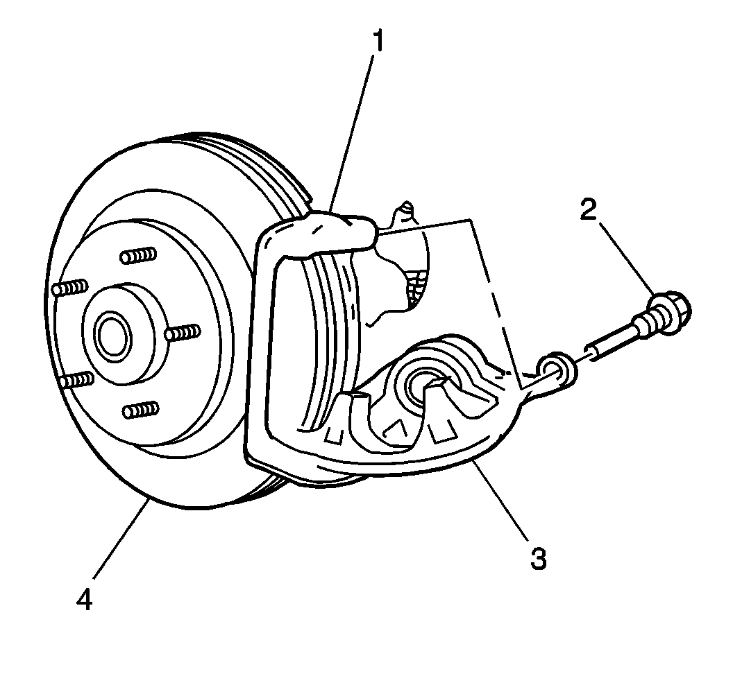

7. Remove the upper caliper bolt (2).
Notice: Use care to avoid damaging pin boot when rotating caliper.
8. In order to access the pads, rotate the caliper downward.
9. Remove the pads (9, 10) from the caliper bracket (12).
10. Remove the two retainer slides (11) from the caliper bracket (12).

1. Using a C-clamp, bottom the piston into the caliper bore. Use an old brake pad or wooden block across the face of the piston. Do not damage the piston or the caliper boot.
2. Install the two retainer slides (11) to the caliper bracket.
Important: The wear sensor is on the outside pad. The sensor is positioned at the trailing or downward edge of the pad during forward wheel rotation.
3. Install the pads (9, 10) to the caliper bracket (12).
4. Remove the support and reposition the caliper (15) back down over the front pads.
5. Lubricate the bolt and the bolt boot.
Notice: Refer to Fastener Notice.
6. Install the upper caliper bolt.
Tighten the caliper bolt to 45 N.m (33 lb ft).

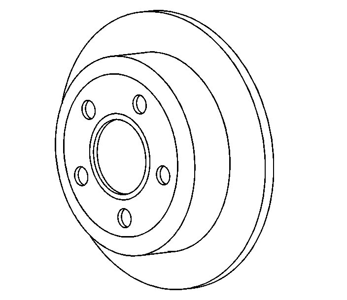

Rotor Replacement

Notice: Support the brake caliper with heavy mechanic's wire, or equivalent, whenever it is separated from its mount and the hydraulic flexible brake hose is still connected. Failure to support the caliper in this manner will cause the flexible brake hose to bear the weight of the caliper, which may cause damage to the brake hose and in turn may cause a brake fluid leak.
3. Remove and support the caliper and bracket as an assembly with heavy mechanics wire. DO NOT disconnect the hydraulic flexible brake hose.
4. Remove the brake rotor.
Important: When a brake rotor has been separated from a hub/axle flange, the mating surface of the brake rotor must be cleaned of any rust or contaminants. Failure to do this may result in lateral runout of the brake rotor, and brake pulsation.
5. If the brake rotor is to be reinstalled to the vehicle, use the J 41013 in order to clean any rust or corrosion from the hub/axle flange mating surface of the brake rotor.
6. Use the J 42450-A in order to clean the wheel hub flange.
