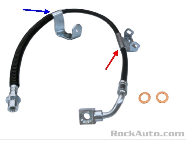

My husband just bought a used truck less than 2 1/2 months ago, and has not been able to drive it, as his front brakes keep locking up to the point of catching fire. He has replaced the brakes and calipers twice, the wheel bearings and both wheel hubs, and all brake lines and a new booster, but they still lock up on him. He has pretty much replaced everything we could think of, and the mechanics can't seem to find what is causing it. There are no warning or brake lights going off. The only thing that hasn't been replaced is the sensors, which we were told had nothing to do the actual brakes themselves. He needs his truck for work, and is reduced to driving my Jeep leaving me without a vehicle. What haven't we checked or replaced? And is there anything else we can do to fix this problem? We would appreciate any help!

There's a couple of common things to start with. The first is the front rubber flex hoses, but the clue there is it almost always affects just one front brake, not both. The clue to finding this is when the locking is occurring, loosen the soft metal line nuts at the master cylinder to let the trapped brake fluid release. If that doesn't work, that's good news. Next, crawl underneath and open the bleeder screws on the calipers. That will let them release, but we still have to figure out where the pressurized brake fluid is being trapped.

I get the impression you think I said to do something at the master cylinder, then drive it that way. That is not correct. Once the brakes are locking up, stop on a slight incline, shift to "neutral", place a block about a foot down-hill of one tire, then open the front hydraulic system at various places to see where the brake fluid is being trapped under pressure. The easiest and fastest place to do this is right at the master cylinder. Loosen the two steel lines just enough to let brake fluid spurt out. If the brakes release, the truck will coast down to the block by the tire. That block is supposed to prevent you from looking funny as you chase after the truck! Another alternative is simply to have a helper sitting in the driver's seat who can stop the truck from running away.
If doing that does not let the brakes release, the next easiest place is the ABS hydraulic controller assembly, when there is one. Follow the steel line back from the left front caliper to that assembly and loosen that line there. It's harder to figure out which line is for the right front. Just loosen all the line nuts a little to see if the brakes release. It's best to loosen a line, then retighten it right away. That lowers the chance of air sneaking in.
The most tedious is to loosen the bleeder screws at the front calipers. If only one front wheel is getting hot, that's the one to open the bleeder screw on. This is where roughly half of locking brakes will release, and a real common cause is a restricted rubber flex hose. This has happened to me multiple times on my older Dodge Caravans, especially after I let them sit over the winter. The fix on those is very easy. If you look at the photo below of your front brake hose, the arrows are pointing to two metal brackets crimped around the hose. This is the first time I've seen two of them on one hose, so you have twice the chance of this happening. Rust builds up inside those crimps, constricting the hose. You can easily force brake fluid through that restriction with normal pedal pressure, but the fluid won't release freely. It keeps that brake applied, then heat is generated. That heat migrates into the brake fluid causing it to expand and apply that brake even harder. When this gets bad enough, that wheel will cause a harsh thumping felt in the steering wheel, and that wheel will get very hot. With a hose constricted like this, the only place you can release the trapped pressurized brake fluid is at the bleeder screw on the caliper.

Back to those hoses, when they became constricted on my vehicles, I found all that was needed was to open up those crimps a little with a large flat-blade screwdriver, or a large pair of pliers. There was no need to remove a wheel, but I did have to lay on the ground to do that. Your metal brackets look rather beefy, so I don't know if bending them to open them up will be possible.
Don't go replacing a pile of random parts. That is the least effective and most costly way to solve this. Instead, just tell me where something in the hydraulic lines can be opened to let the brakes release.
