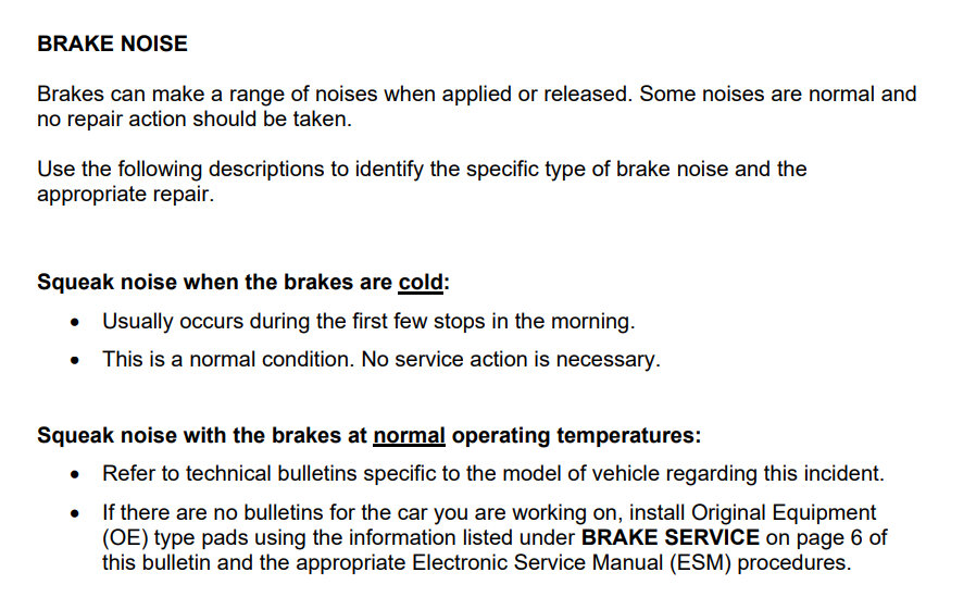

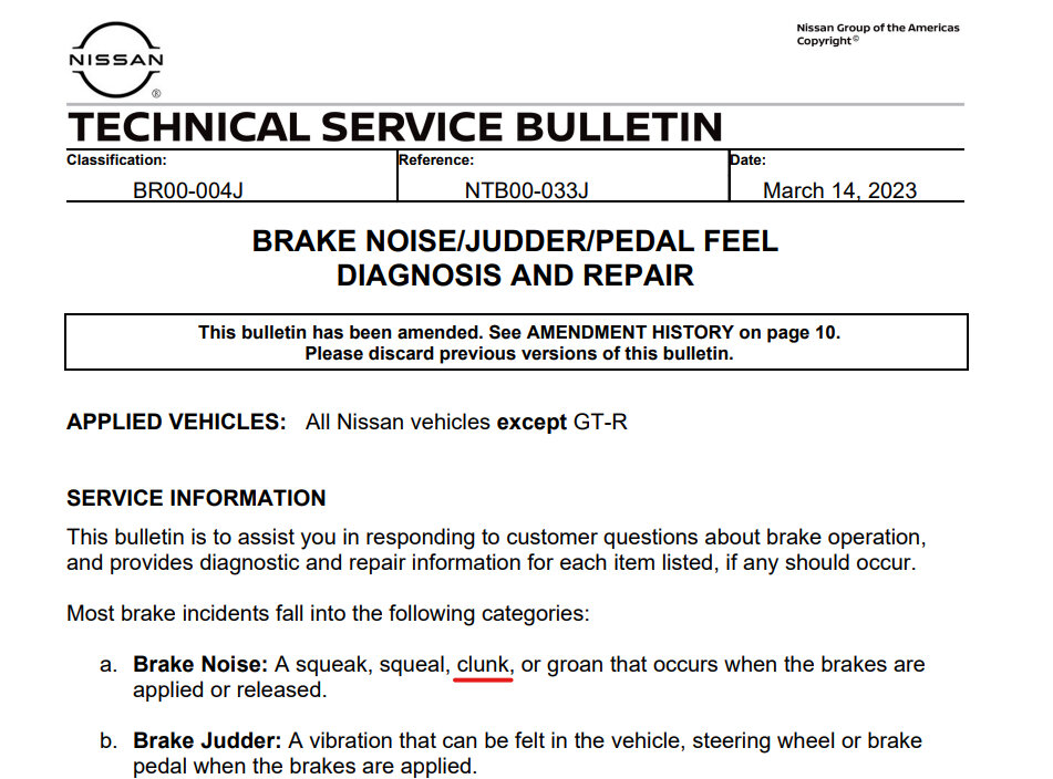

The brakes are not supposed to make noise, period. Can you please shoot a quick video with your phone so I can hear the noise? That way I can tell for sure what's going on. You can upload it here with your response. There is a TSB that addresses this issue which basically says to redo the brake and to make sure the pad anti rattle clips are in place, but I have seen a loose brake caliper cause this issue as well. Check out the images (below). Please let us know what happens.
