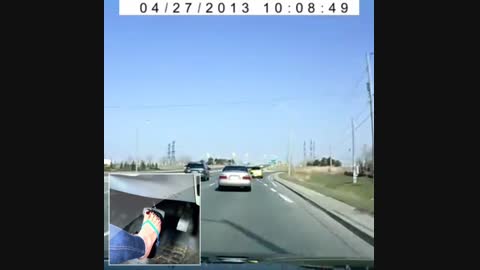

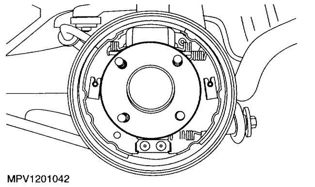

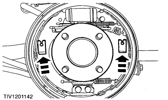

Hi, I don't know what happened to my brakes but I have to play around with them for the car to slow down. Please watch the video for more understanding.

It's hard to tell what is actually happening. Is the brake pedal hard to push? Do you have to pump them to make them work? Is the brake pedal going excessive low?
Take a look through these links and let me know if anything in them mirrors what you are experiencing.
https://www.2carpros.com/articles/brake-pedal-goes-to-the-floor
https://www.2carpros.com/articles/car-pulls-right-or-left-when-driving-or-braking
Now, also let me know if it feels as if the anti-lock brake system (ABS) seems to actuate.
I will watch for your reply.
Feb 12, 2019 at 5:52 PM
IRINABYRNE
  • 6 POSTS
I have to pump them to make them work.
Feb 13, 2019 at 2:06 AM
  • 110,194 POSTS
Welcome back:

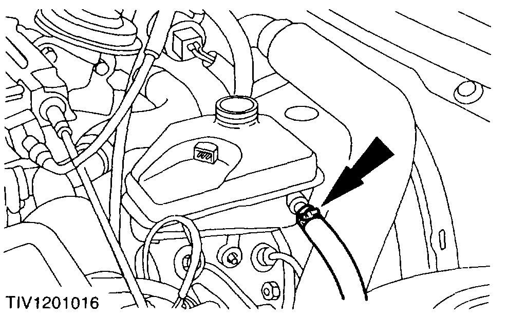

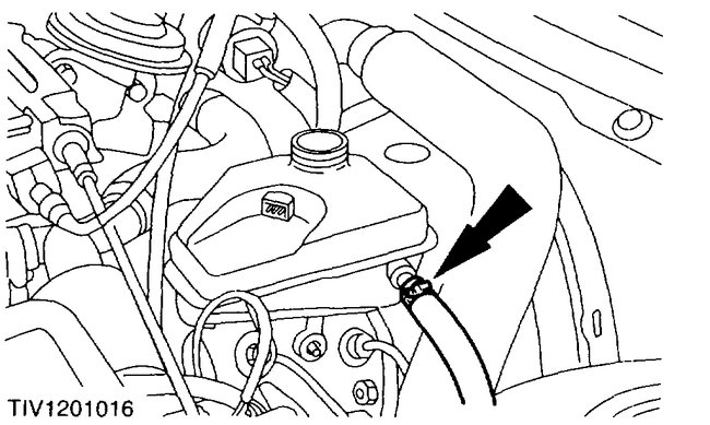

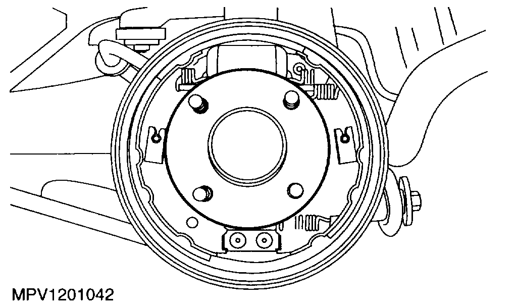

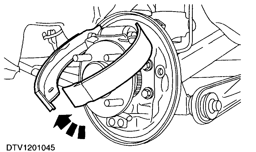

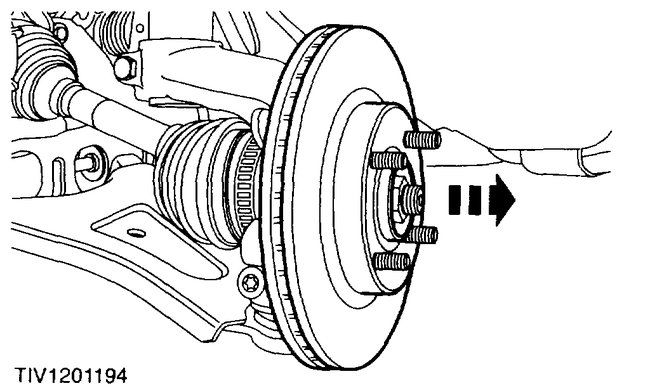

First, check the brake fluid level and make sure it isn't low. Next, I want you to try a test. Put pressure on the brake pedal and hold it. Does the pedal slowly go to the floor? Last, do you have rear drum or disc brakes? If they are disc, when you look through the wheel, you will see a brake rotor that looks the same as the front. If they are drum brakes, you will see a drum and it will look different than that front.
I attached a picture of the master cylinder picture 1. It is under the hood mounted on the driver's side firewall. I also attached pictures of what a brake rotor looks like (disc brakes) and what a brake drum looks like (drum brakes). You can use them what checking the rear brakes for me. Picture 2 is the rotor and 3 is the drum.
I need to know about the rear brake design because drum brakes are adjustable and disc are not.
Let me know,
Feb 13, 2019 at 7:09 PM
IRINABYRNE
  • 6 POSTS
Brake pedal does not go to the floor. It is drum brakes.
Feb 15, 2019 at 7:34 PM
  • 110,194 POSTS
Welcome back:

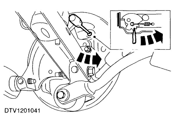

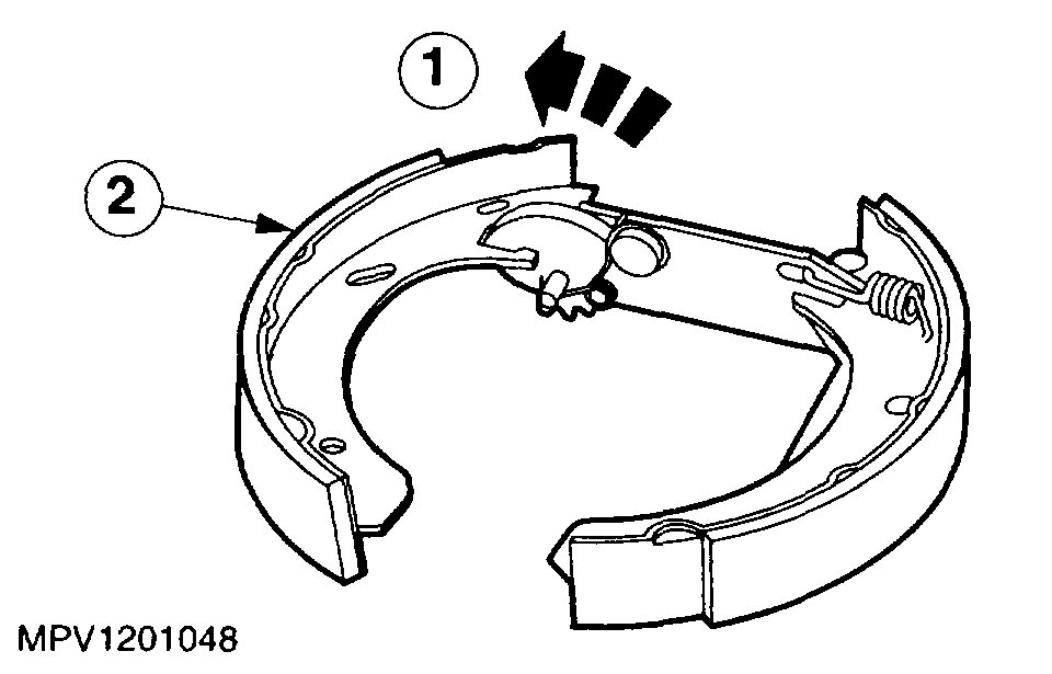

Okay, then it's not the master cylinder. With that in mind, the first thing I would try is to adjust the rear brake shoes. Also, the rear brakes may be worn or need replaced. What happens is the self adjusters never seem to work like they should. As a result, the space between the brake shoe and drum becomes excessive as the brakes wear. Then, you have to pump the brakes to cause the shoes to reach and work.
___________________________________________________
I am going to provide the directions for replacing the the rear brakes because I have a feeling that is what may need done.
Here is a link that shows how rear brake shoes are replaced in general. It will help guide you through the process.
https://www.2carpros.com/articles/how-to-replace-rear-brake-shoes-and-drums
These directions are specific to your vehicle and also include adjustment. The attached pictures correlate with these directions.

PROCEDURES

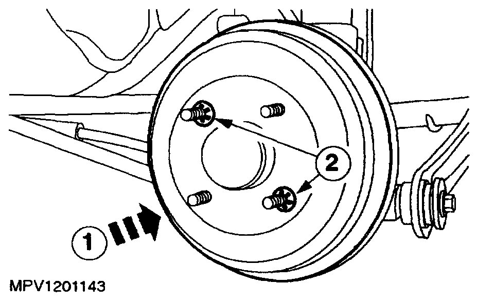

Removal
1. Loosen the wheel nuts.
2. Raise and support the vehicle.
3. Remove the wheel.

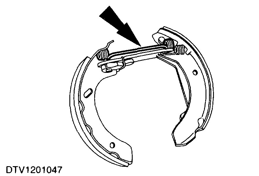

picture 1

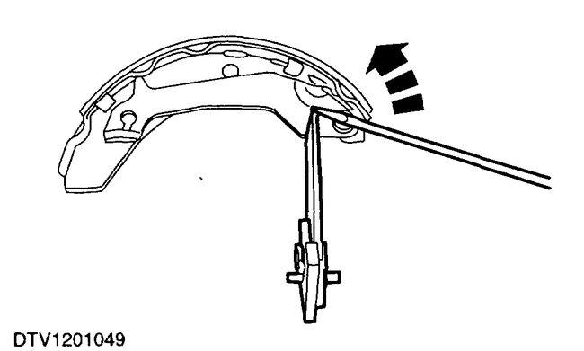

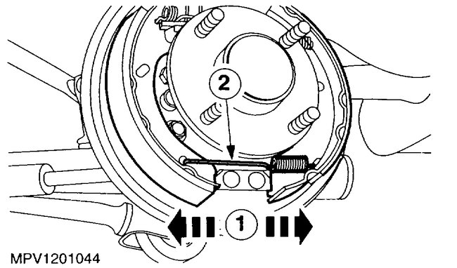

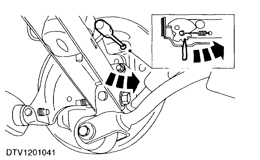

4. Release the brake shoe automatic adjuster.
picture 2

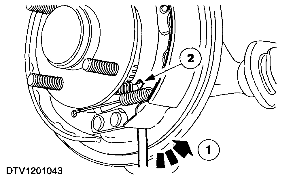

5. Remove the brake drum.
1 Remove the retainers (if equipped).
2 Remove the drum.

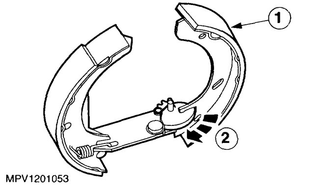

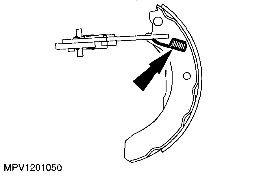

picture 3

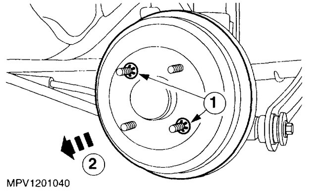

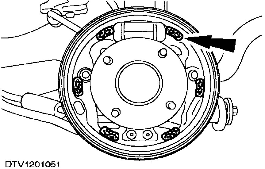

6. Make sure that the hub flange is in the correct position as shown.

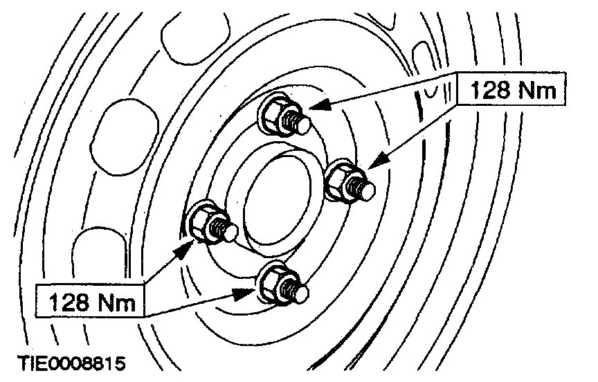

picture 4

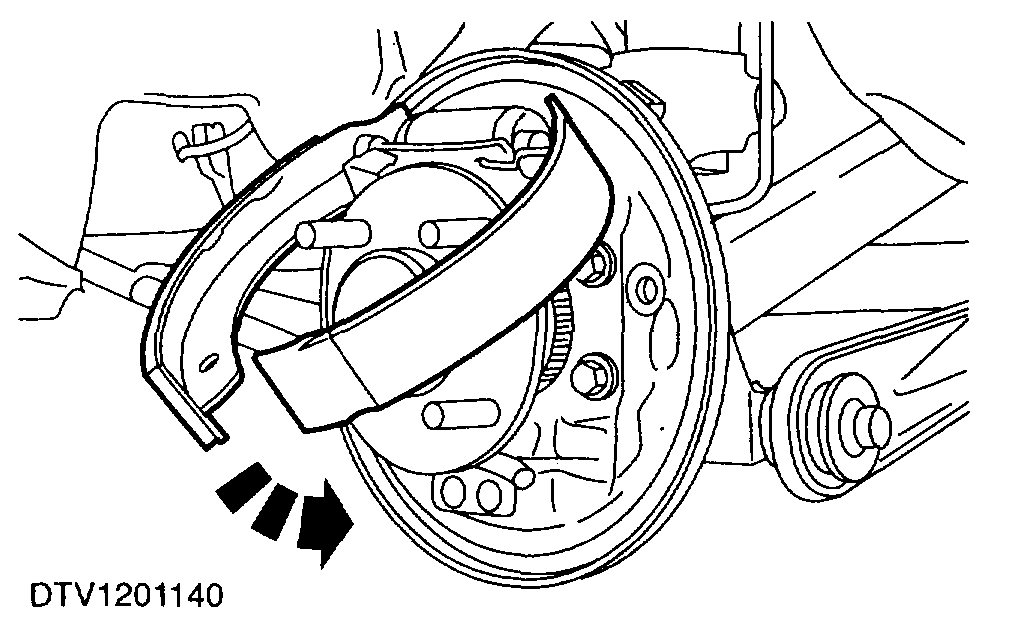

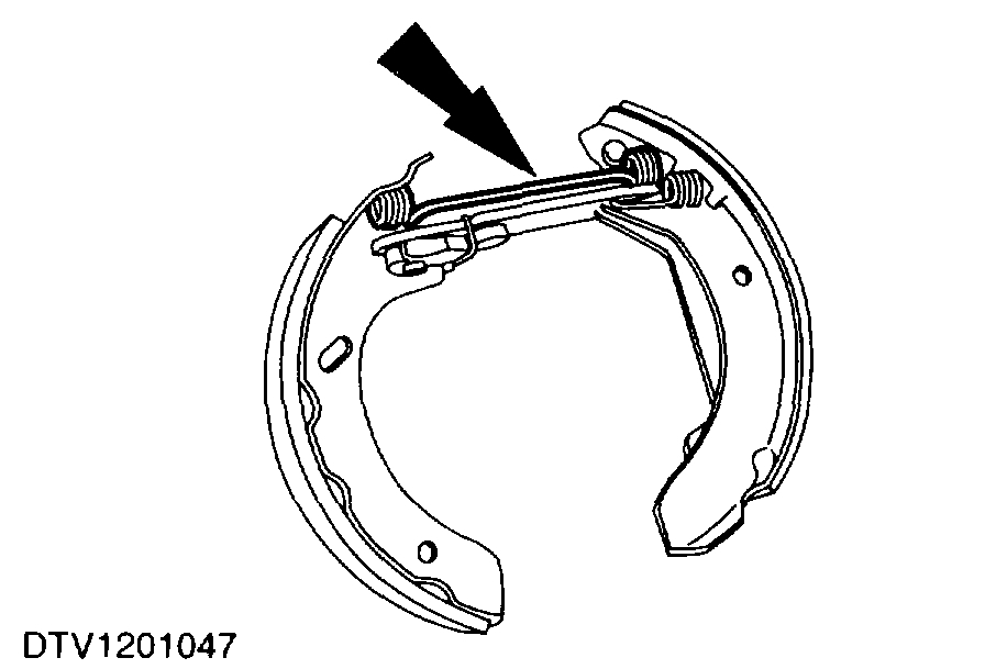

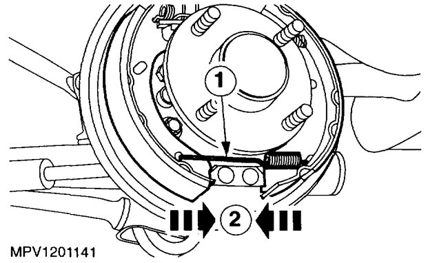

7. Remove the hold down springs.

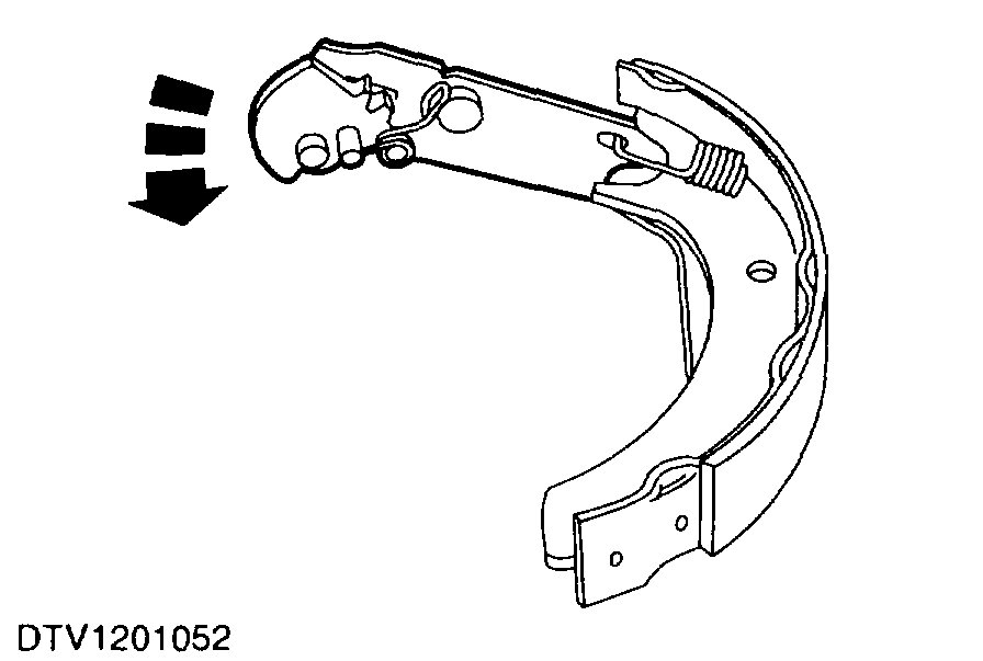

picture 5

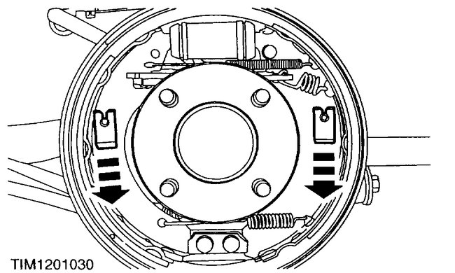

8. Disconnect the parking brake cable.
1 Lever the secondary shoe outwards.
2 Disconnect the cable from the secondary shoe.
picture 6

13. Operate the brake pedal to achieve automatic adjustment.
Let me know if this helps or if you have other questions. Please remember, I am basing this on the pedal not reaching the floor and the brake is full and not leaking.
