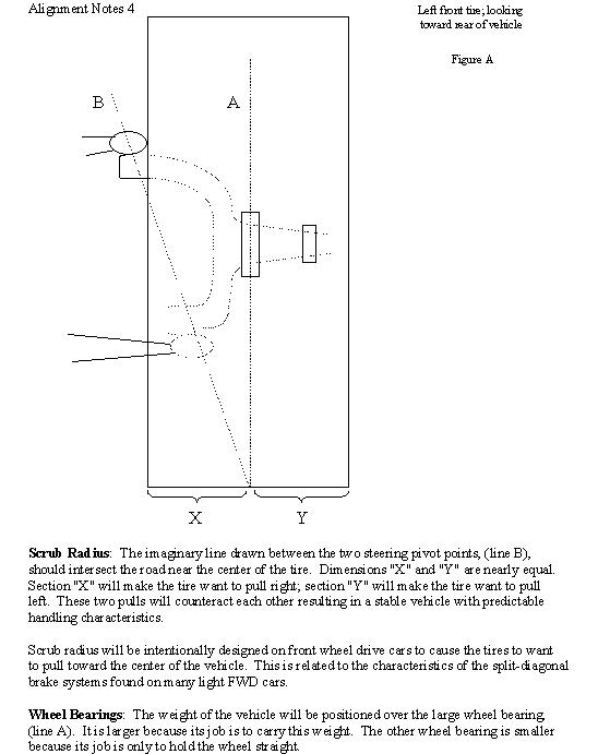

Sorry for the delay. I have two comments of value from the most resent replies. First, a spacer behind the master cylinder is a clue but not a solution. Adjustment of the brake light switch should be the next thing to check. If that is holding the brake pedal from fully releasing, you should be able to stop the brakes from dragging by pulling the brake pedal up with your toes.
Second, the common symptom when the valve in the master cylinder is tripped is the pads on one front brake will wear out to the point of grinding metal on metal way too quickly, while those on the other side will look like brand new. People have been known to put on three and four sets of replacement pads without finding the cause of the rapid wear. Part of the problem stems from how differently cars acted in the '70s and '80s. With old, heavy, rear-wheel-drive cars, if one front brake was intentionally disabled, applying the brakes would tear the steering wheel out of your hand if you weren't prepared for the surprise. A small driver would not be able to hold the steering wheel straight. Brake systems were split into the front and the rear systems, so unintentional disabling of one system due to a leak had no effect on steering since both brakes on that axle were disabled together.
When front-wheel-drive cars showed up, around 80 percent of the vehicle's weight was on the front wheels. With a leak in the front and only the rear brakes working, the rear brakes would lock up and the car would keep going until they found you in the next county. To address that weak braking, they went to the split-diagonal system that everyone uses today. With a failure in one system, you'll still have 50 percent braking power. Now we're back to having just one front brake and the opposite rear one when a leak develops in one system. The reason the steering wheel doesn't get torn out of your hands is they designed in a small change to the geometric relationship of the suspension system. That's "scrub radius". The drawing below is a copy of what I handed out for class notes. While road forces pull the tire back when braking, section "X" is larger than section "Y", so that makes the tire want to pull to the right during braking. The two pulls offset each other and you get nice straight, controlled braking with just one working front brake. This is where you get the false impression the brakes are fine. Chrysler had this so well tuned that there was no way to notice there was a problem except for the red "Brake" warning light on the dash. For some other manufacturers, the only telltale clue is a very subtle wiggle in the steering wheel when first applying the brakes.
My magnificent drawing shows the older, heavier "short / long arm" suspension system with an upper and a lower ball joint as the steering pivots. On your model, those pivots are the lower ball joint and the upper strut mount, but the reaction is the same with either design.
Quick ways to verify the valve in the master cylinder is tripped is to run the engine, in gear, with both front tires off the ground. Accelerate just a little, then apply the brakes. One wheel will keep rotating. Another way is to skid to a stop on sand or gravel. All ABS systems become deactivated below 9 mph, so you should see the skid mark of one front tire, but not the other one. If you have the wheels off, the preferred method is to open the bleeder screws on both front calipers, then watch for brake fluid flow when a helper pushes the brake pedal. You won't get any fluid from one caliper when that valve is tripped.
To reset that valve is uncommonly easy, but you need compressed air and a rubber-tipped nozzle. Loosen the cover on the brake fluid reservoir. Close the bleeder screw on the working caliper. Open only the bleeder on the non-working front caliper. With the air nozzle, give a very quick, short burst of air into the bleeder screw. There's no need to push air all the way up to the master cylinder; in fact, you want to avoid that. I do a quick karate chop on the nozzle's handle. At that point, let the system gravity-bleed on its own. Brake fluid will begin flowing within less than half a minute unless there's a lot of air in the line from previous service.
Another way this problem can be caused is by doing a normal front brake job. The pistons have to be pushed back into the caliper housings to make room for the new, thicker pads. The last step of the service is to pump the brake pedal to run those pistons back out to adjust them. I already mentioned the damage that can be done by pushing the brake pedal to the floor, but in addition, on GM vehicles, that can trip the valve in the master cylinder. Due to differences in friction, one piston will move out first, then that system will start to build pressure. That pressure hasn't had a chance to build yet in the other system, so that imbalance makes the valve trip. You'll have a high, solid brake pedal with no indication of the problem just caused. To avoid both of these potential problems, never push the brake pedal over halfway to the floor, and push it slowly. My experience has been the pedal must be pushed over three quarters to the floor for the valve to trip.
