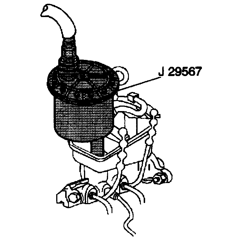

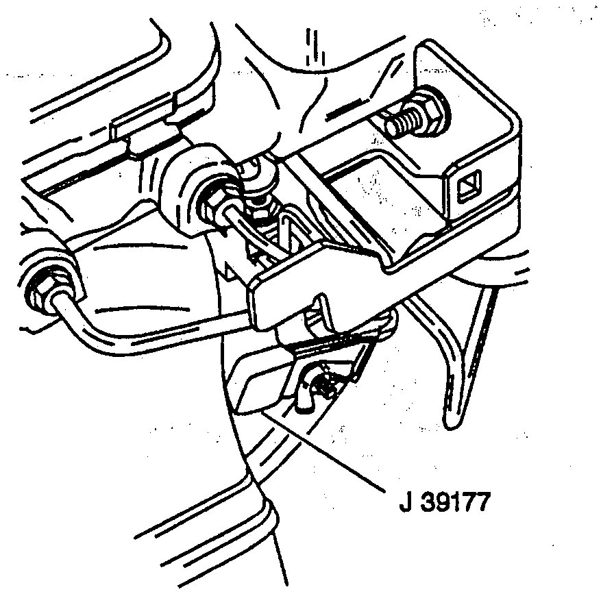

Pressure Bleeding - The two attached pics correlate with these directions.
PRESSURE BLEEDING

A Diaphragm-Type Pressure Bleeder - must be used. It must have a rubber diaphragm between the air supply and brake fluid to prevent air, moisture, oil, and other contaminants from entering the hydraulic system.
NOTE: Brake fluid will damage electrical connections and painted surfaces. Use shop cloths, suitable containers, and fender covers to prevent brake fluid from, contacting these areas. Always re-seal and wipe off brake fluid containers to prevent spills.
Tools Required:
^ J 29567 Brake Bleeder Adapter
^ J 39177 Combination Valve Pressure Bleeding Tool
^ J 28434 Wheel Cylinder Bleeder Wrench
1. Fill the pressure tank at least 2/3 full of brake fluid.
^ The bleeder must be bled each time fluid is added.
2. Charge the bleeder to 140-170 kPa (20-25 psi).
3. Use J 39177 to depress and hold the valve stem on the combination valve.
4. Install the bleeder adapter.

7. Connect the hose from the bleeder to the adapter at the master cylinder.
8. Open the tank valve.
