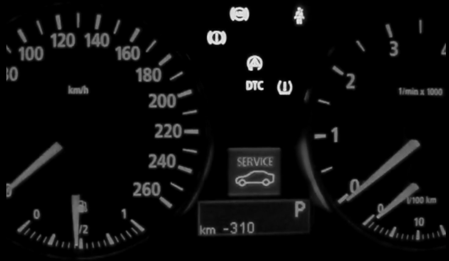

When a Service Maintenance is required, a Service Maintenance icon will appear shortly after the ignition has been switched on.
Resetting the Service Items

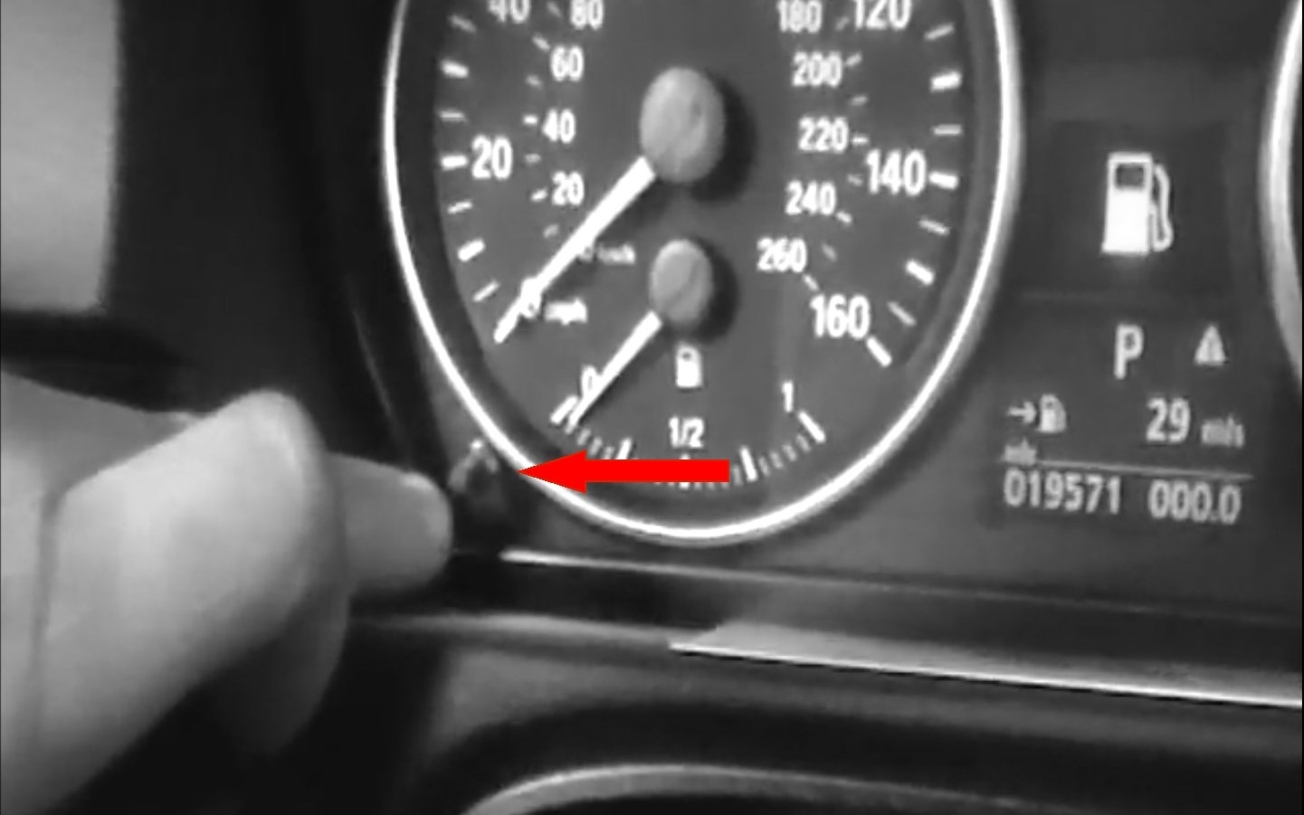

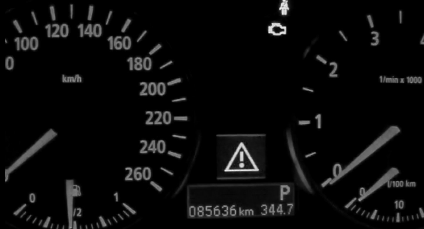

Press and hold brake pedal. Press the trip odometer button (located just below speedometer on left side of instrument cluster) (-red arrow- ) until you briefly see the warning triangle appear in the display between the speedometer and tachometer. Continue to hold the trip odometer button until a service symbol appears. When a service symbol appears, immediately release the trip odometer button.
WARNING!!!
Holding the trip odometer button for longer than 10 seconds will result with a sequence of CAN BUS information and the procedure will need to be restarted.
Note: Please restart the procedure beginning at Step 1 , if information other than service items appears while holding the trip odometer button for longer than 10 seconds.

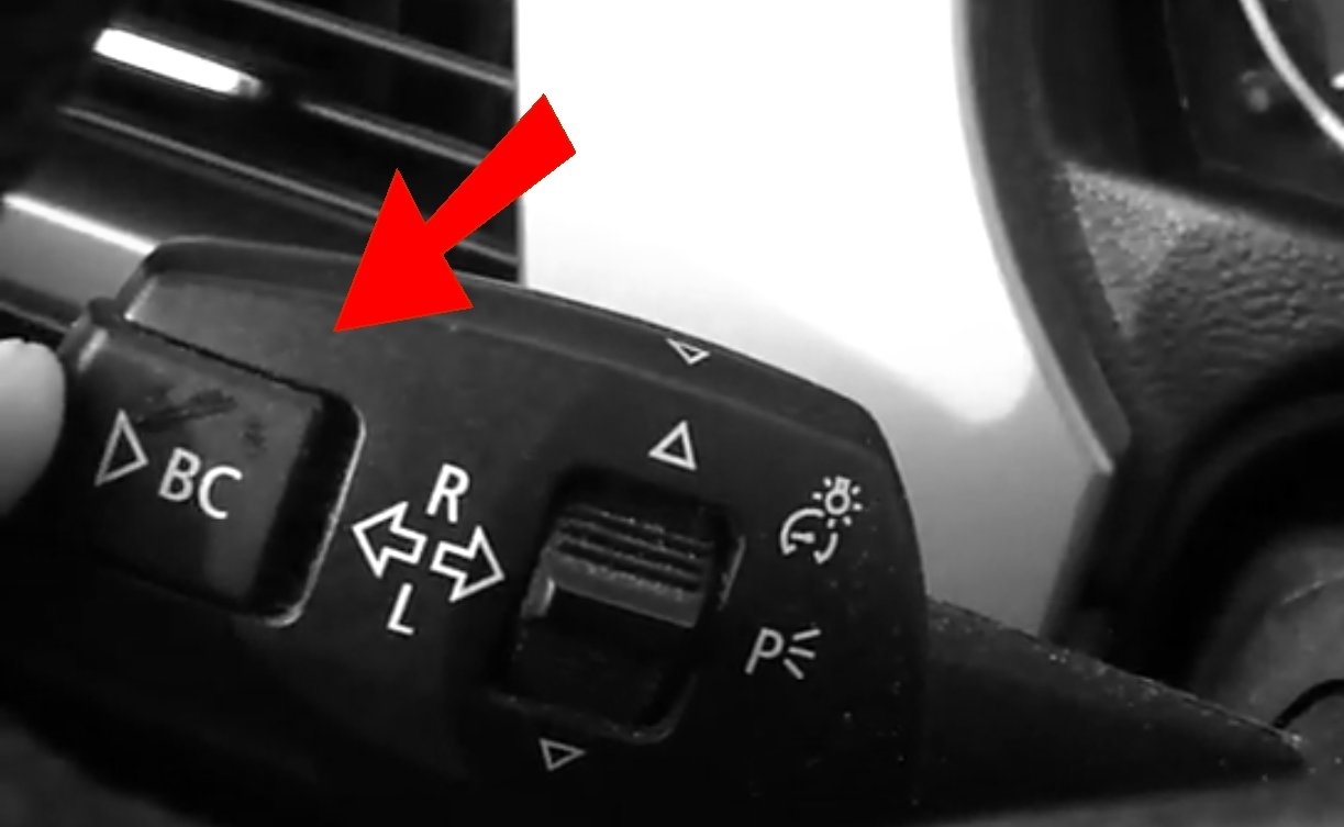

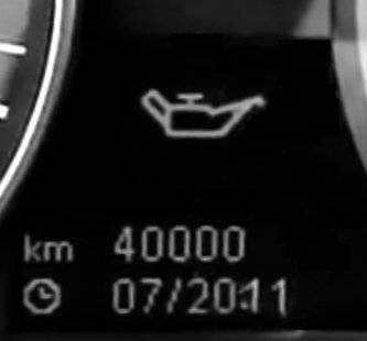

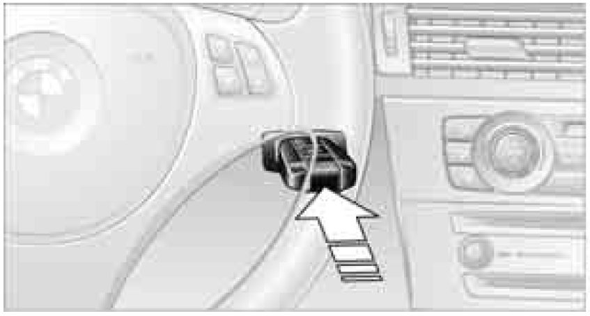

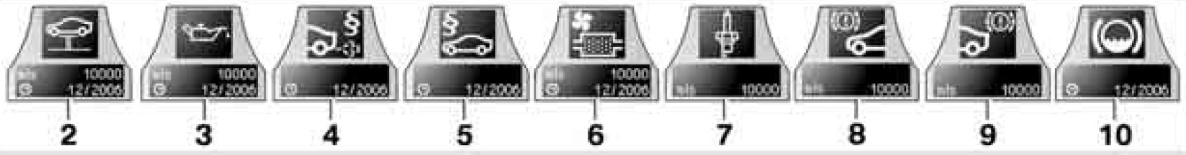

After releasing the trip odometer button, the service mode screen will appear. Use the toggle/scroll switch (-arrow 1- ) located on the Turn Signal Lever to display the desired Service Symbol/Item to be reset.
Note: CBS items are arranged chronologically according to remaining distance or remaining time. The most critical item is generally displayed first.

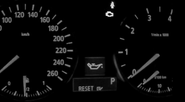

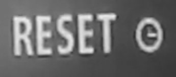

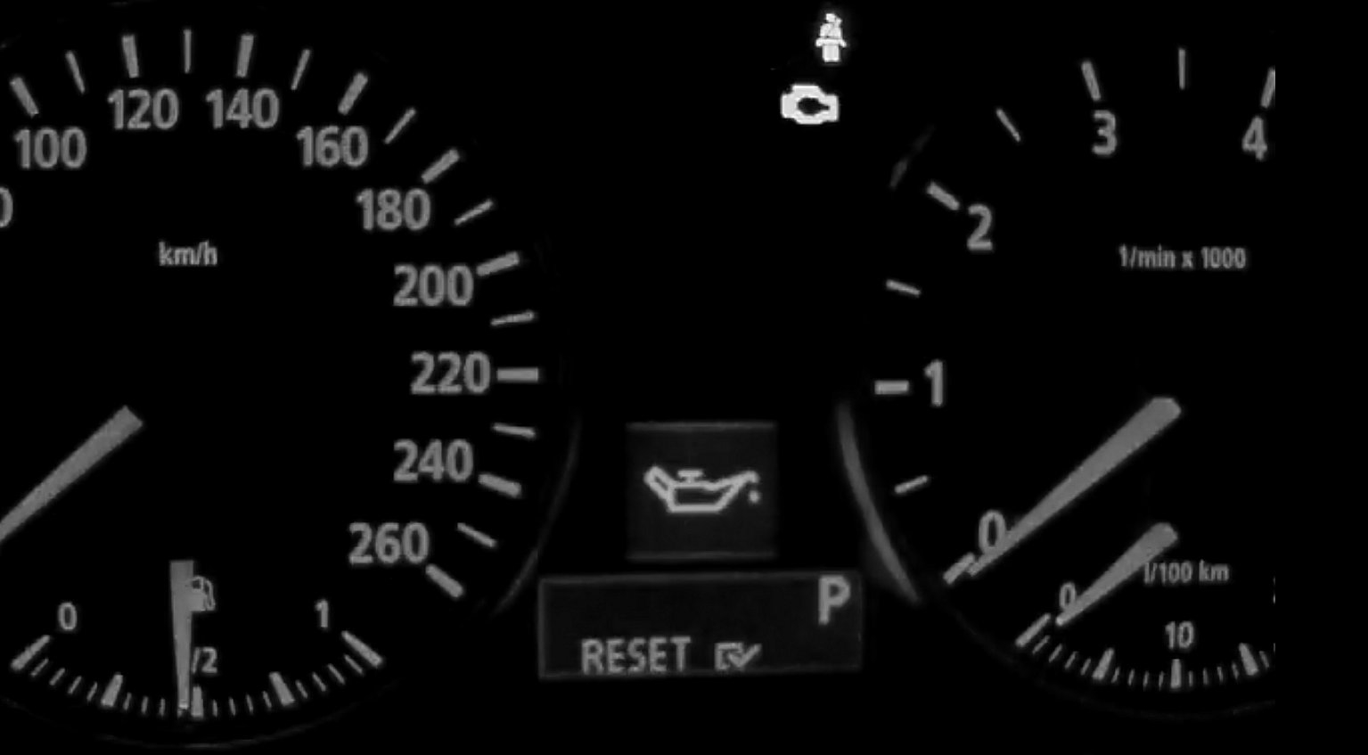

Select the service item to be reset. Press the "BC " button (-red arrow- ) for approximately 3-5 seconds until "Reset " appears.
Release the "BC " button (-red arrow -). Confirm the reset by repressing the "BC " and holding 3 seconds or until the display shows the time clock.
Immediately release the "BC " button after screen returns to service screen.
If another service item is to be reset, use the toggle/scroll switch to select item and repeat step 6 -8 .

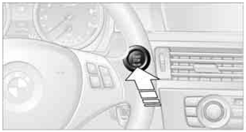

Re-insert the key/remote control.
Press the Start Stop Button and recheck display/work.

A "! " symbol at the end of the operation indicates that the operation is due, and a "o " symbol indicates a reset inhibition.
