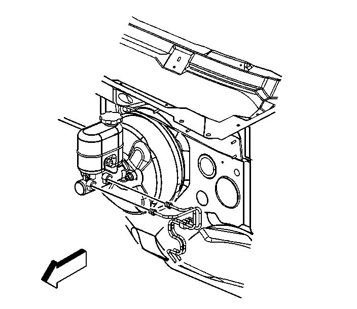

Here are directions specific to your vehicle. The attached pics correlate with the directions. Note that it is important to bench bleed the new MC prior to install or connection.
Caution: Refer to Brake Fluid Irritant Caution in Service Precautions.
Notice: Refer to Brake Fluid Effects on Paint and Electrical Components Notice in Service Precautions.
1. Apply the park brake and block the wheels.
2. Disconnect the electrical connector from the brake fluid level sensor.
pic 1

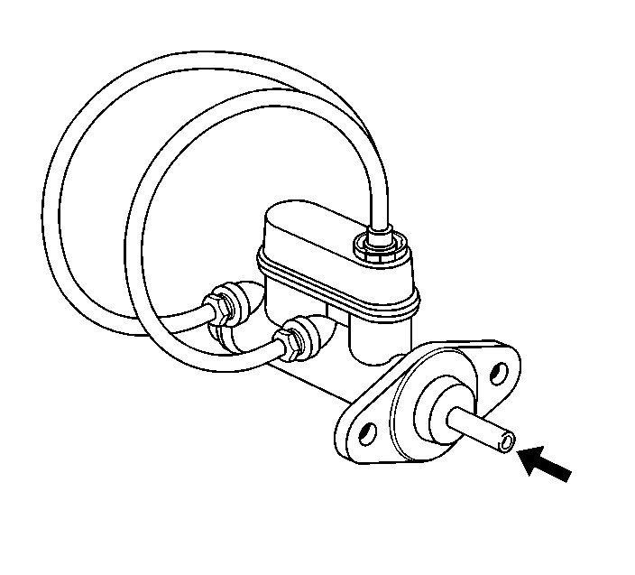

3. Disconnect the brake pipes from the master cylinder.
4. Important: Install a rubber cap or plug to the exposed brake pipe fitting ends in order to prevent brake fluid loss and contamination.
Plug the open brake pipe ends.
5. Remove the master cylinder mounting nuts.
6. Remove the master cylinder from the vehicle.
7. Remove the master cylinder reservoir.

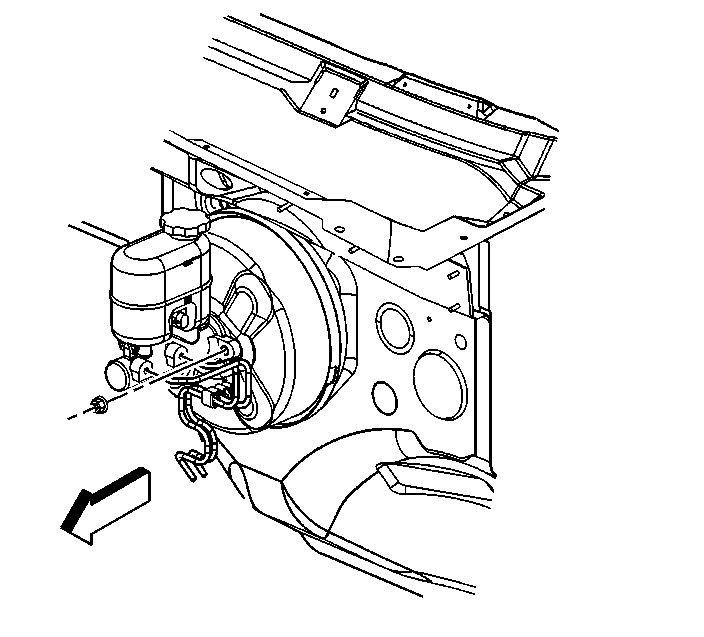

Installation Procedure

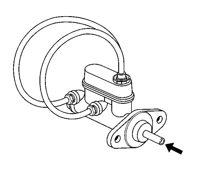

1. Install the master cylinder reservoir.
2. Bench bleed the master cylinder. Refer to Master Cylinder Bench Bleeding .

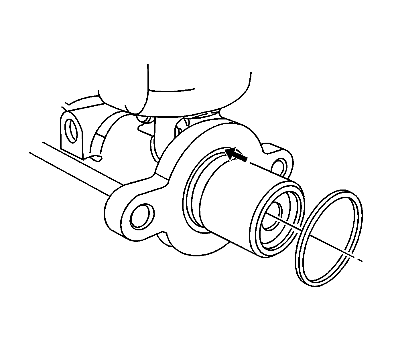

3. Important: If the seal is missing or damaged, replace the seal. Be sure that the O-ring is seated against the master cylinder base, not in the groove.
Install the O-ring seal to the master cylinder.
4. Install the master cylinder to the vehicle.
5. Notice: Refer to Fastener Notice .
Install the master cylinder mounting nuts.
^ Tighten the nuts to 36 Nm (27 ft. lbs.).
