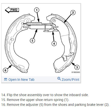

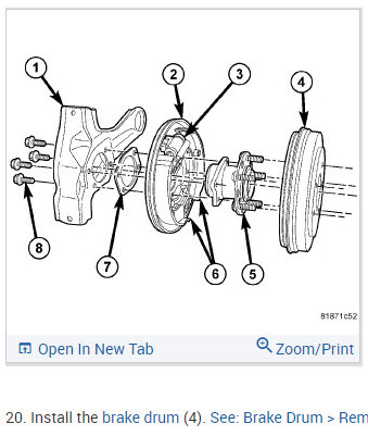

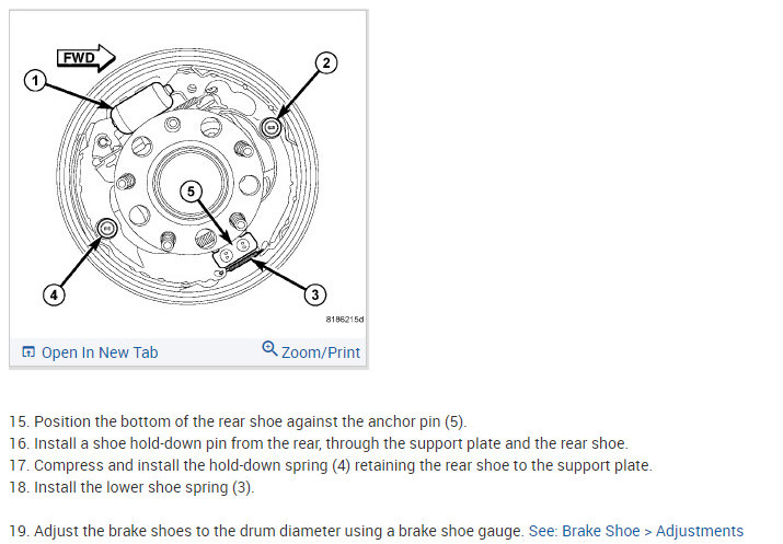

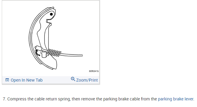

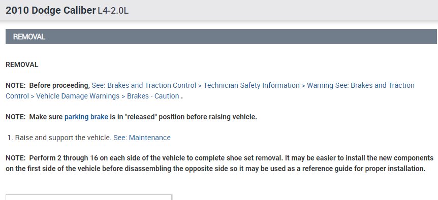

I have replaced my front brake pads which are disc brakes. After I have done that I found out I need rears can you help?
Oct 10, 2016 at 12:07 AM
DANNY L
  • 5,648 POSTS
Hello, I'm Danny.

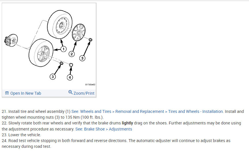

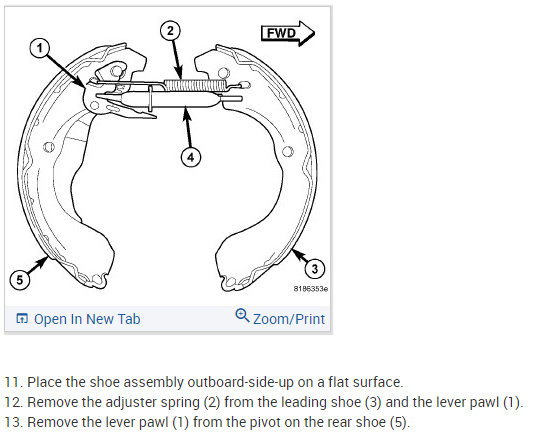

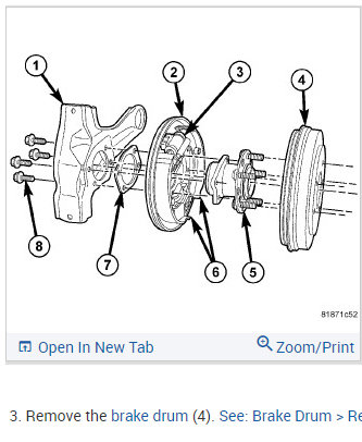

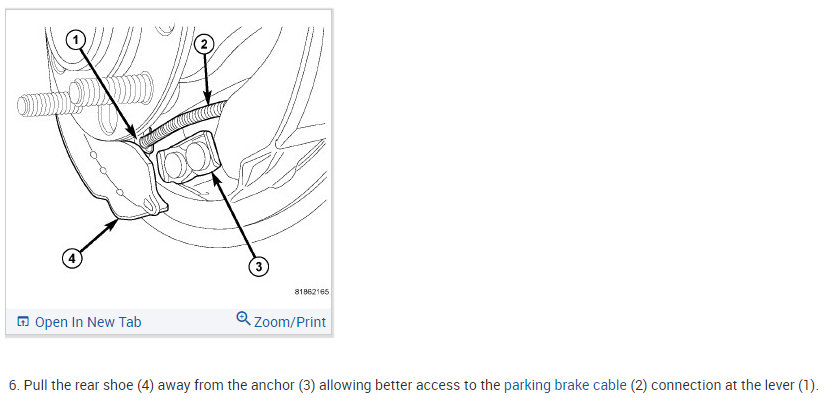

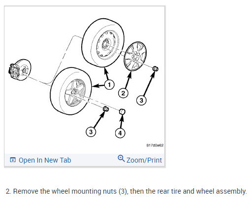

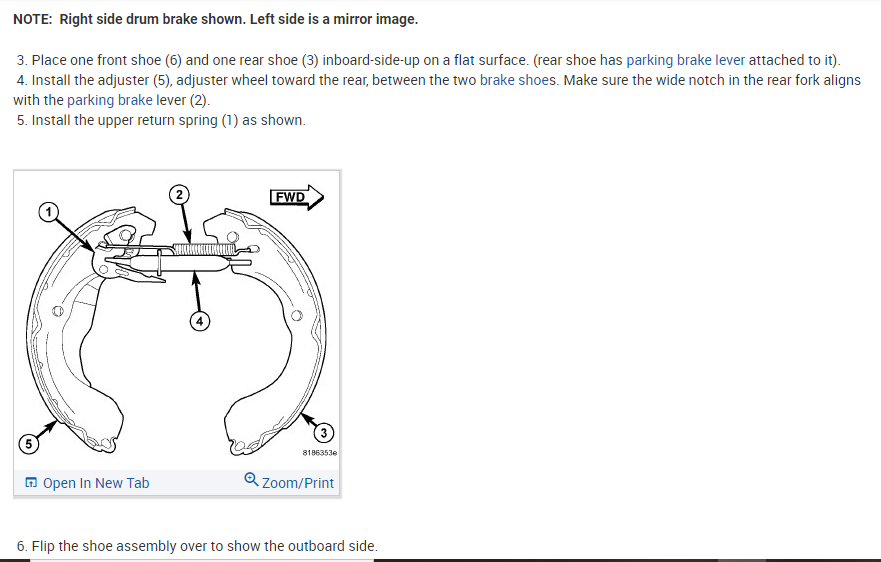

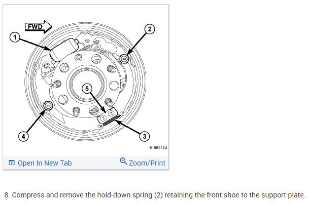

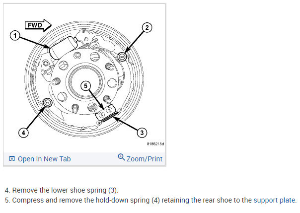

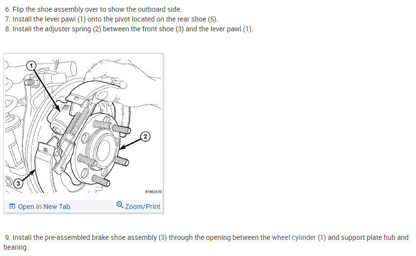

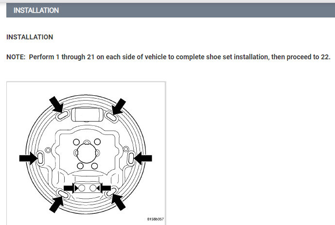

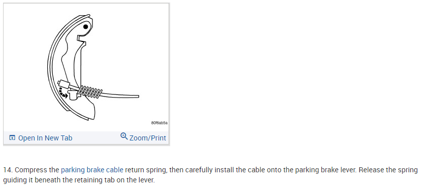

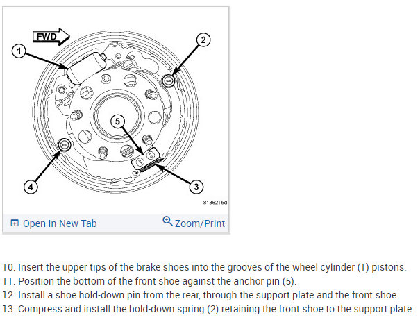

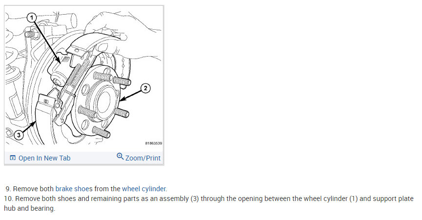

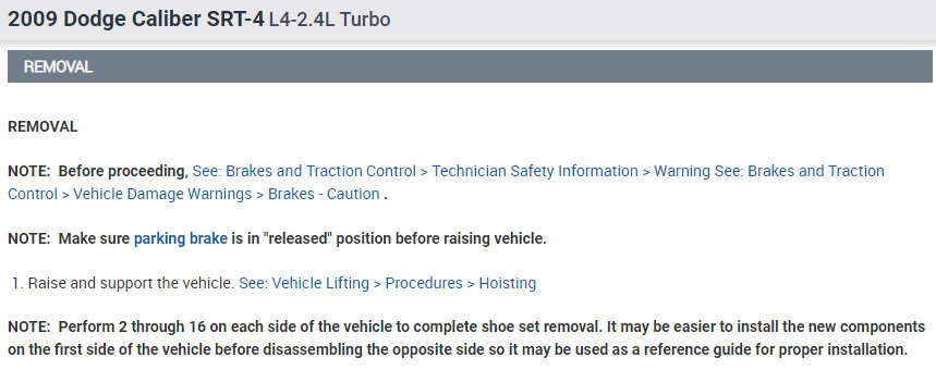

Here is the information you requested. Here is a guide to help you step by step with instructions in the diagrams below to show you how perform the repairs on your car.
I've attached a tutoring for parking brake shoe replacement which is similar.
https://www.2carpros.com/articles/parking-brake-shoe-replacement
I've attached picture steps below on how to replace the brake shoes on your car and it shows what special tools are needed to perform this repair. Hope this helps and thanks for using 2CarPros.

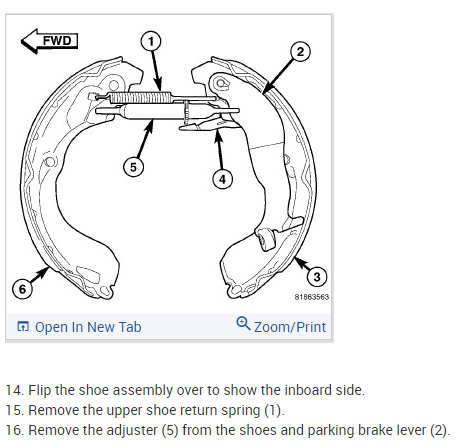

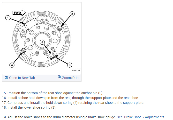

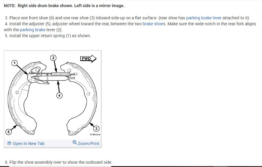

How do you adjust rear drum brakes on 2009 Dodge Caliber SXT with the wheels on? I am having problems locating the pawl in order to backdown the star adjusting wheel please give me replacement instructions as well.
Apr 23, 2021 at 12:59 PM (Merged)
DANNY L
  • 5,648 POSTS
Hello, I'm Danny.
