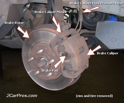

There is a rock stuck in my brakes or in that area. Where do I look for the rock or try clean the area?

Usually something like that will be stuck between either the caliper and the rotor or between the metal backing plate and the rotor. You should be able to look at the rotor and see scrub marks showing where it is. It can be difficult to fish them out depending on how they are stuck. The other possibility is that the brakes are worn and they are making the noise.
