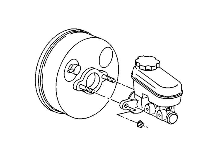

  • 52,797 POSTS
Good morning,
This sounds like the master cylinder has failed and is leaking internally and holding pressure.
https://www.2carpros.com/articles/how-to-replace-a-brake-master-cylinder
https://www.2carpros.com/articles/how-to-bleed-or-flush-a-car-brake-system
I would have the master cylinder replaced.
Master Cylinder Replacement
Removal Procedure
Caution: Refer to Brake Fluid Irritant Caution in Service Precautions.
Notice: Refer to Brake Fluid Effects on Paint and Electrical Components Notice in Service Precautions.
1. Disconnect the electrical connector from the brake fluid level sensor.
2. Disconnect the brake pipes from the master cylinder.
3. Important: Install a rubber cap or plug to the exposed brake pipe fitting ends in order to prevent brake fluid loss and contamination.
Plug the open brake pipe ends.
4. Remove master cylinder mounting nuts.
5. Remove the master cylinder from the vehicle.
6. Drain the master cylinder reservoir of all brake fluid.
Installation Procedure
1. Bench bleed the master cylinder.
2. Install the master cylinder to the vacuum brake booster.
3. Notice: Refer to Fastener Notice in Service Precautions.
Install the master cylinder mounting nuts.
Tighten the master cylinder mounting nuts to 33 Nm (24 ft. lbs.).
4. Remove the plugs from the brake pipes
5. Connect the brake pipes to the master cylinder.
With ABS tighten the brake pipe fittings at the master cylinder to 30 Nm (22 ft. lbs.).
Without ABS tighten the front brake fittings to 27 Nm (20 ft. lbs.).
Without ABS tighten the rear brake fittings to 25 Nm (18 ft. lbs.).
6. Connect the electrical connector to the brake fluid level sensor.
7. Bleed the brake system.
Tuesday, March 16th, 2021 AT 5:12 PM (Merged)

Bleed the brakes, all four of them, start with farthest from MC and work your up to closest to MC. If you still have no pedal, then leak or MC.
Tuesday, March 16th, 2021 AT 5:13 PM (Merged)
NJPAMPINELLA
I manually bled all 4 lines. I started with the passenger rear then driver rear, passenger front, driver front. At first. Nothing! After about 9 times of crackin the bleeder a tiny bit of fluid came from the passenger rear & the driver front. I got absolutely nothing out of the driver rear or the passenger front. I thought it could possibly be that the bleeders were clogged so I gravity bled them. Still nothing from those 2 calipers. I can actually stop the car now but there isnt any pressure behind the pedal & my stopping distance is for S**t! I thoroughly inspected the undercarriage with a flashlight & there is no fluid leaking from anywhere. I had the ABS system scanned & no codes came up. Still think it's the master?
MMPRINCE4000
  • 8,548 POSTS
If you cannot get fluid to flow from the bleed screws, either there is a clogged up line or the MC is leaking internally.
When installing a new MC, bench bleed it before install.
