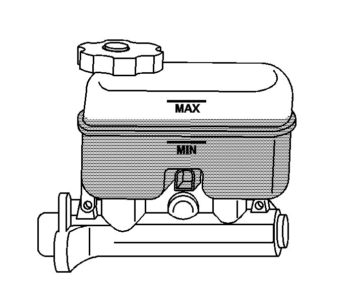

1. Inspect the brake fluid level in the brake master cylinder reservoir.
2. If the brake fluid is midway between the maximum-full point and the minimum allowable level, no brake fluid needs to be removed from the reservoir before proceeding.

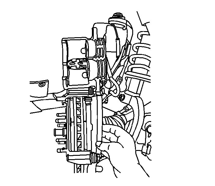

pic 2
3. If the brake fluid level is higher than midway between the maximum-full point and the minimum allowable level, remove the brake fluid with appropriate tool to the midway point before proceeding.

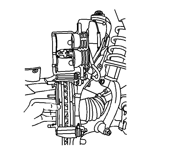

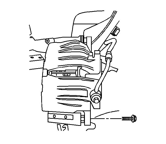

pic 3

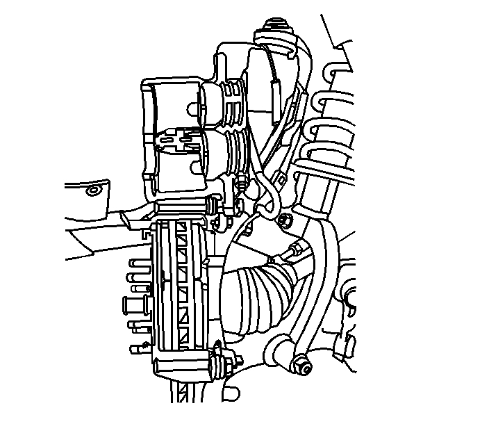

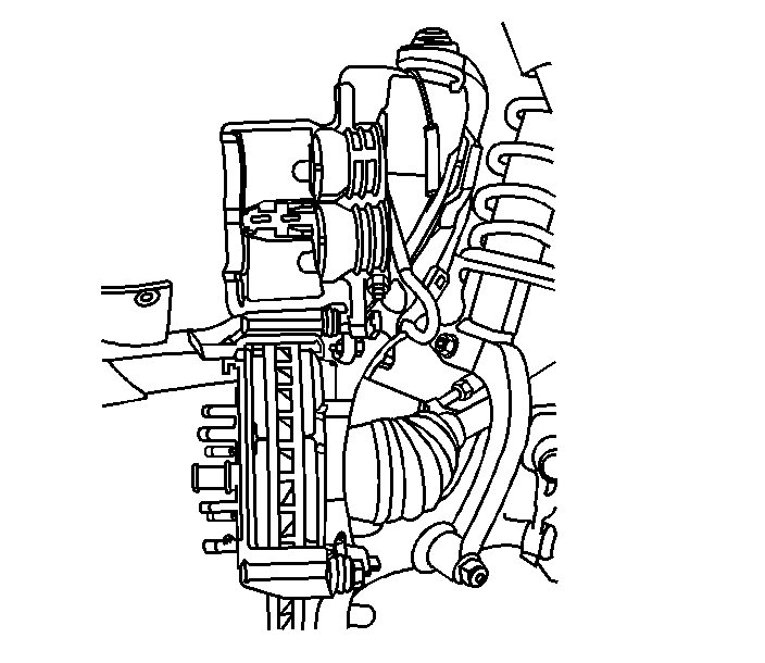

6. Compress the front brake caliper pistons.
1. Install a large C-clamp over the top of the brake caliper housing and against the back of the outboard brake pad.
2. Slowly tighten the C-clamp until the pistons push into the brake caliper enough to slide the brake caliper off the rotor.
3. Remove the C-clamp from the brake caliper.

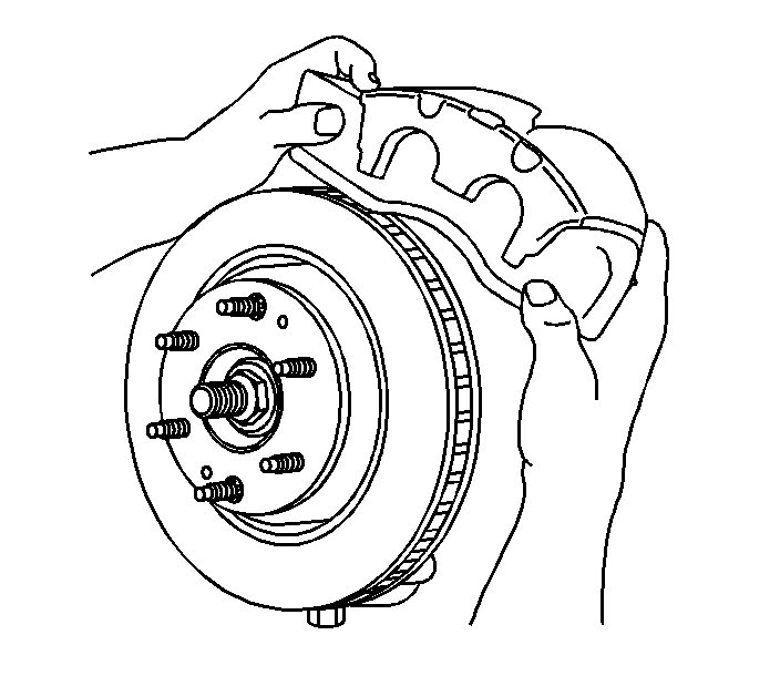

pic 4

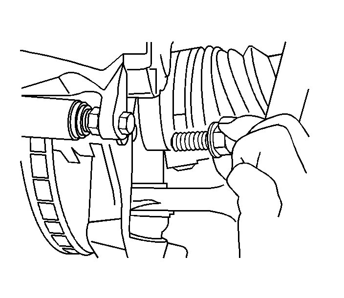

7. Remove the lower mounting bolt from the guide pin.

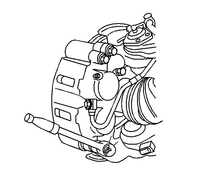

pic 5
8. Rotate the brake caliper upward until it stops.

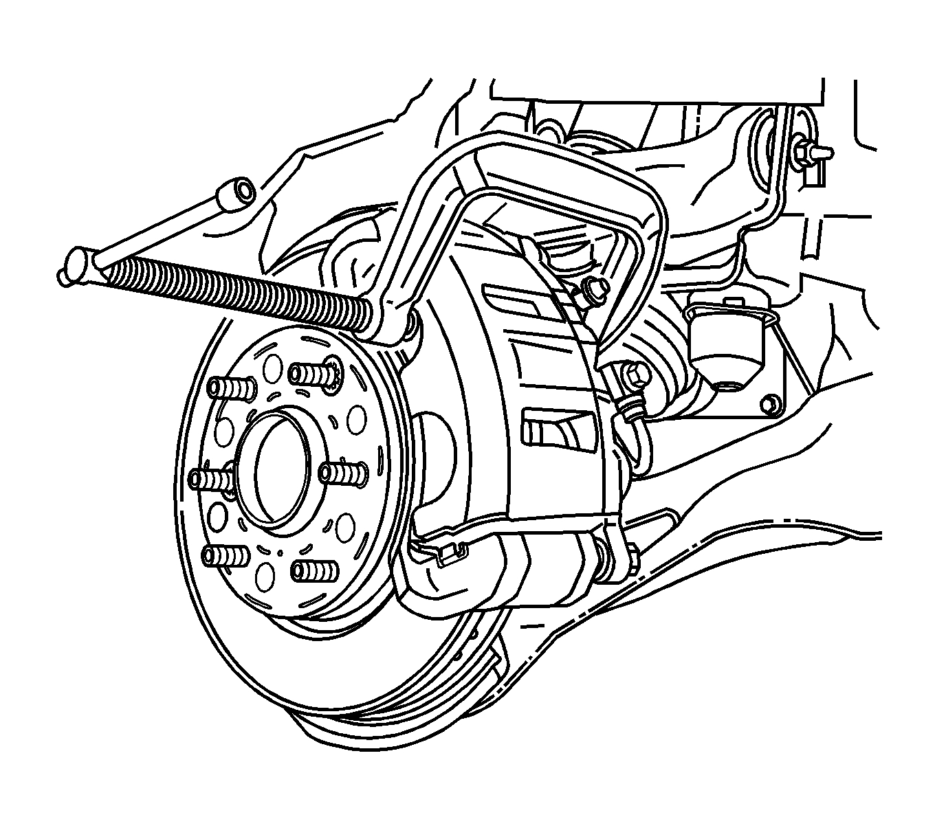

pic 6
9. Remove the outboard brake pad.
pic 7
10. Remove the inboard brake pad.
pic 8

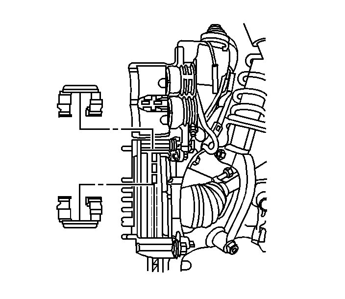

11. Remove the brake pad retaining clips from the brake caliper mounting bracket and discard.
12. Remove all foreign material from the brake caliper using denatured alcohol.
Installation Procedure
pic 9
Important: When installing new brake pads, DO NOT reuse the old retaining clips for the brake pad. Use only NEW brake pad retaining clips.
1. Install the brake pad retaining clips to the brake caliper mounting bracket.

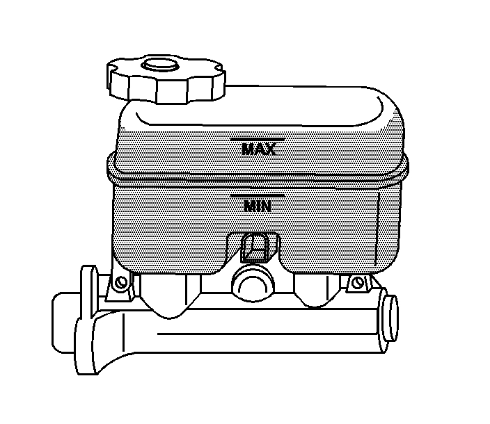

pic 14
3. If the brake fluid level is higher than midway between thew maximum-full point and the minimum allowable level, using a appropriate tool, remove the brake fluid to the midway point before proceeding.

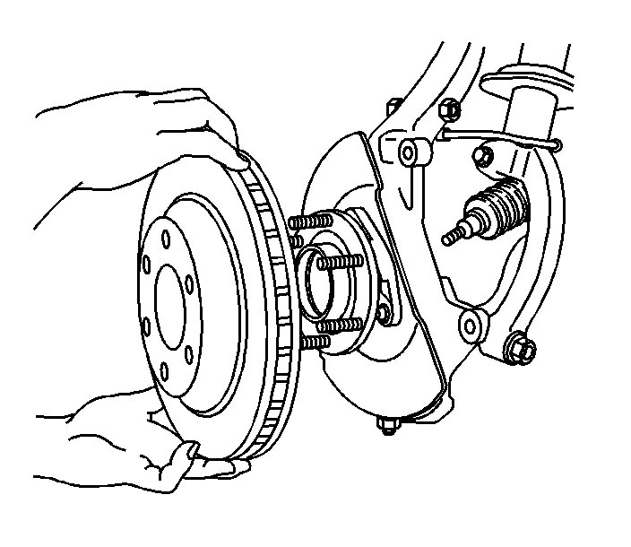

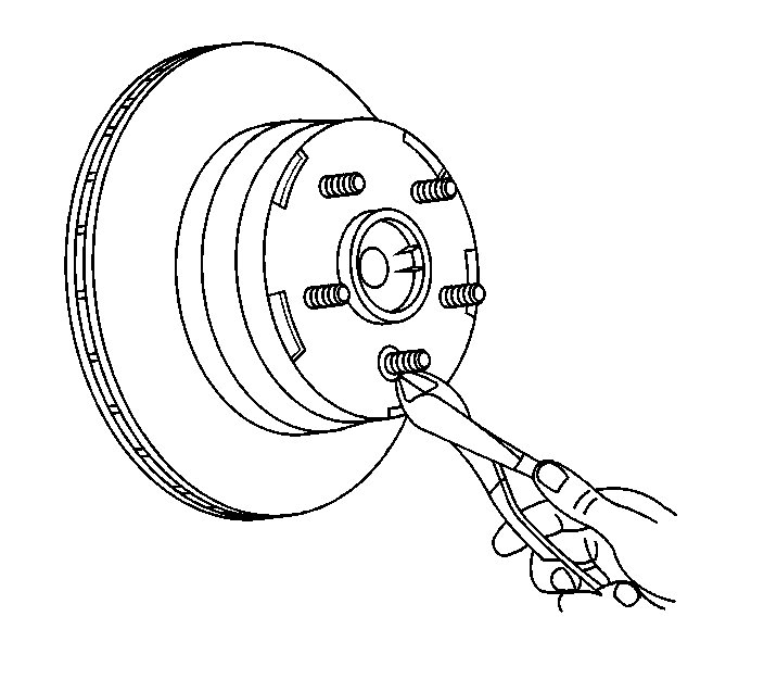

9. Remove the retaining clips from the brake rotor.
pic 19

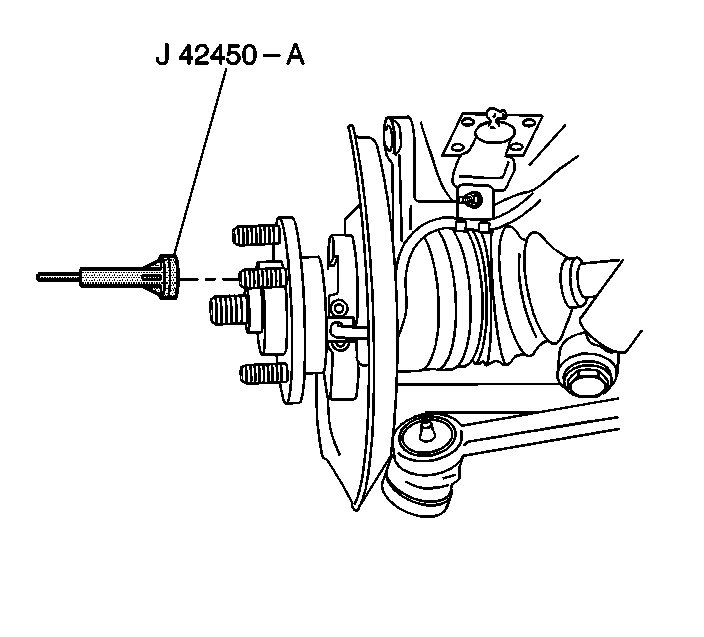

Notice: Whenever the brake rotor has been separated from the wheel bearing flange, clean any rust or foreign material from the mating surface of the rotor and flange with the J 42450 hub cleaning kit. Failure to do this may result in increased lateral runout of the rotor and brake pulsation.
Important: If the brake rotor is not going to be replaced but just removed from the front hub, mark the relationship of the brake rotor and a wheel stud.
10. Remove the front brake rotor from the wheel hub.
pic 20
11. Using the J 42450-A, clean the brake rotor contact area on the front hub.
