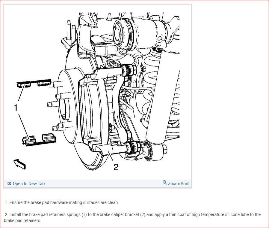

Had all brakes and rotors changed but rear brakes rattle when you hit bumps, but when you bumps with the the brakes on no rattle.
May 16, 2019 at 11:20 AM
Hi Bogie,

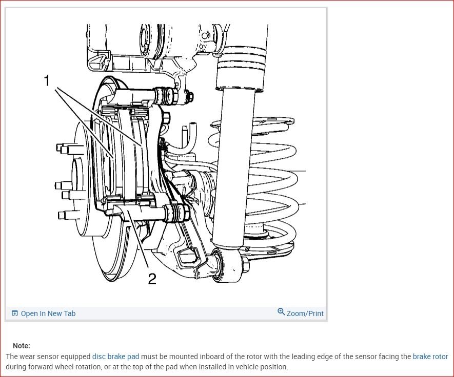

Is this the noise that you are hearing? Refer to the link below. Most likely it is the type of issue. It appears your pads are a little different design but the basic idea is the same.
The brake caliper hardware may be the issue. Just make sure they installed a new set because some brake pad sets do not supply new hardware so the shop tries to reuse the old or just installs the pads without the hardware.
https://youtu.be/Dm_I8j9nTHc
Let me know if you have questions. Thanks
