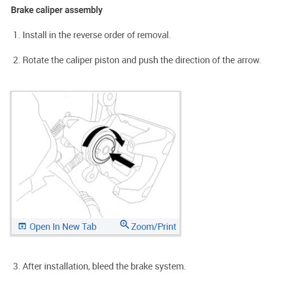

Replaced driver side rear caliper and all new brakes. Had no good pedal. Starting with passenger rear I bled all lines and pass side rear makes a squishing noise but nothing comes out except fluid. I bled a quart through the passenger rear which is extreme amount still makes squishing noise when being bled. Pedal still goes to floor but brakes will stop the car. Do I still have trapped air and do I need to keep bleeding until noise goes away?

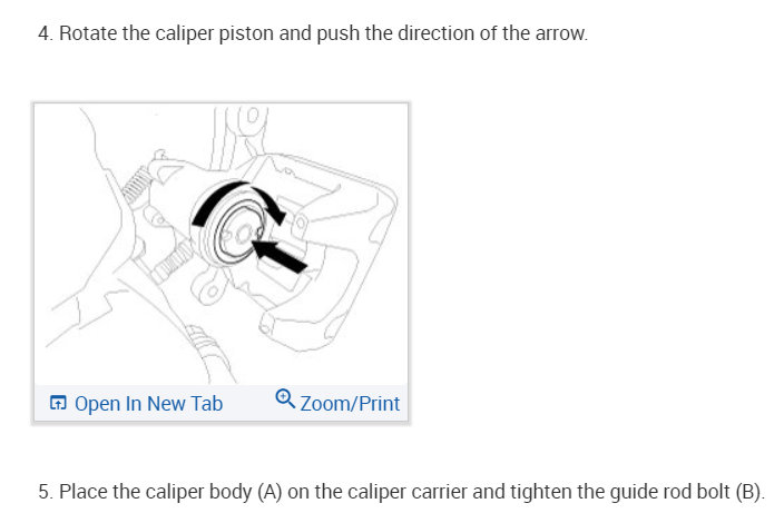

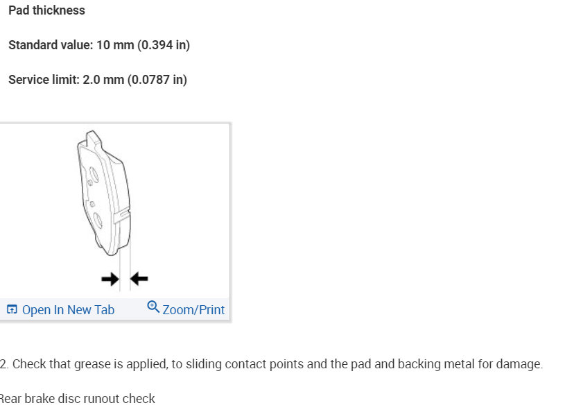

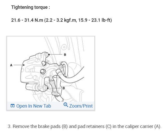

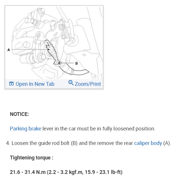

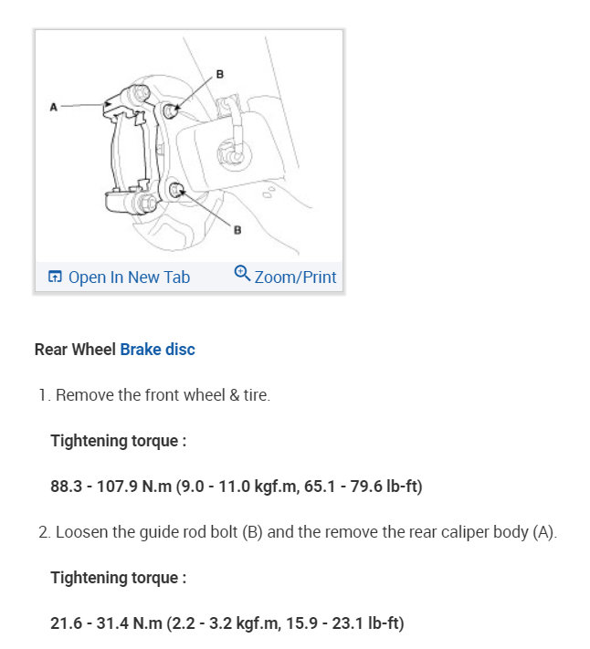

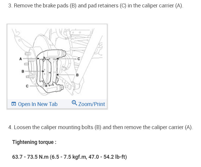

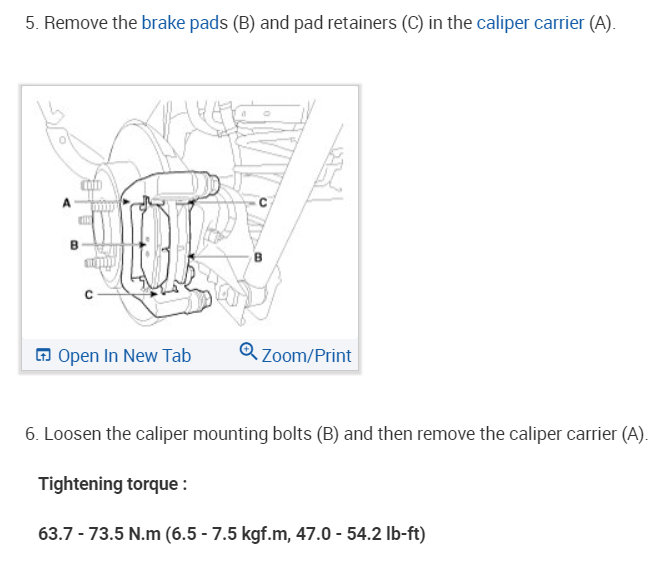

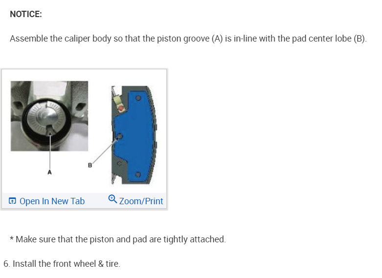

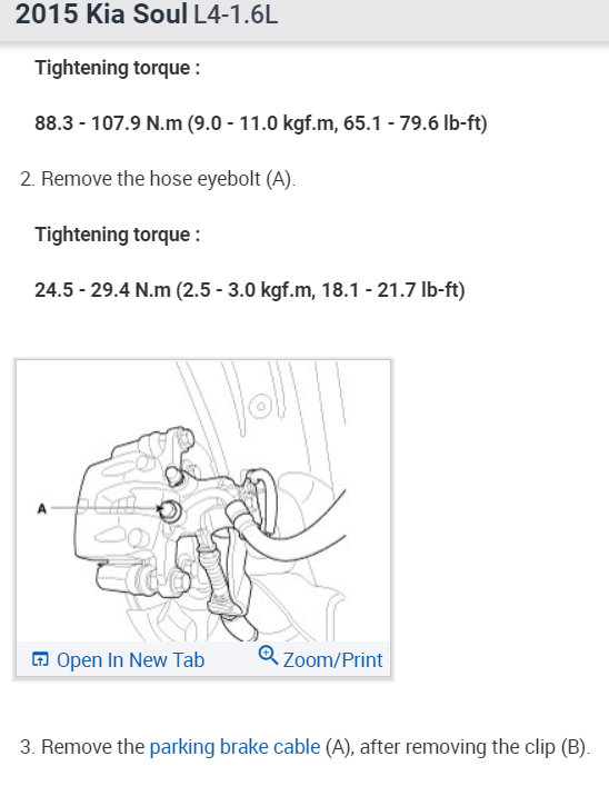

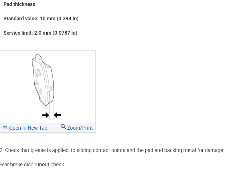

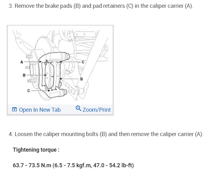

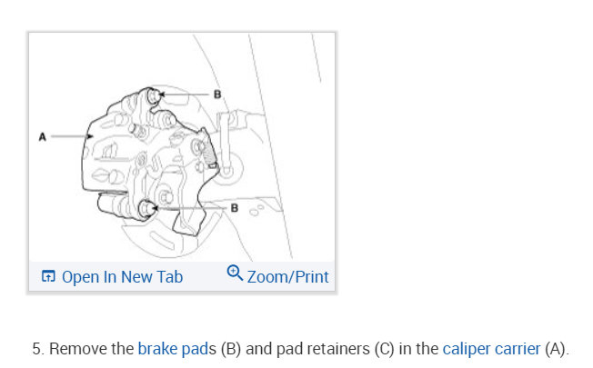

It sounds like you may have the caliper on wrong if no air comes out. Can you take a pair of vise grips and gently close of the rubber line to the caliper to see if the brake pedal is better? Also recheck your work of the caliper mount here is a diagrams to help us.
The pad has a notch that must be installed correctly or you will have low pedal.
This video show the job being down on a different car but the process is the same, it shows how to use the tool.
