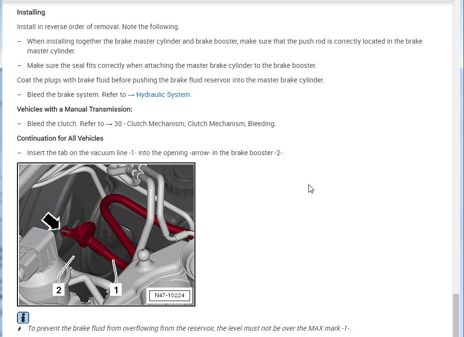

I replaced the rear calipers, rotors, and brake pads. I bled the brakes by having someone press the brakes and me open and close the bleeder screw, then took it to a mechanic to bleed the lines. However, the brake pedal travels to the floor as in no pressure (like it did when I bled the lines). If I pump the brakes, there is some pressure, but the pedal travels to the floor again. I think there is either air in the master cylinder or the master cylinder is bad. Is there a way to bleed the master cylinder while it is on the car or should it be bench bled? Or is there way to test the master cylinder to see if it is bad? The brakes were not that firm before the rear brake job, so I am thinking it might be the master cylinder. Any thoughts?

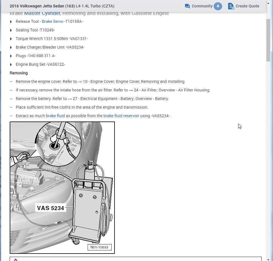

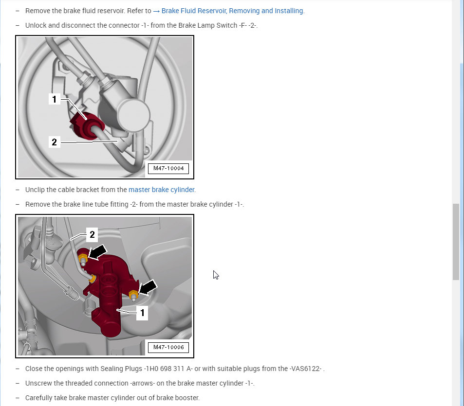

Thanks for the answer! Would the brake master cylinder need to be bench bled before being put on the car? It looks like the reservoir would be in the way of a tap to tighten it to the car if it did need to be bench bled. Thank you again!

Just to jump in here. yes, it's always a great idea to bench bleed a master cylinder before installing.Usually the master cylinder when purchased will come with a paper instruction guide on how to do it with a screwdriver or punch on your work station or table.When it comes time to bleed brake calipers after installation just remember to start with the one farthest away and work forward. Right rear,left rear,right front,left front and always keep the master cylinder full of fluid to not suck any air back into the system.Keep us updated and let us know if you have any further questions about this.Hope this helps and thanks again for using 2CarPros.
