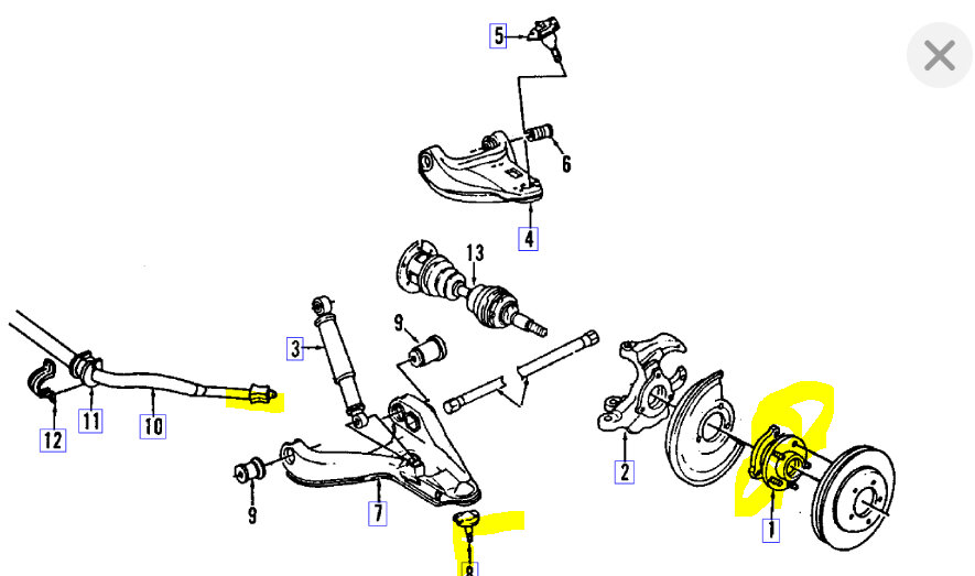

It could be a few things causing that. It could even be related to the brakes hanging up. Most commonly, it is a bent rim or balance issue with the tires. Is there anything you can do that changes what you feel? For example, if you apply the brakes does it go away or get worse?
Sep 14, 2023 at 11:49 AM
TRESAPOTTER
It goes away.
Sep 14, 2023 at 11:55 AM
  • 110,244 POSTS
If it goes away, check to make sure there are no issues with the steering components. Check for a loose tie rod or ball joint.,
I attached a pic below and highlighted the things to check for play. The wheel will need to be off the ground.
Let me know what you find.
See pic below.
