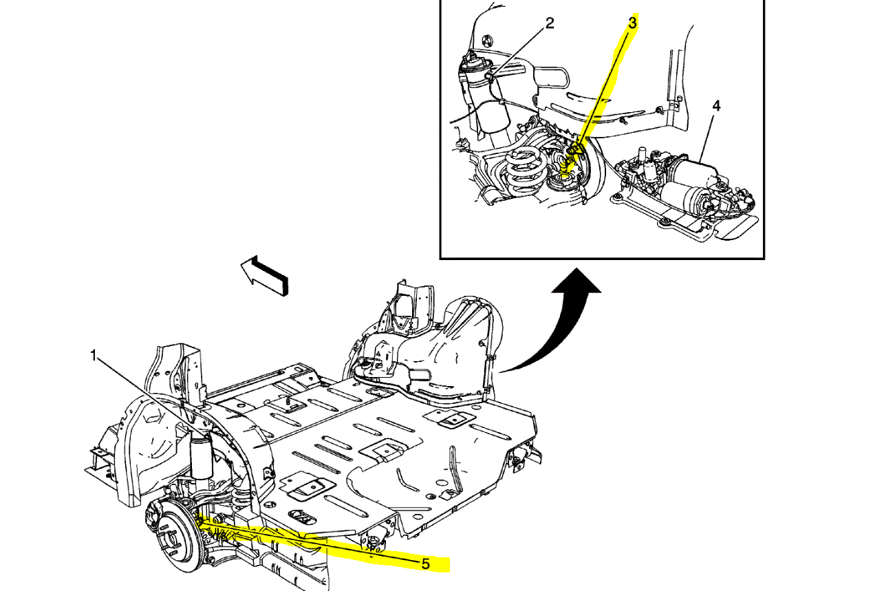

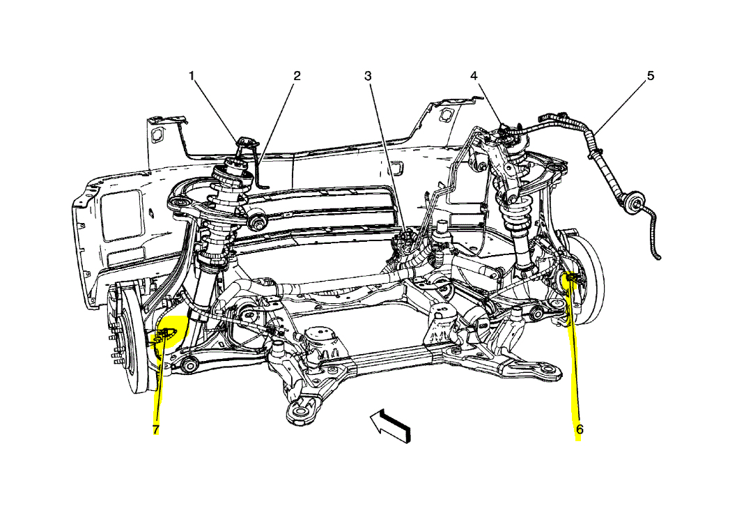

I recently had my brake pads replaced, front and back. Shortly after my brake assist, stable link and traction control lights are on. The fluid is not low. It looks like it’s a little above the max fill line. What could the problem be?

Let's start with checking for codes. The most common cause of this is a speed sensor issue or some other issue with the ABS system. However, it is a good idea to pull codes and go from there.

Chances are it is related to a wheel speed sensor. If one fails, it will turn on all the lights you mentioned.

I attached two pics below. The first shows the front wheels and the second shows the rear wheels. I highlighted the sensors to help you locate them.
At first, just make sure nothing was left disconnected or loose. Also, make sure the wiring to them hasn't been damaged.
Let me know what you find. Also, please feel free to let me know if you have other questions.
