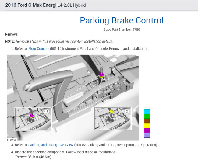

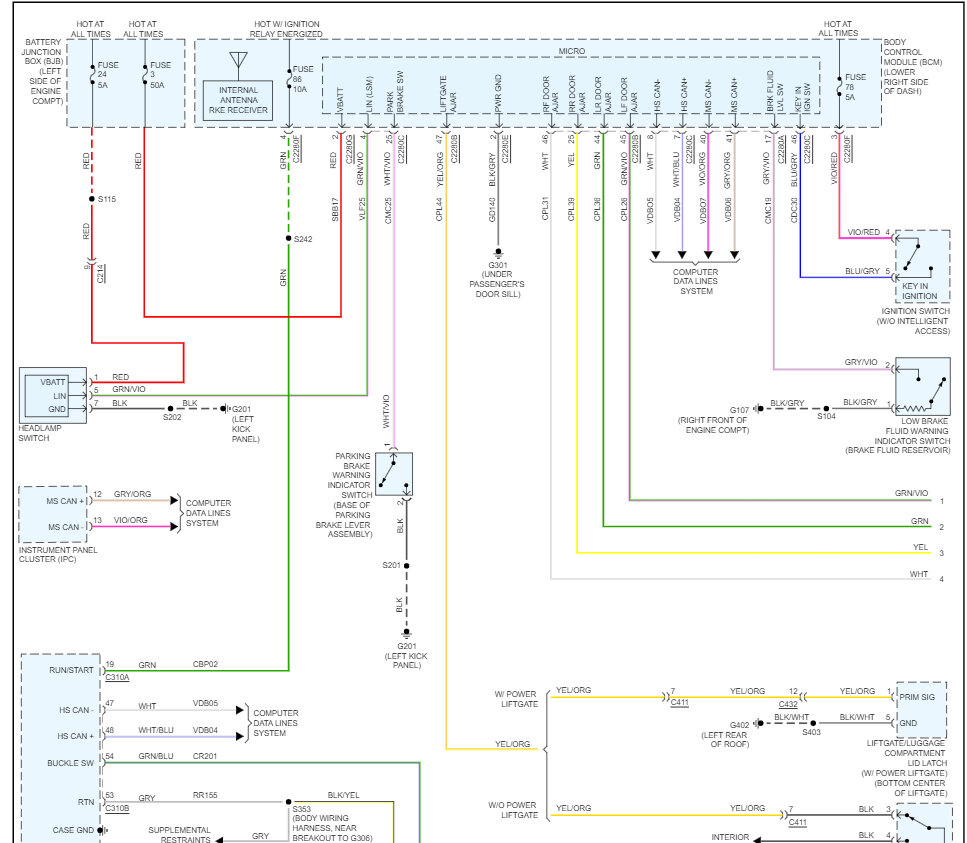

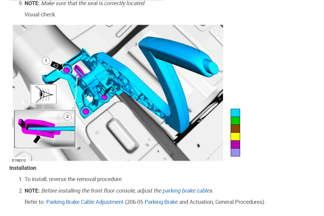

My brake warning light came on, so I got the pads and rotors replaced but the light is still on and won’t turn off. Fluid is also full.
May 22, 2023 at 5:45 AM
  • 55,402 POSTS

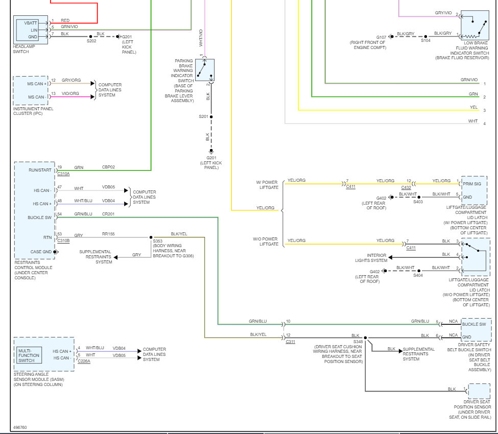

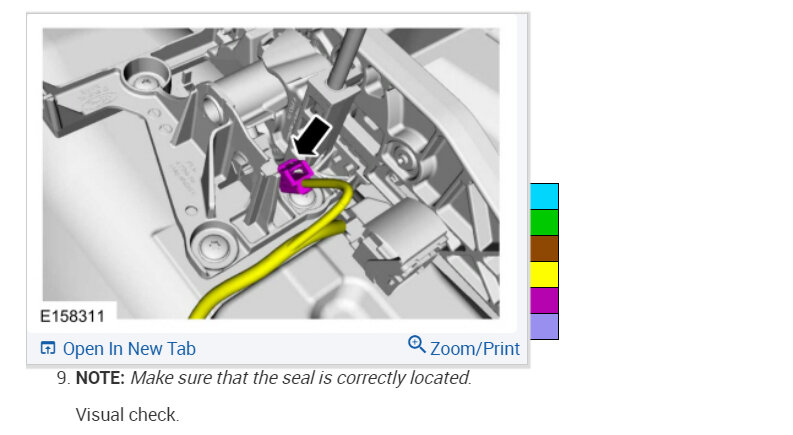

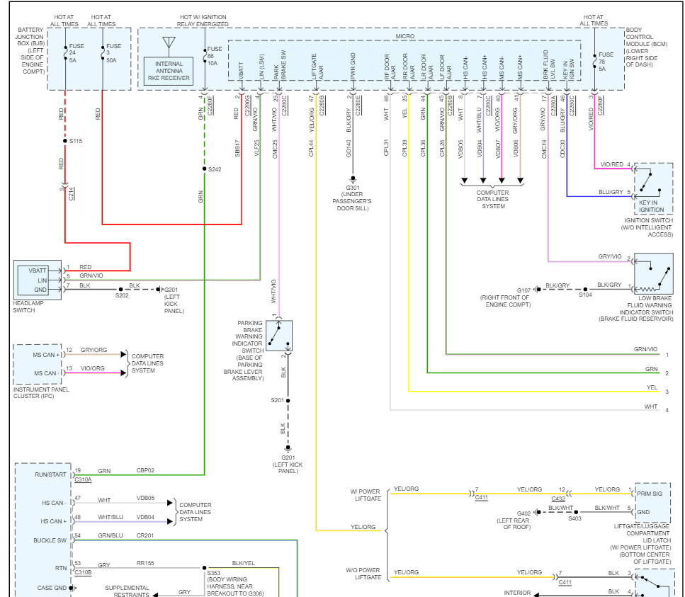

This warning light also comes on when the parking brake level is slightly depressed, or the switch needs to be replaced. Here is the location of the switch so you can check it out. You can try grounding the wire on the parking brake to confirm the issue. Also, here are the wiring diagrams for the brake warning light which goes through the BCM which might be bad. Let's do a CAN scan to see what comes up, I think it will be helpful. You can get a CAN scanner (Controller Area Network) which will work on most cars from Amazon.
https://youtu.be/u-4syLc-ifQ
and
Please check the fuses on the BCM as well, also you can try to grounding the brake fluid level sensor as well. Check out the images (below). Let us know what happens and please upload pictures or videos of the problem so we can see what's going on.
