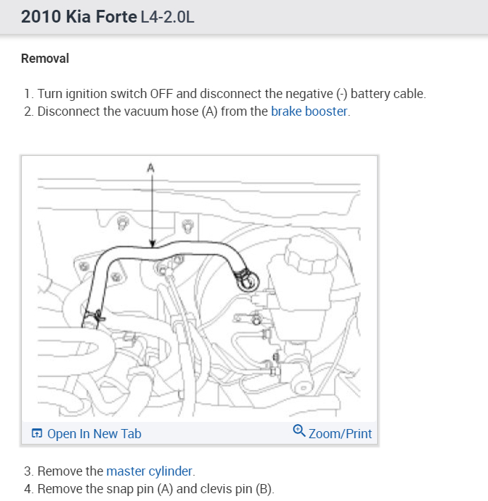

When I depress the brake pedal it make a sound like a muted horn. The sound comes from under the dash. The pedal goes almost to the floor, but can be pumped up. No lose of braking. I did replace the master cylinder because the brake fluid looked aerated. The problem was there before the replacement of master cylinder.
This is not normal brake sounds like rubbing/grind of brake pads.
Could this be a bad Power Brake Booster?
Nov 9, 2018 at 12:53 AM
  • 55,433 POSTS

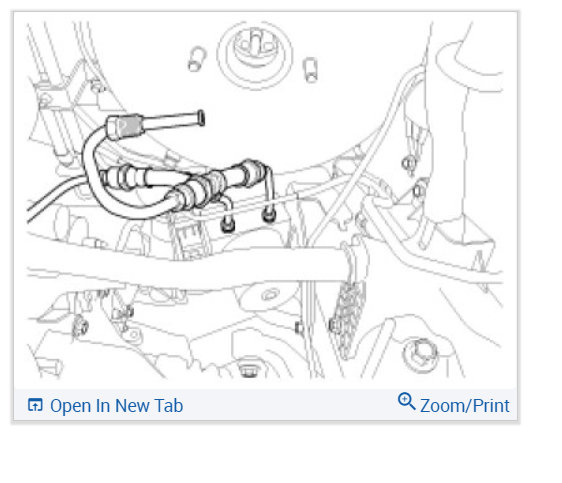

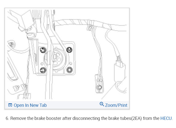

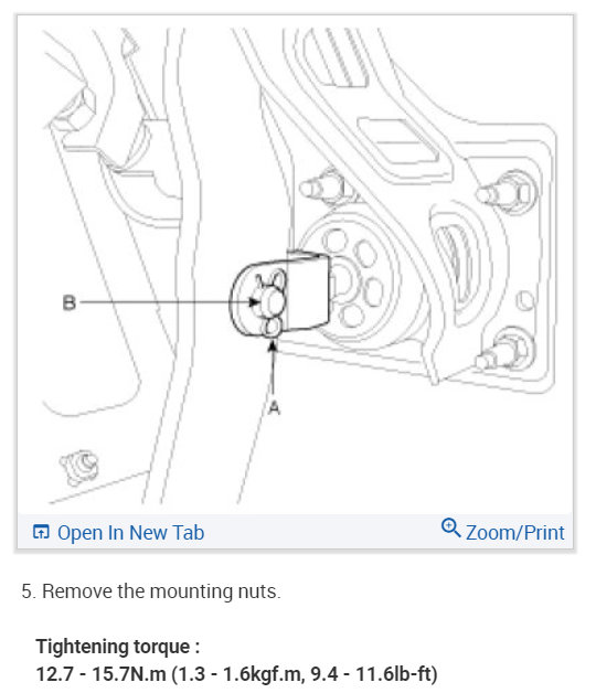

It does sounds like the brake booster is bad. To be sure can you please shoot a quick video with your phone so we can hear the noise, that would be great? You can upload it here with your response. Here are diagrams to help you change out the booster below.
