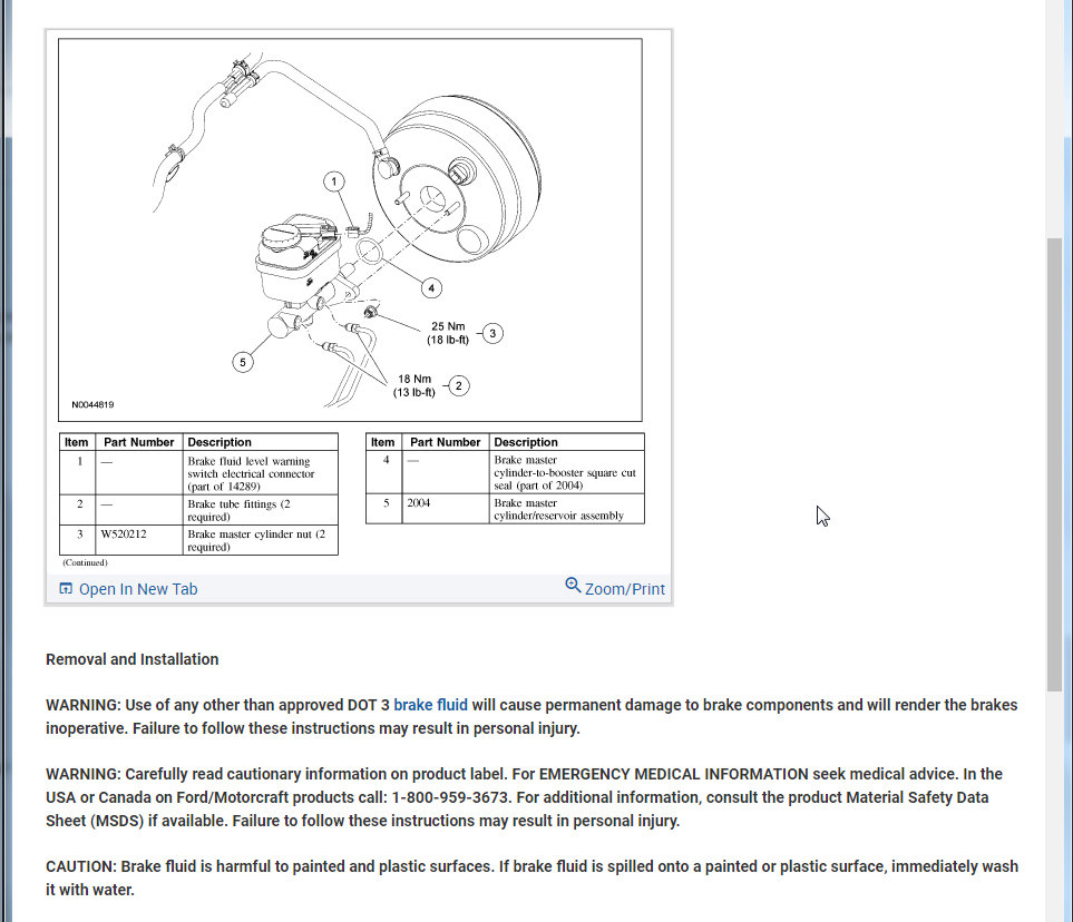

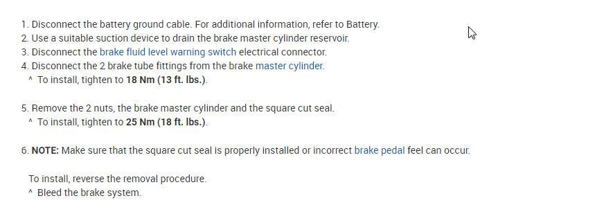

In most cases this is an issue with the master cylinder so in the event it proves out to be this, I attached below the process on how to replace this.
However, I would suggest with bleeding the brakes first just to make sure you don't have air in the lines.
https://www.2carpros.com/articles/how-to-bleed-or-flush-a-car-brake-system
