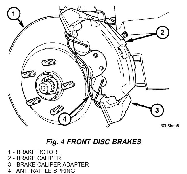

pic 1
3. Remove the anti-rattle spring from the outboard side of the caliper and adapter (Fig. 4).

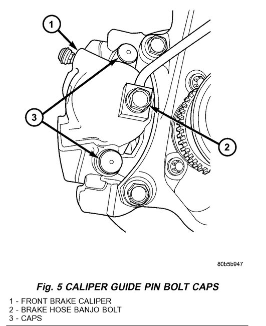

pic 2
4. Remove the two caps in place over the caliper guide pin bolts (Fig. 5).

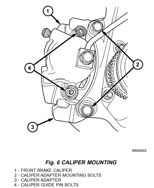

pic 3
5. Remove the two caliper guide pin bolts (Fig. 6).

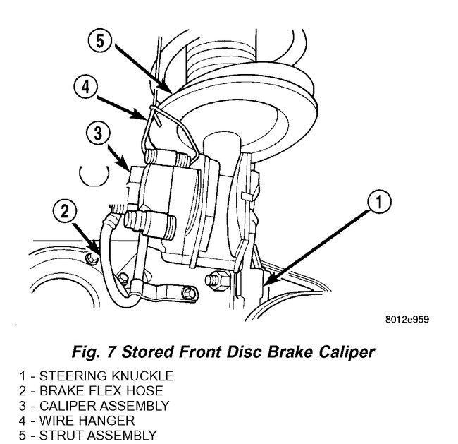

pic 4
7. Using wire or cord, hang the caliper from the front strut assembly (Fig. 7). Support the caliper firmly to prevent weight of caliper from being supported by the brake fluid hose.

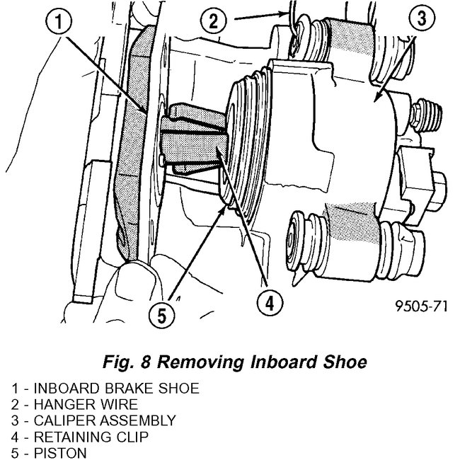

pic 5
9. Pull the inboard brake shoe away from the caliper piston until the retaining clip on shoe is free from the cavity in the caliper piston (Fig. 8).

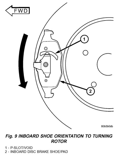

pic 6
NOTE: Inboard brake shoes are stamped L or R for left or right side of the vehicle. The P-slot or void on piston insulator must be positioned upward when brake caliper is mounted (Fig. 9).
4. Install the new inboard brake shoe into the caliper piston by firmly pressing its retaining clip into the piston bore. Be sure the inboard brake shoe is positioned squarely against the face of the caliper piston.
