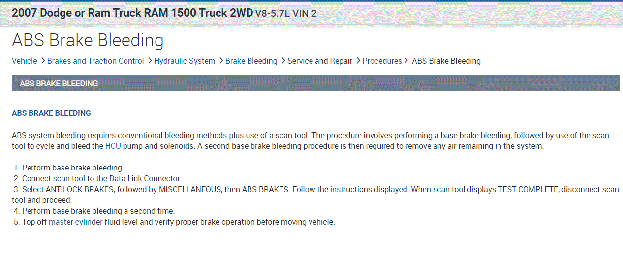

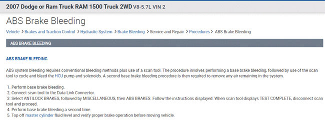

It sounds like you are doing things correctly. I do have a question. When you had a helper, did you have him pump the brakes, hold pressure on the pedal, open the bleeder, close the bleeder and then release the pedal? Also, the automated bleed should have eliminated air from the ABS. Again, did you have the bleeder closed before releasing the brake pedal?
I attached the directions for the automated bleed procedure below. What you did sounds spot on. You may have gotten a bad MC.
Take a look through this link:
https://www.2carpros.com/articles/brake-pedal-goes-to-the-floor
See pic.

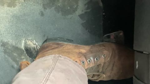

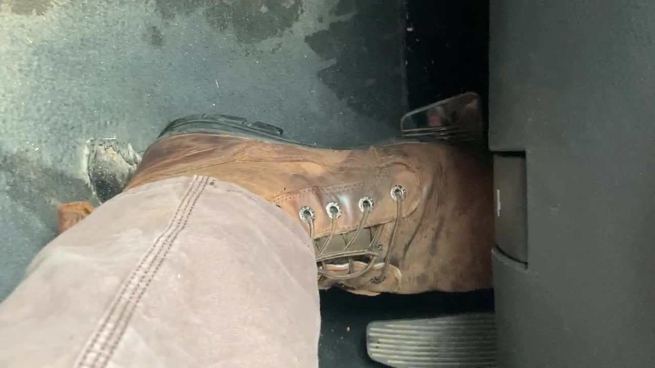

Jun 27, 2021 at 9:34 PM
CVAS828
  • 6 POSTS
Video attached. Pedal held firm from what I can tell. Not sure how much play there should be. You can see the travel distance when vehicle is started.
Jun 28, 2021 at 10:15 AM
  • 110,194 POSTS
I watched the video. That looks excessive. Is it actually reaching the floor? I'm asking because you indicate you're unsure of the play.

With the vehicle on pedal reaches floor. Vehicle off, pedal pumped, and held there is very little movement. No sinking. What I meant was, you stated to pump and hold pedal, I am not sure how much “play” (movement) is consistent with a bad master cylinder. I am going to isolate the master cylinder and plug both primary and secondary ports and check for change in performance, if any.
