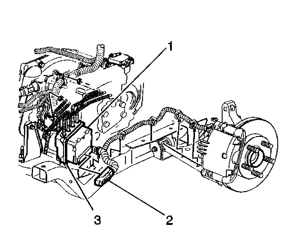

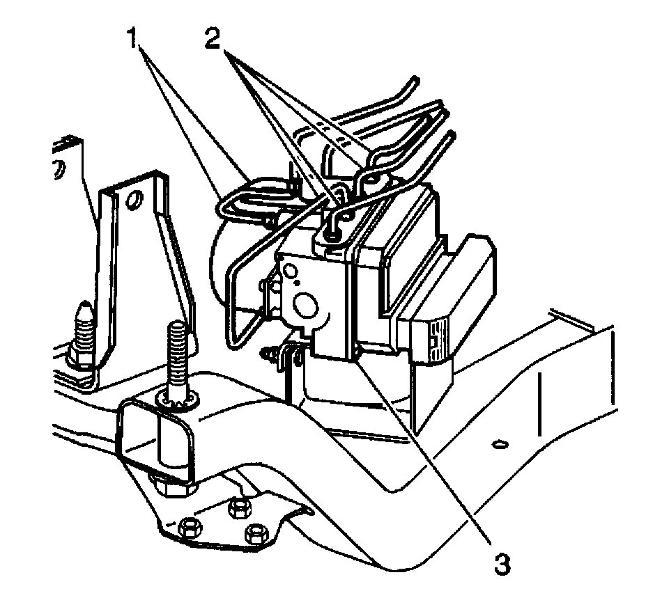

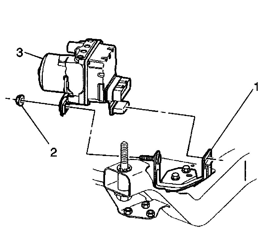

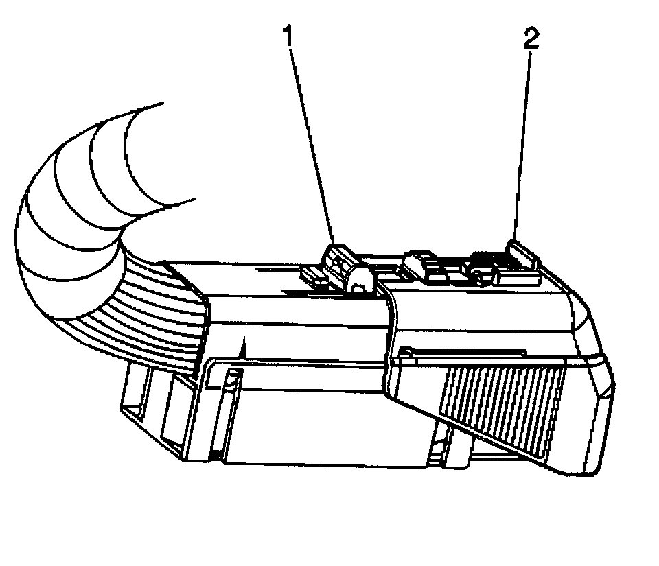

It sounds like you got the air out. Here are the directions for removal and replacement of the ABS module. Note that at the end, it simply says reconnect the battery and nothing about an automatic bleed. See if there is anything in these directions you may have missed.

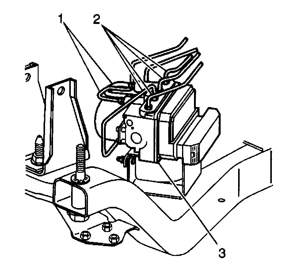

Caution: For safety reasons, the brake pressure modulator valve assembly must not be repaired, the complete unit must be replaced. With the exception of the EBCM, no screws on the brake pressure modulator valve assembly may be loosened. If screws are loosened, it will not be possible to get the brake circuits leak-tight and personal injury may result.
1. Remove the battery.
2. Remove the battery tray.
Important: Note the locations of the brake pipes in order to aid in installation.
3. Disconnect the caliper and wheel cylinder brake pipes (2) from the BPMV (3). Cover the ends of the brake pipes to avoid dripping or contamination.
4. Disconnect the master cylinder brake pipes (1) from the BPMV (3). Cover the ends of the brake pipes to avoid dripping or contamination.

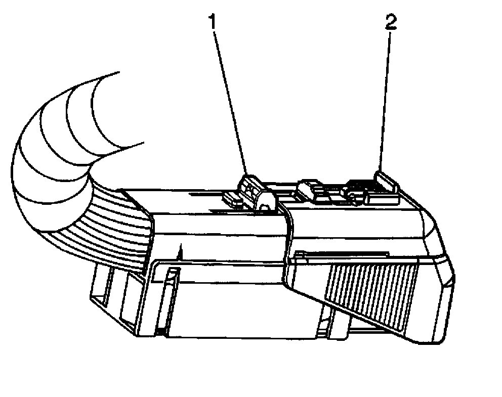

Pic 2
8. Disconnect the Connector Position Assurance (CPA) (2) from the EBCM connector.
9. Push the lock tab (1) down and then move the sliding connector cover to the open position.
Pic 3
10. Disconnect the EBCM harness connector (2) from the EBCM (1).

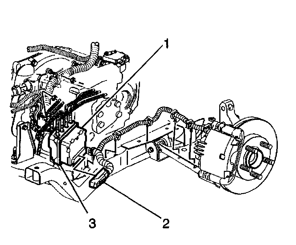

Pic 4
11. Remove the BPMV retaining nut (2).
12. Remove the EBCM/BPMV assembly (3) from the vehicle.

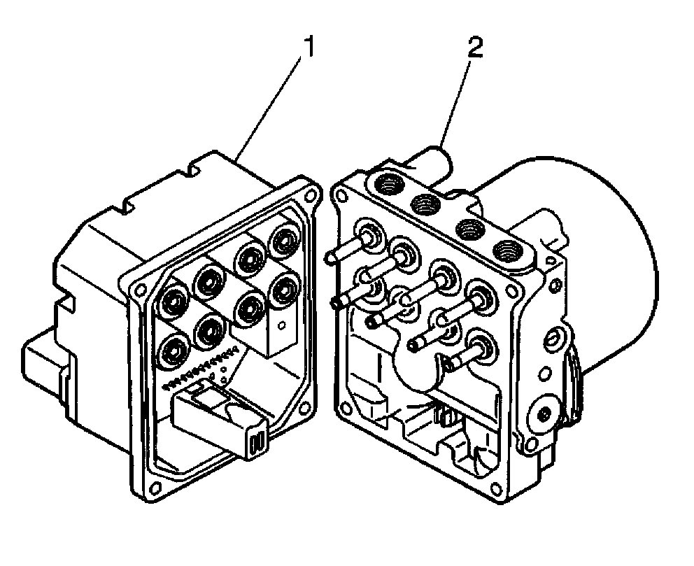

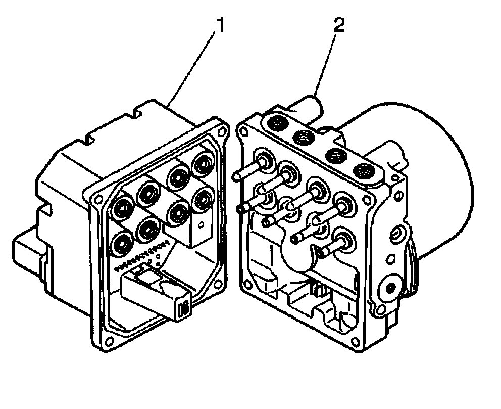

Pic 5
13. Remove the EBCM (1) from the BPMV (2).
Installation Procedure
pic 6
Notice: Refer to Fastener Notice in Service Precautions.
1. Install the EBCM(1) to the BPMV(2).
Tighten the four screws that connect the EBCM(1) to the BPMV(2) to 5 Nm (44 inch lbs.).

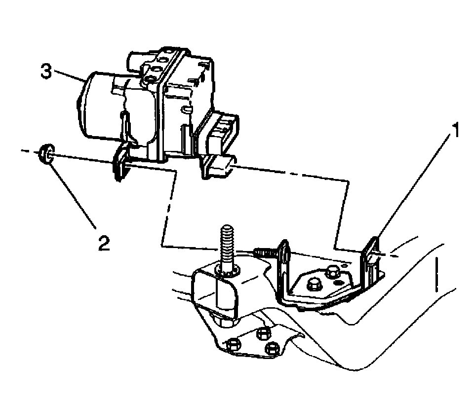

3. Install the BPMV retaining nut (2).
Tighten the retaining nut to 10 Nm (7 ft. Lbs.).

5. Push down the lock tab (1) and then move the sliding connector cover back in the home position to lock.
6. Insert the CPA (2) back into place.

Pic 10
Caution: Make sure brake pipes are correctly connected to brake pressure modulator valve. If brake pipes are switched by mistake, wheel lockup will occur and personal injury may result. The only two ways this condition can be detected are by using a Scan Tool or by doing an Antilock stop.
10. Connect the master cylinder brake pipes (1) to the BPMV (3).
Tighten the brake pipe fittings to 23 Nm (17 ft. Lbs.).
11. Connect the caliper and wheel cylinder brake pipes (2) to the BPMV (3).

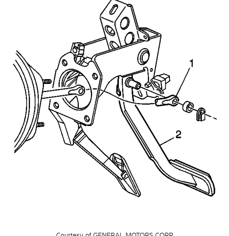

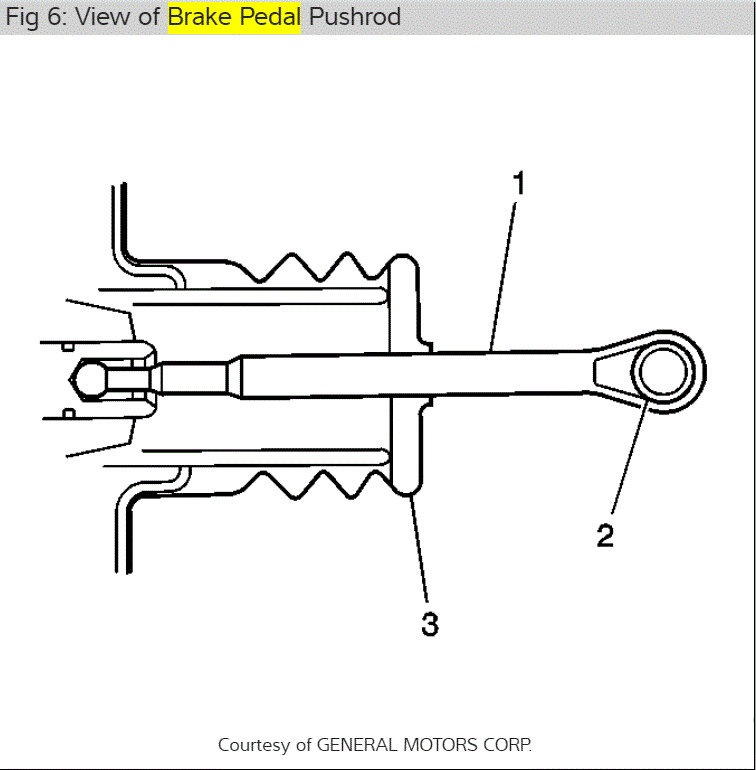

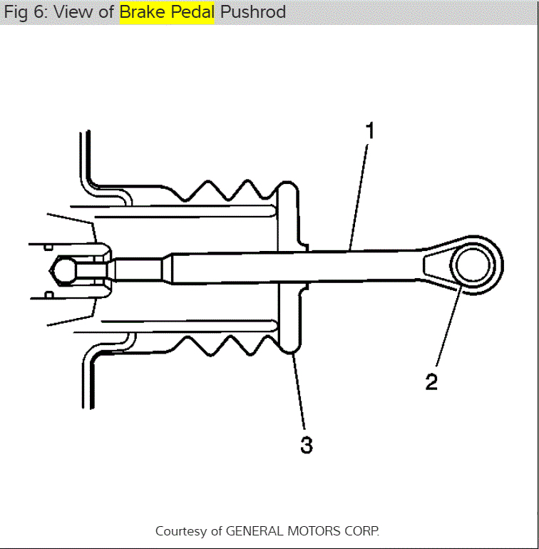

Everything you said makes total sense. I rechecked and see nothing for auto bleeding the module, so I have to suspect it doesn't exist on this model. I checked both Alldata and Mitchel 1.
I attached a few pics below. The first shows the push rod between the brake pedal in the car and through to the booster. Make sure nothing is bend or not seated properly. However, I doubt this is the issue because you mentioned by plugging the MC you get a good pedal. The second pic simply is from a different point of view.
I know there are systems which require the module to be actuated via a scanner. I will look further into that. It doesn't indicate it for this vehicle, but what you describe sounds like there must be an issue within the module. If you open the lines out from the module, is there any air? Also, some of these had bleeders on the module unit itself. I don't think this one did, but I'm asking just in case.

I will check that push rod today. And also when I had the master connected to the ABS with all 4 outputs blocked I had a hard pedal with little travel then I hooked up the left front because it is the shortest and the pedal went to the floor so I figured I had a lot of air in that line so I started to bleed it and it did have air but when I got all the bubbles out it still went to the floor. Now I was bleeding by myself with the bottle method where you have fluid in a bottle and a clear hose attached to the bleeder valve and you open the valve and pump the brakes till you see no more bubbles in the hose. I have never used that method before but my assistant (wife) was just about sick ask I was working on this car. But now that I think about it after I did that I noticed some wetness around the ABS that I didn't see before. It is in a tight spot so I am going to take that back out today and compare it to my old one. Then start over again.
Sunday, March 29th, 2020 AT 5:03 AM
KELLY2986
  • 6 POSTS
Hey Joe.
I checked the push rod and its not bent and fits tight to the master cylinder. So I blocked off master cylinder after bench bleeding again and reinstalled it to the booster. Then I check pedal travel and it was minimal with hard pedal so I am pretty sure I am good to this point. I removed the Abs again and compared it to my old one. There is no place to bleed it but I noticed the used one I ordered has a different part number than the original. When I ordered it they say it fits my Alero but the one they sent part number is for a Chevrolet Grand Am. They look exactly alike but since I have had it in and out several times some of the threads look stripped. So I emailed the company and they are sending another free of charge. Nice of them to do that. So I will let you know what happens when I install it and see if maybe I had a leak there I didn't notice but don't think that was the case.
