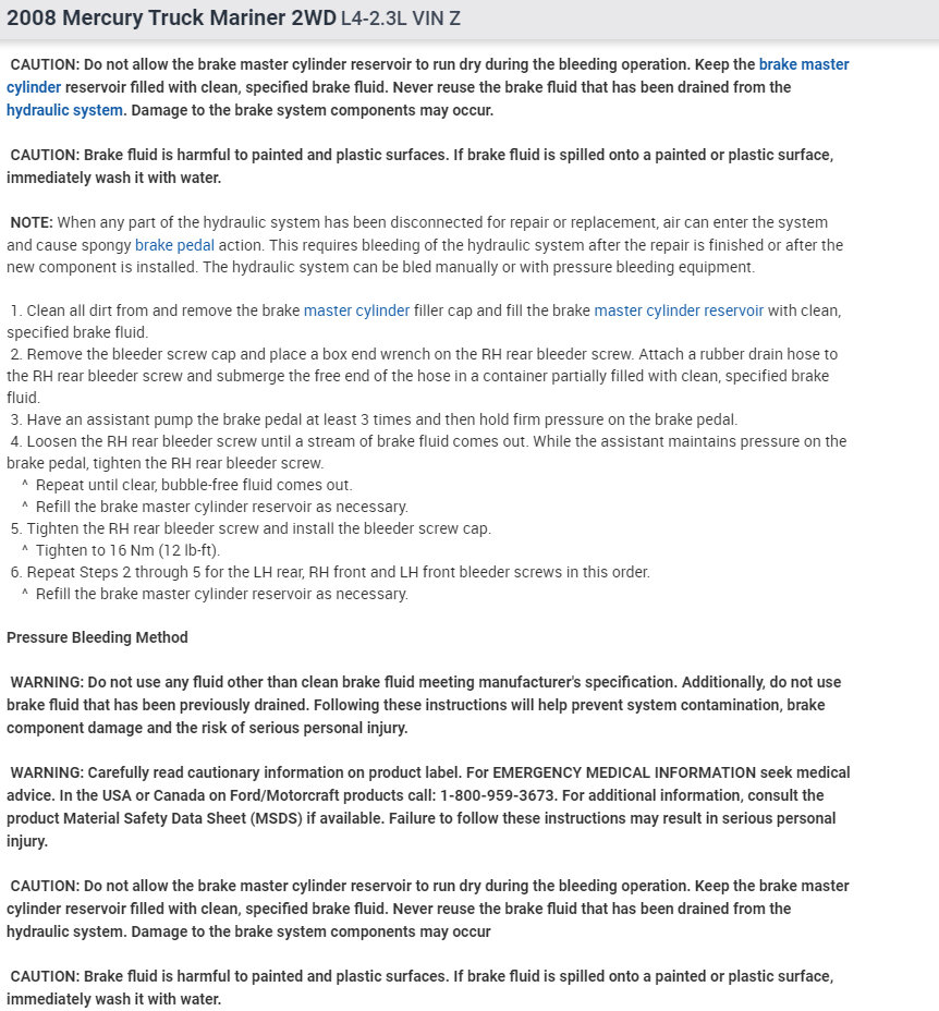

I replaced the calipers and bled the brakes, the car brakes well when I press the pedal two times. But if I wait a few seconds, the pedal goes all the way down. With the car running.
The ABS pump was working fine before replacing the calipers.

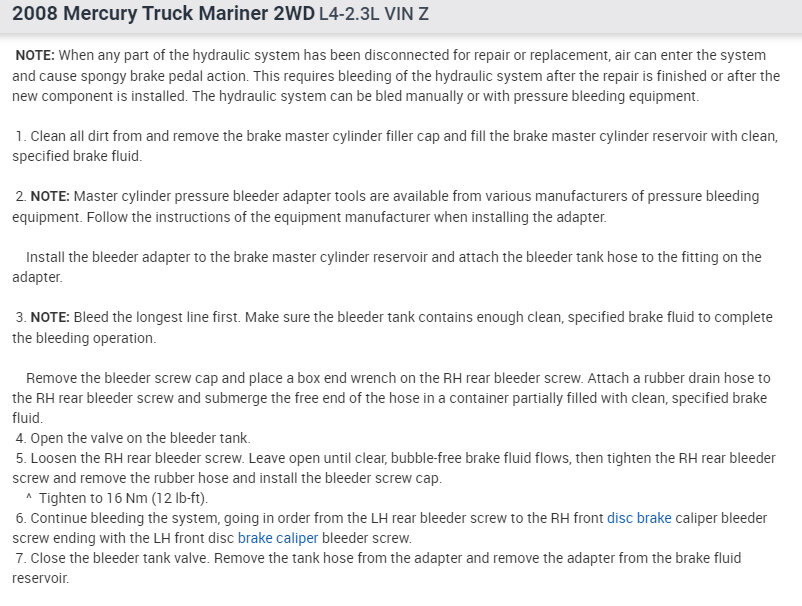

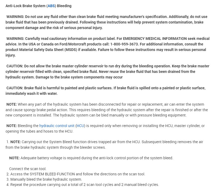

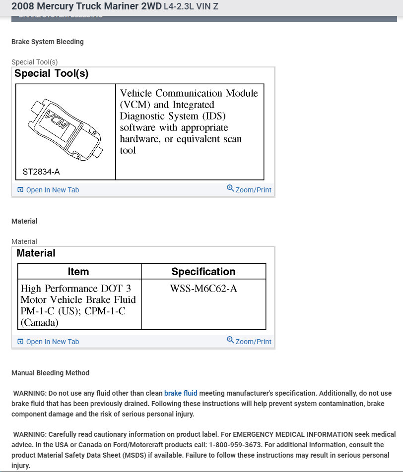

This vehicle does require a scan tool to properly bleed the ABS.
The scanner allows you to open the ABS valves and have a proper bleeding process.
Here is a helpful guide:
https://www.2carpros.com/articles/how-to-bleed-or-flush-a-car-brake-system
I have attached the procedure below for your reference.
Let me know if you have any questions.

We already use the scanner to run an OBDII controlled bleeding process. I've already did it two times, and it's still not working properly.
Is it possible that the HCU is damaged? Somehow the pressure releasing valve went all the way always open?

Are you getting any ABS error codes? Typically is the module is bad it will throw code.
Nov 1, 2022 at 3:25 PM
ELIESER PEñA REYES
No error codes. Looks like the HCU. Replaced the ABS HCU and is working fine now.
