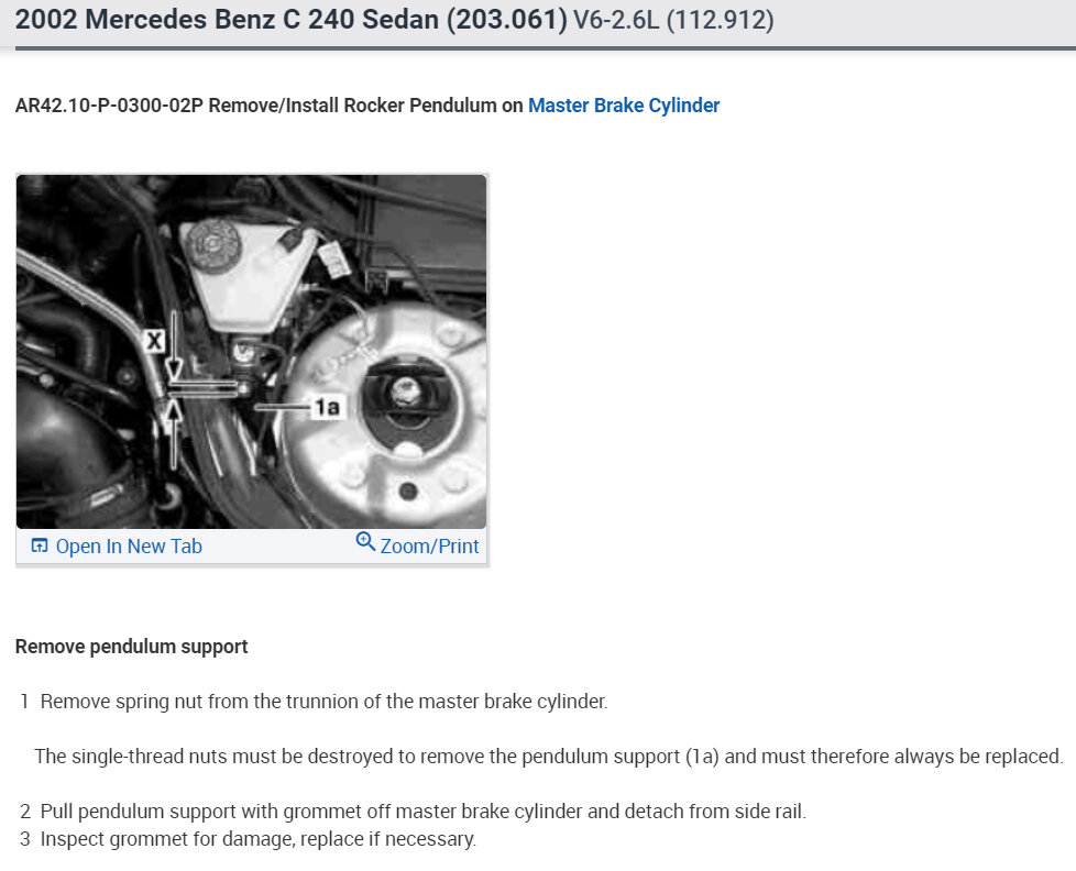

How do i eliminate whether this is a master cylinder or a booster issue?
Oct 9, 2023 at 12:07 AM
  • 55,399 POSTS

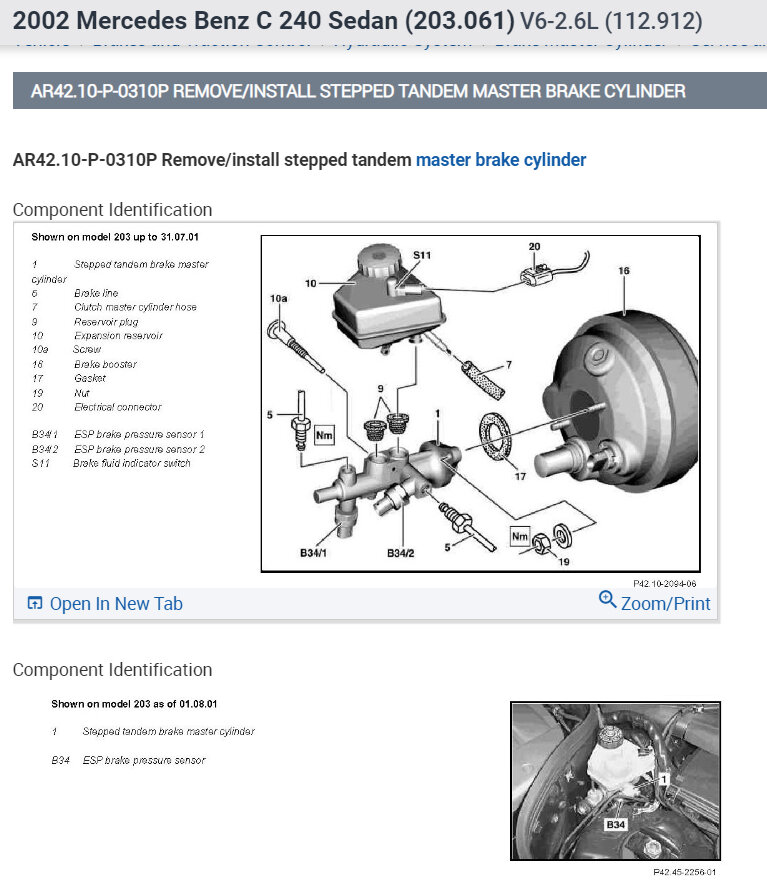

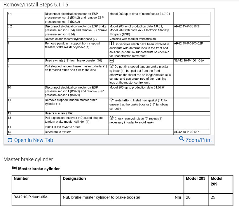

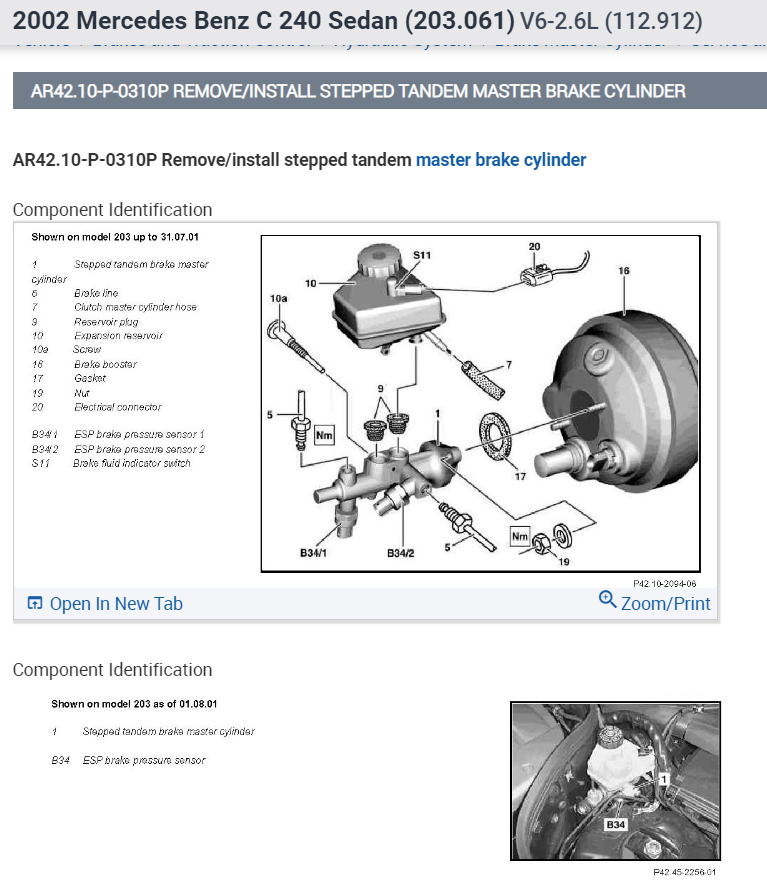

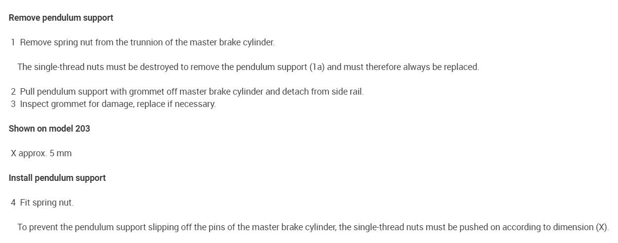

With the engine off you can pull the brake booster vacuum line and if you don't hear vacuum escaping the booster is probably bad, here is a guide and video to help you change out the brake master cylinder with instructions below. I assume the brake master is full of fluid?
https://www.2carpros.com/articles/brake-pedal-goes-to-the-floor
And here is a generic guide to help you step by step with instructions in the diagrams below to show you how on your car:
https://www.2carpros.com/articles/how-to-replace-a-brake-master-cylinder
This video will help show you how to bleed the master before installation, which is a must:
https://youtu.be/WDxvEQrMkBg?si=0InuIrmcXr2e5OAx
Check out the images (below). Please let us know if you need anything else to get the problem fixed.

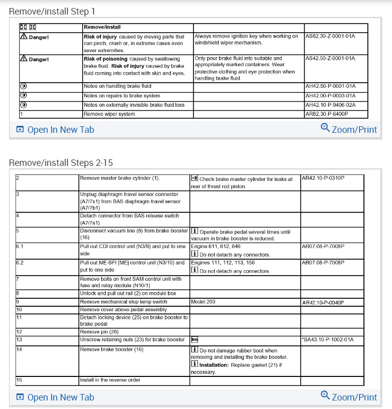

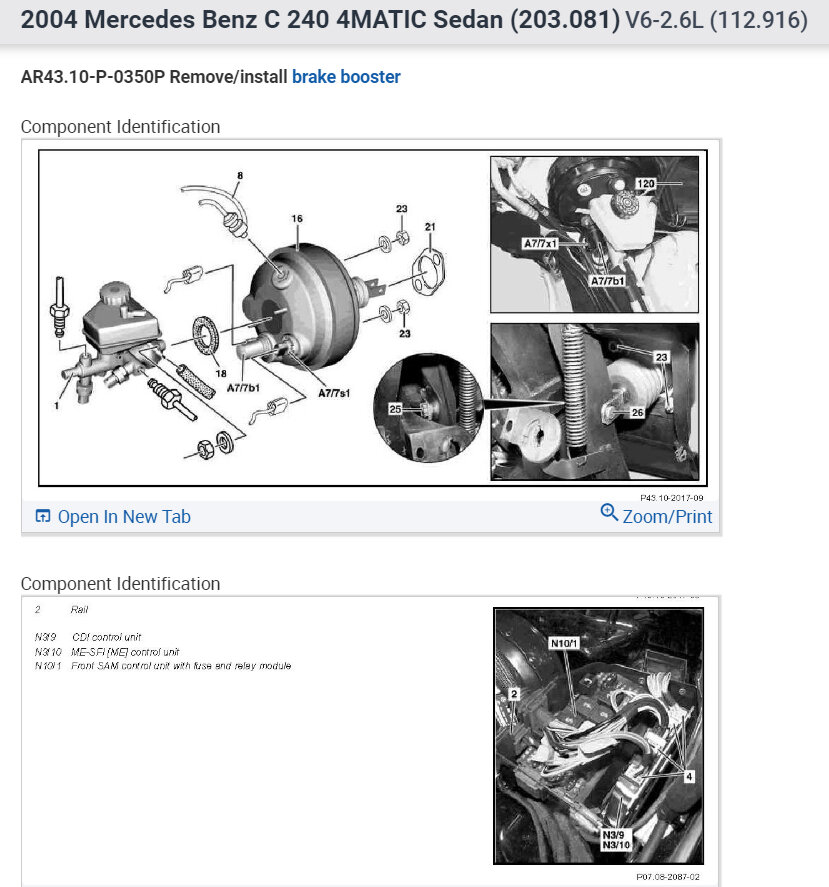

I removed the tube from the booster and it didn't have any vacuum escaping.
Oct 9, 2023 at 3:43 AM
  • 55,399 POSTS
Then the booster is bad, here is how to change it out. Check out the images (below). Please let us know if you need anything else to get the problem fixed.

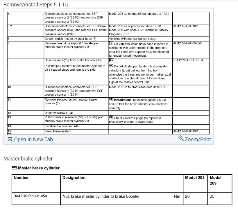

Oh, i see. I only heard like a very tiny small amount not what i would expect based on previous experience, extremely tiny.
Oct 10, 2023 at 2:20 AM
  • 55,399 POSTS
Okay, then I would say the master cylinder is bad or you have a stuck caliper slide so I would check those as well.
