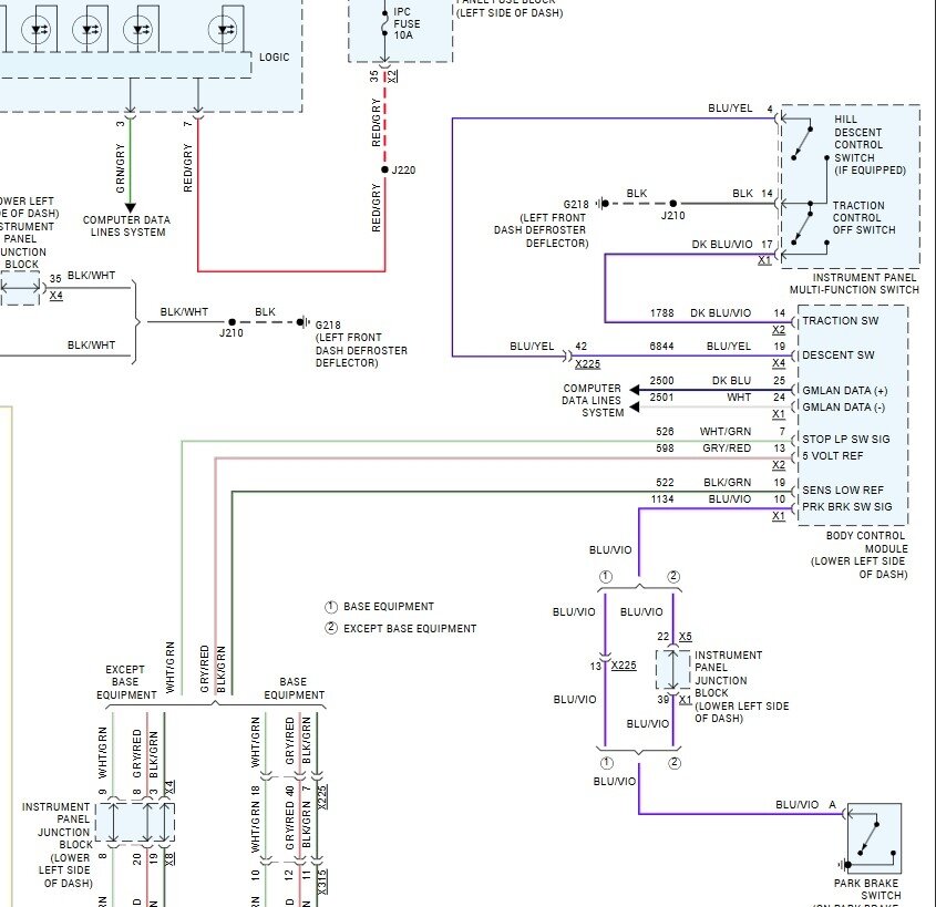

When driving, my brake lights do not turn on unless brake pedal is pressed at least half way. When using a scan tool, I can see the ECM voltage change state from 1V (not pressed) to 2V when pressed. It seems like there is a communication problem with the BCM. How do I determine if there is a wire harness problem or BCM problem?

I have a Stabilitrak and Steering Assist warning light/message. The following codes are present too, U0073-00, U0077-00, C0277-4B.

There should be a larger voltage change. The first thing I would do is a brake position relearn. You use the scan tool to go into the BCM functions and enter the recalibration menu for the sensor then follow the prompts and it will reset the parameters. Now test and see if it is working correctly. If it still isn't then I would Remove the wire connector from the sensor and look for corrosion. If there is no corrosion, the easiest way to test would be a new sensor. They do fail quite often. If you have the adjustable pedal assembly, look at the harness to the pedal frame for chaffing.

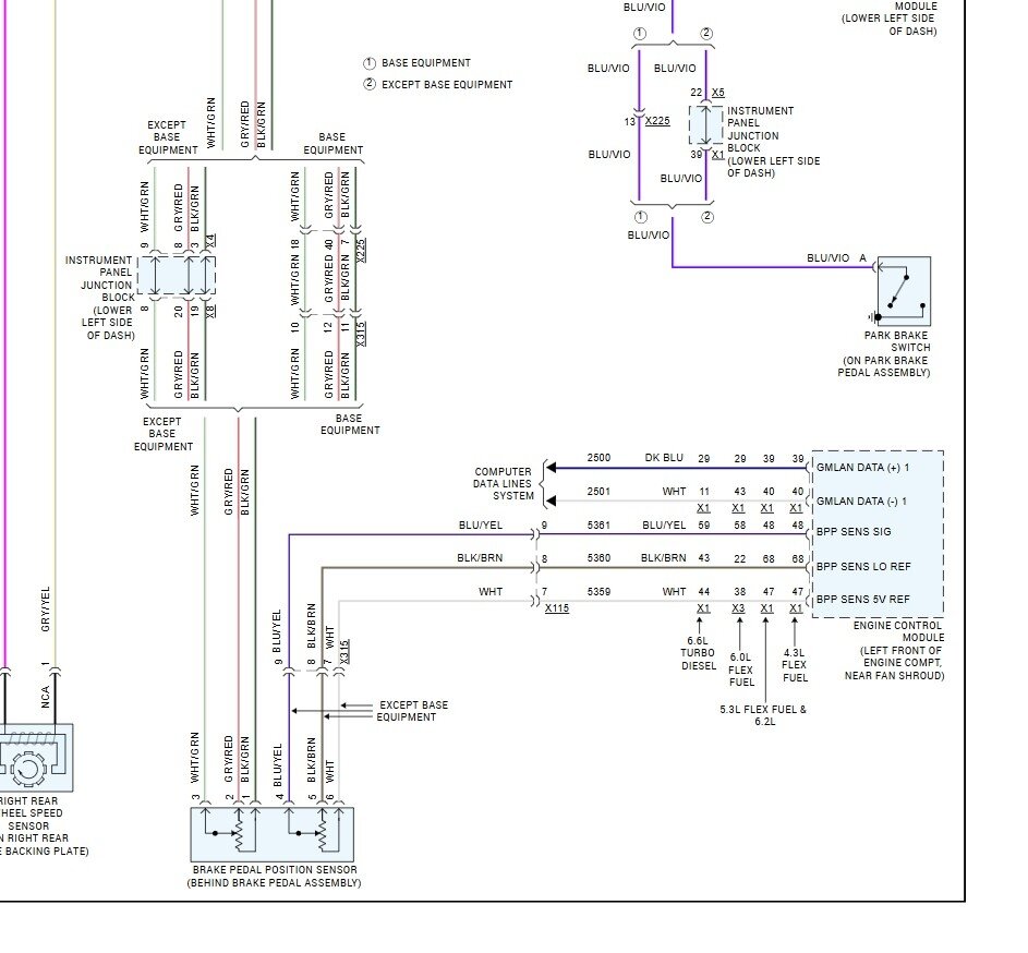

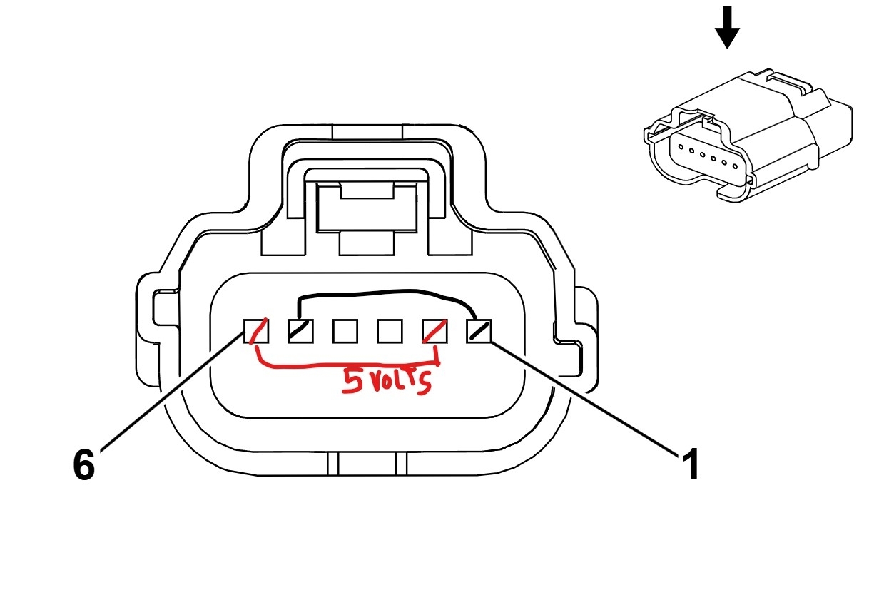

So, we can go with a bit more old school. Attached are the wiring for the sensor. It is essentially 2 potentiometers in one housing. If you pull the connector off and use a meter for testing, you should measure 5 volts on the White wire at pin 6 and at the gray wire with red stripe at pin 2. There should be a ground at pins 1 Black w green and 5 black with brown.
Pins 3 and 4 are the signal voltages out to the BCM and the ECM. Probably the easiest way to test those would be to measure the voltages by back probing each pin with the sensor installed. To do that you need something like a sewing needle that you push into the connector to hit the metal pins from the outside, it allows you to measure the item with it in circuit and powered.

Now you measure the 5 volts at the pins with it disconnected. Measure again with it connected, do you still have the same voltage? If not, there is a problem between the connector and the BCM or ECM, to tell which just look at the wire color the White wire comes from the ECM, the gray with red comes from the BCM. Similar testing with the grounds. Then check the signal outputs. Those should show a voltage between 5 volts and ground if they can go full travel, but most don't move that far (that is what the reset does, it erases the BCM and ECM values for upper and lower voltages so they can learn the voltages from the actual sensor installed.) So, you measure the voltages from the two signal pins. Then go to the ECM and see if it has the same readings at its end. Same with the BCM. If you have the 5-volt reference at the sensor with it plugged in, and the grounds are good at the sensor. You should be able to determine if it's the sensor, the wiring or the BCM or ECM using the numbers you get.

I measured 5V with the wire harness disconnected. The back probing was challenging due to the work area and novice skills. I didn't get any readings from back probing, so I'm going to have to try again.

Hello. I broke down and brought it to a local shop with a better scan tool. They had to reprogram the BCM. I'm not sure what would have caused it to fail or get corrupted, but all the messages, traction control light and codes are now green.
