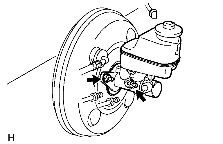

COMPONENTS (Part 1)
pic 1

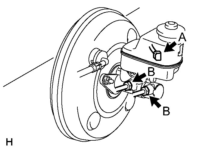

COMPONENTS (Part 2)
pic 2

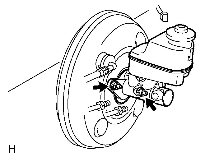

(a) Release the vacuum pressure in the brake booster as follows.
(1) Stop the engine.
(2) Depress the brake pedal several times.
pic 3

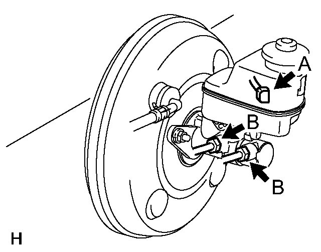

(b) Disconnect the brake fluid level warning switch connector labeled A.
(c) Using SST, disconnect the 2 brake lines labeled B from the master cylinder.
SST 09023-00101
pic 4
(d) Remove the 2 nuts.
(e) Pull out the master cylinder from the brake booster.
NOTICE:
^ The master cylinder and piston are designed so that the piston can easily fall out. Prevent this by making sure that the tip of the master cylinder points downward when handling the master cylinder.
^ Make sure foreign matter does not attach to the master cylinder's piston. If foreign matter attaches, clean it off with a cloth. Then apply lithium soap base glycol grease to the entire outer circumference contact surface area of the piston.
(f) Remove the O-ring from the master cylinder.

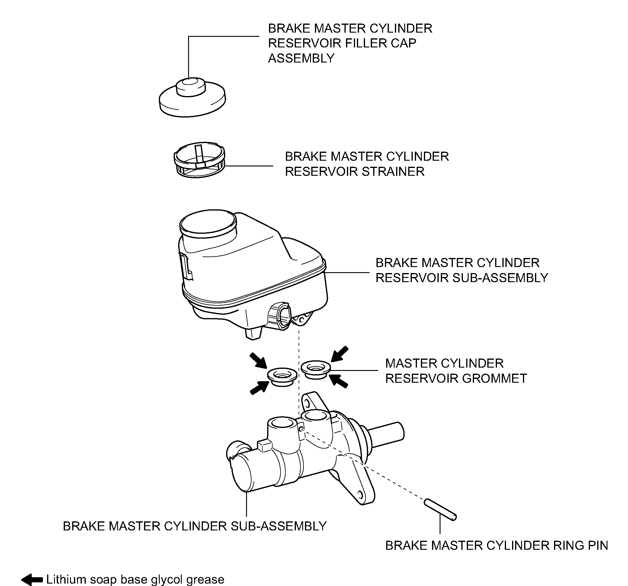

(a) Install a new O-ring to the master cylinder.
pic 5

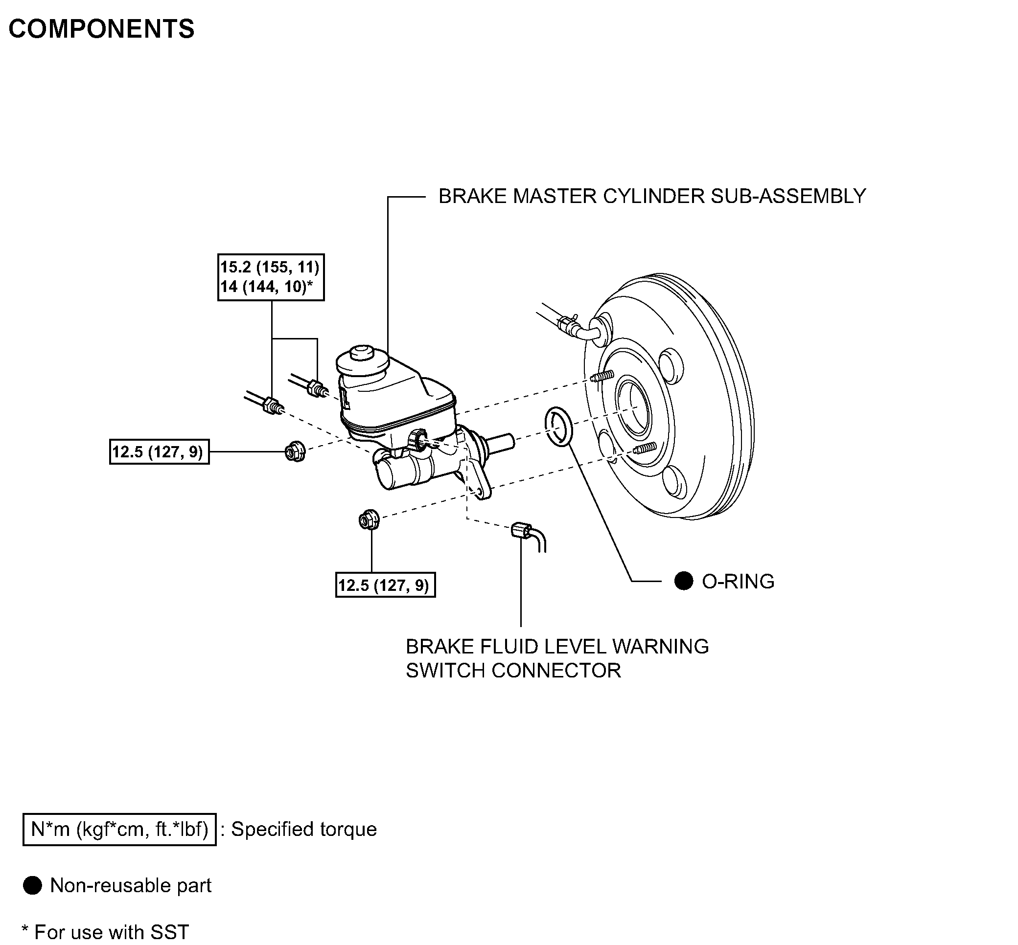

(b) Install the master cylinder to the booster with the 2 nuts.
Torque: 12.5 Nm (127 kgf-cm, 9 ft. lbs.)
pic 6
(c) Using SST, connect the 2 brake lines labeled B to the master cylinder.
SST 09023-00101
Torque:
15.2 Nm (155 kgf-cm, 11 ft. lbs.) without SST
14 Nm (144 kgf-cm, 10 ft. lbs.) with SST
HINT: Use a torque wrench with a fulcrum length of 30 cm (11.81 inch).
(d) Connect the brake fluid level warning switch connector labeled A to the master cylinder.
