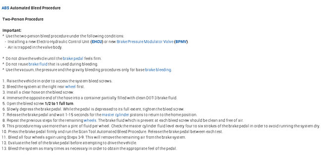

Brakes worked fine until I changed front brake pads. I bled both front brakes at the bleeder. I lost most stopping ability. It would stop with brake to the floor. So I changed the back brakes. Bled all four brakes and lost all pressure in pedal and will not stop at all. I bled three large bottles of fluid through the master cylinder and still nothing. I do not see any leaks. I tried a new master cylinder still no brakes. Now on my brake caliper there is a round medal ring missing from the piston. But it does not leak. Can a bad brake caliper piston cause the pedal to go to the floor? When car is off I can pump brakes and get pressure in pedal. But lose pressure when I start the car. Please help this mamma.

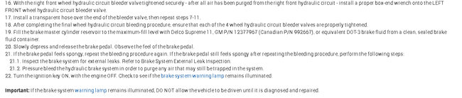

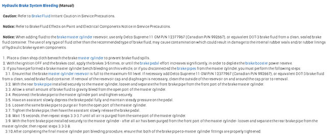

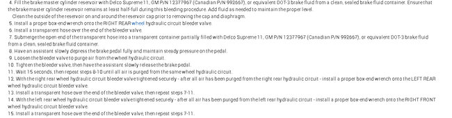

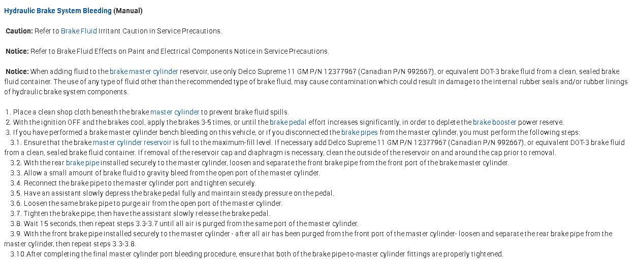

If you have introduced any air into the hydraulic system at all (including pushing back the caliper pistons to accommodate new pads) you will need to bleed the brakes at all four wheels. This ensures that the air is properly bled out of the ABS system. Attached is instructions that you can use to bleed the brakes, and you will need to follow the order the directions say or you will waste your time. Most ABS systems require the use of a specific sequence when bleeding the brakes, and it varies from car to car. If the first procedure does not work, move to the next attached procedure.
Keep us posted on how it goes!
William
