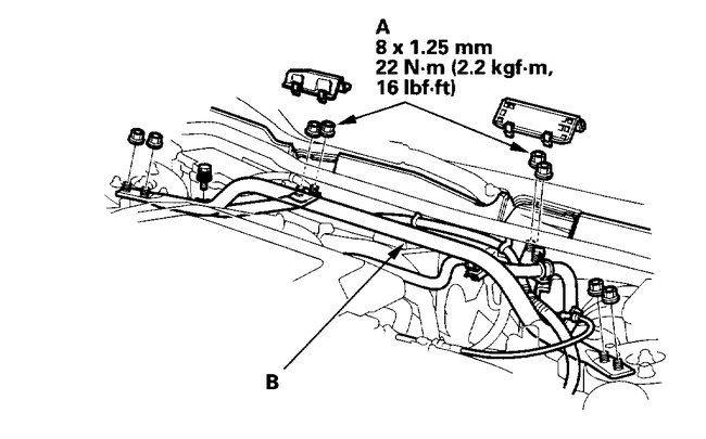

Picture 1
1. Remove the 8 mm flange nuts (A).
2. Remove the strut brace (B).

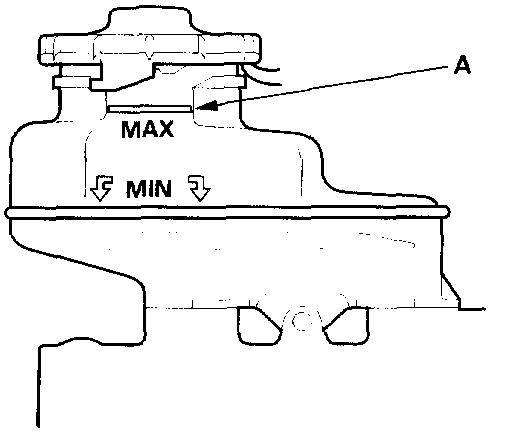

Picture 2
3. Disconnect the brake fluid level switch connectors (A), and remove the reservoir cap (B).
4. Remove the brake fluid from the master cylinder reservoir (c) with a syringe.

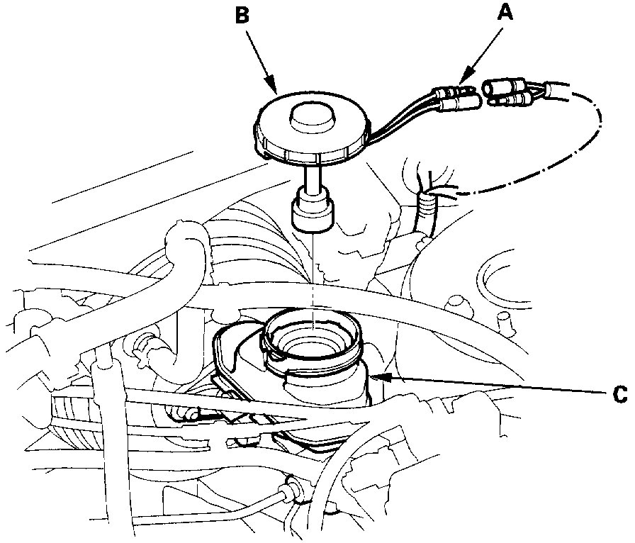

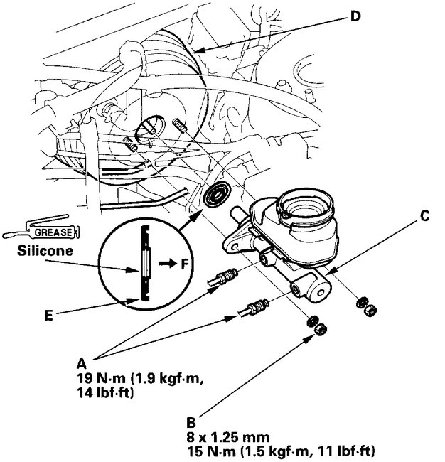

Picture 3
5. Disconnect the brake lines (A) from the master cylinder. To prevent spills, cover the hose joints with rags or shop towels.
6. Remove the master cylinder mounting nuts (B) and washers.
7. Remove the master cylinder (c) from the brake booster (D). Be careful not to bend or damage the brake lines when removing the master cylinder.
8. Remove the rod seal (E) from the master cylinder.

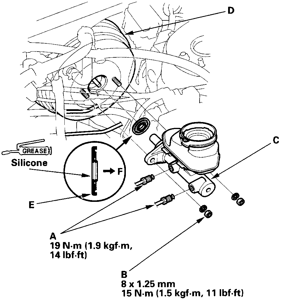

9. Install the master cylinder in the reverse order of removal, and note these items:
^ Replace all rubber parts with new ones whenever removed.
^ Coat the lip of the new rod seal with recommended seal grease in the master cylinder set.
^ Install the rod seal onto the master cylinder with its grooved side (F) toward the master cylinder.

- The reservoir on the master cylinder must be at the MAX (upper) level mark at the start of bleeding procedure and checked after bleeding each brake caliper. Add fluid as required.

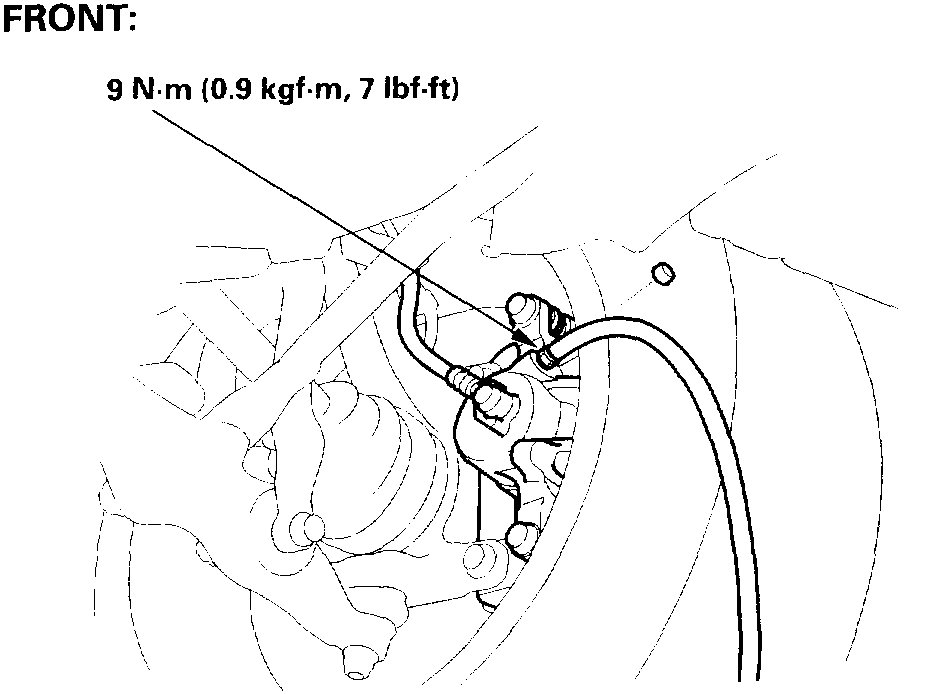

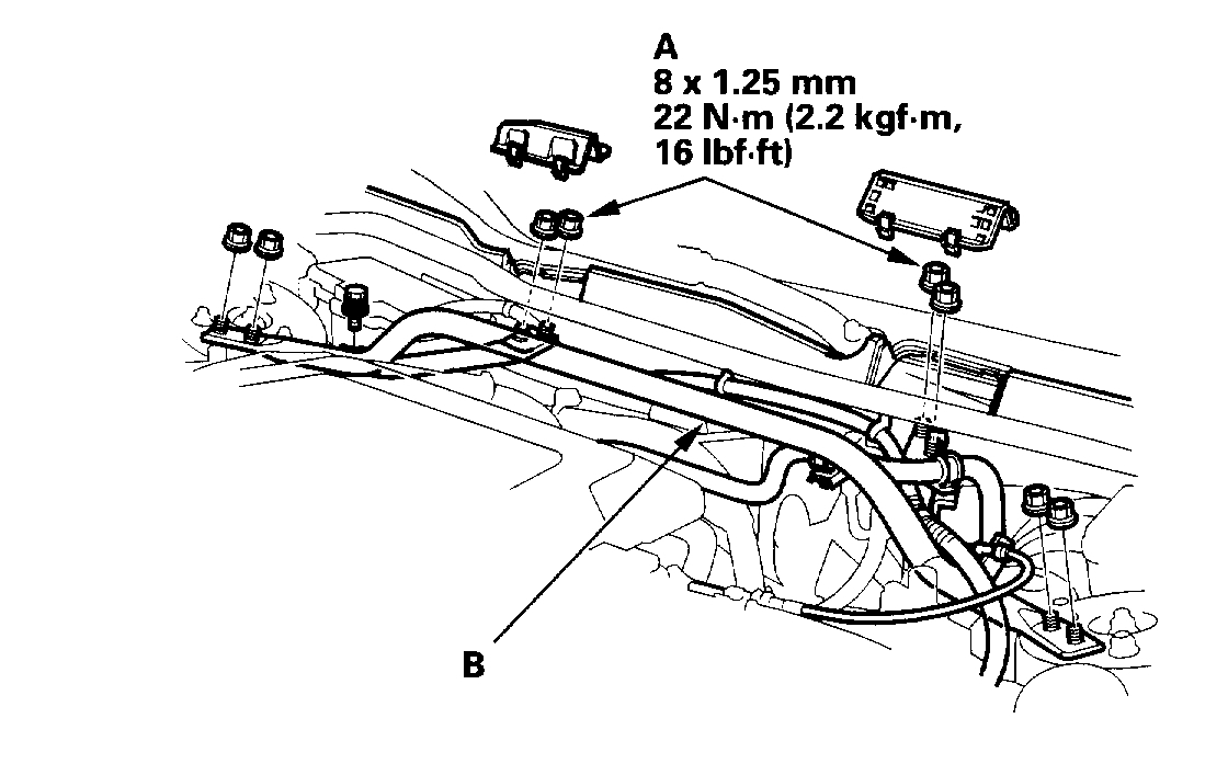

Picture 4
1. Make sure the brake fluid level in the reservoir is at the MAX (upper) level line (A).
2. Attach a length of clear drain tube to the bleed screw.
3. Have someone slowly pump the brake pedal several times, then apply steady pressure.
4. Loosen the left-front brake bleed screw to allow air to escape from the system. Then tighten the bleed screw securely.

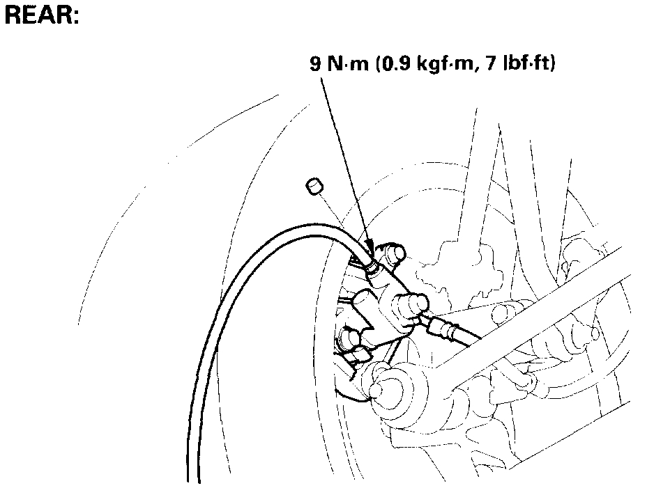

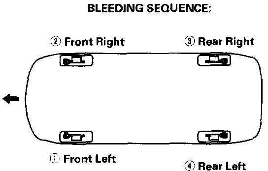

Picture 5
5. Repeat the procedure for each wheel in the sequence shown until air bubbles no longer appear in the fluid coming out of the drain tube.
6. Refill the master cylinder reservoir to the MAX (upper) level line.

Picture 5 Again
2. Use the bleeding sequence below, and follow the bleeding instructions that come with your pressure bleeder.
Picture 6
Picture 7
Bleed Screw Locations
