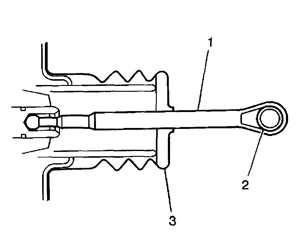

What is the likelihood that the cable that connects to the brake pedal could be disconnected upon impact with a tree at 30-35 mph?

If you are referring to the primary brakes, there is no chance. The brake system is hydraulic and doesn't have a cable. If, on the other hand you are referring to the parking brake, it has a cable. Here are two guides to help you service the parking brakes.

It appears that the first report was not quite accurate. The rod that connects to the hydraulic system? Was bent. Driver was going roughly 30-35 mph and the brakes completely failed after impact it was clear the driver had tried to apply the brakes as the pedal was still to the floor.
What could have been the cause for the brakes to fail?

If the pedal was to the floor, it could have been a few things. First, no brake fluid. If there was a leak, the fluid would have drained from the system. Second, a rusted steel brake line may have ruptured when the brakes were applied. Third, a rubber brake hose which attached to the brake calipers may have ruptured. Also, the master cylinder could have failed. The interesting thing is the rod that you refer to. There is a rod that attached to the brake pedal and goes to the master cylinder. Honestly, I have never see one bend. Could he have hit the brakes that hard?
Without being there, it is hard to determine the cause. If, however, you have access to the vehicle, take a look under it for any wet spots which may indicate a brake fluid leak.

No leaks, still had fluid, no rusted brake lines or ruptured hoses. The brakes were not functioning and the female driver after several failed attempts to apply the brakes stood on the brakes using the steering wheel for leverage.. There were absolutely no skid marks on the road and the brake pedal was still to the floor after impact.

Honestly, then either the rod to actuate the brakes broke, one of the mounts for the brake pedal broke, or the master cylinder failed.

The accident report stated that a cable that connects to the brake pedal was disconnected. Is that possible?

There is a cable to the parking brake pedal, but to the brake pedal there is a steel rod. Yes, it can come disconnected, but that is really unlikely. If you look at the picture I attached, it shows the push rod that I mentioned. The end that has the number 2 pointing to it is the part that is in the vehicle that attaches to the pedal.
Let me know if that helps.
