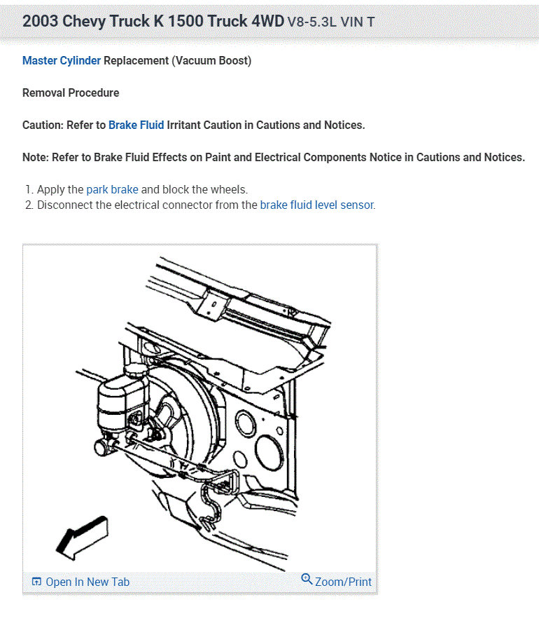

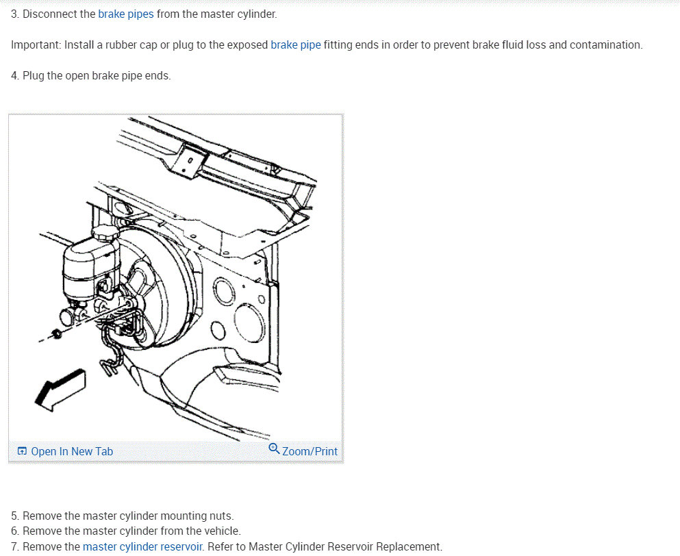

If there are no leaks, the master cylinder is likely the problem. Take a look at this link:
https://www.2carpros.com/articles/brake-pedal-goes-to-the-floor

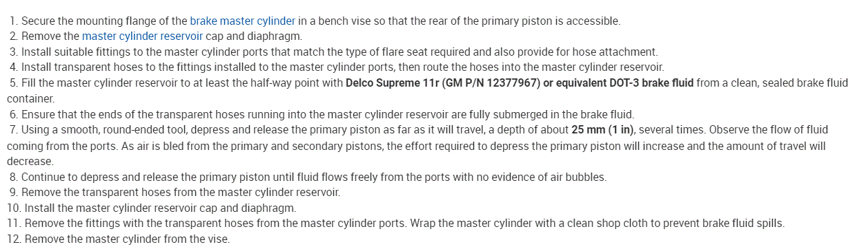

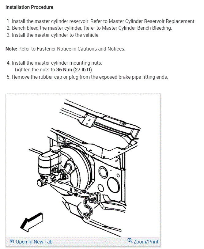

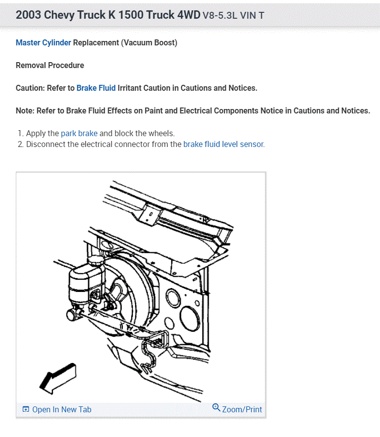

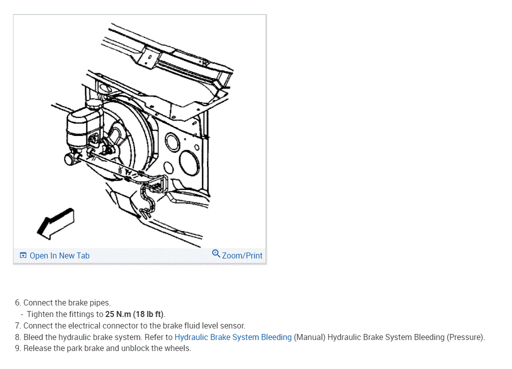

If you feel it mirrors what you experience, here is a link that explains in general how it's done:
https://www.2carpros.com/articles/how-to-replace-a-brake-master-cylinder

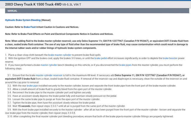

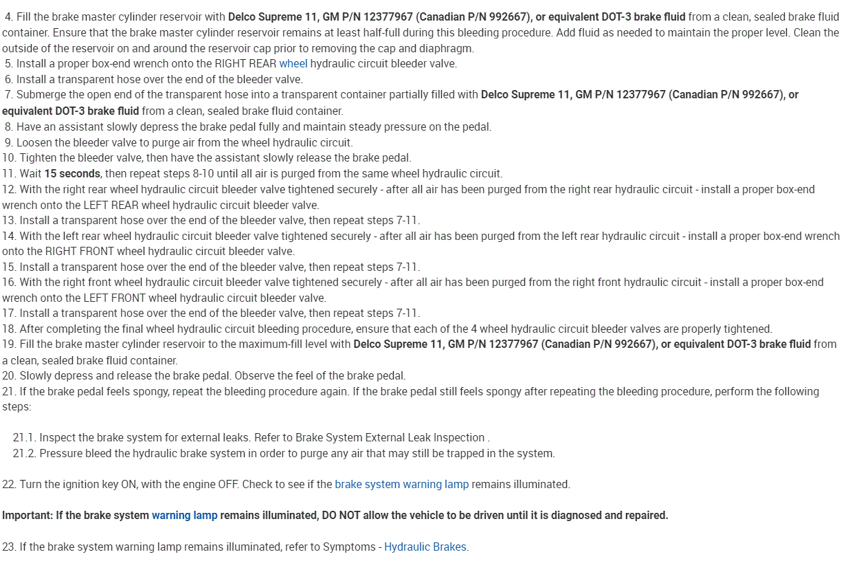

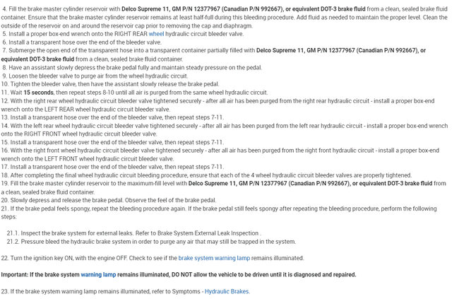

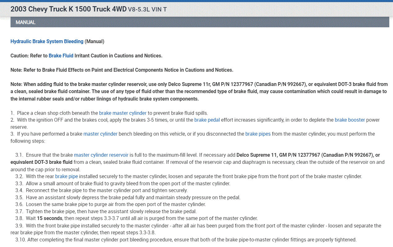

Because you are replacing the master cylinder, chances are you will need to perform an automated bleed on the ABS module. That will require a scan tool that can communicate with the ABS module.

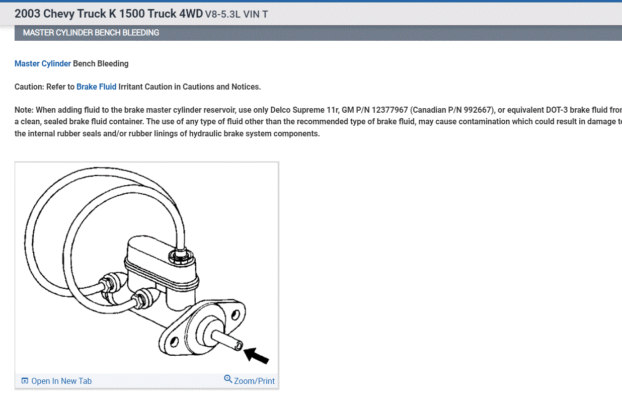

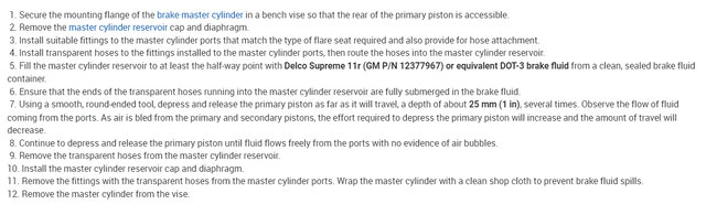

The attachments below are the directions specific to your vehicle. You will need to manually bleed the system. I attached the directions for that as well.
One other thing, make sure to bench bleed the new master cylinder as explained in the link I attached.
Let me know how things turn out for you or if you have other questions.
