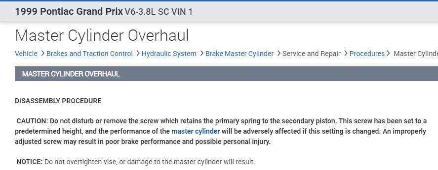

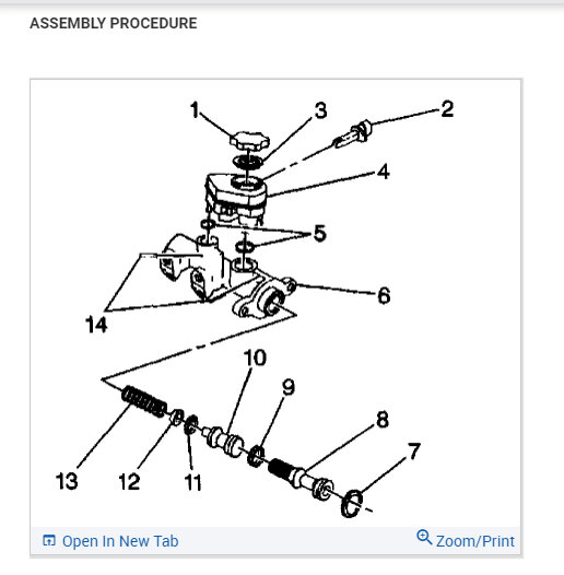

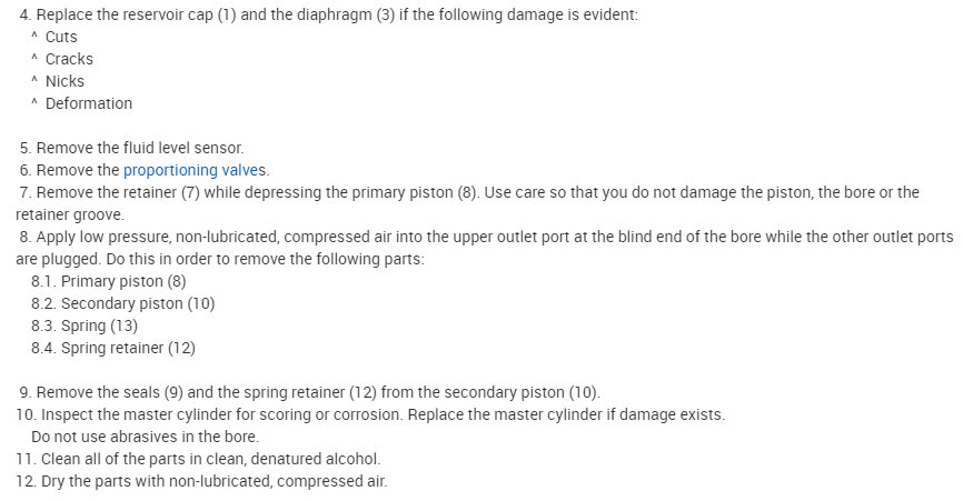

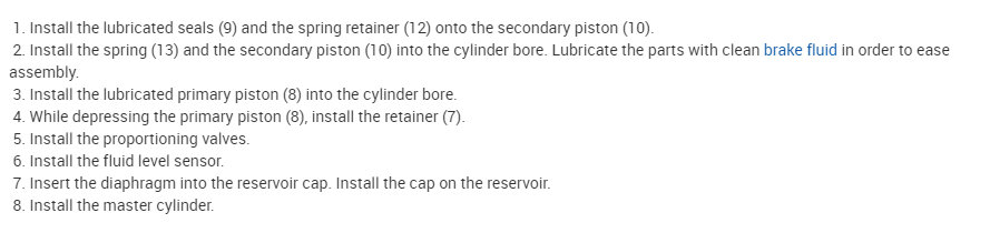

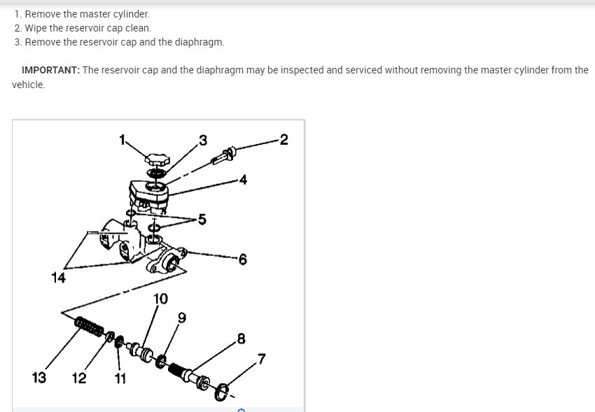

Also, if you want to repair/rebuild the one you have, I attached the directions below specific to this vehicle. If you look at the exploded view, at the rear of the primary piston there is a seal (number 8 in the picture). That is what has failed.

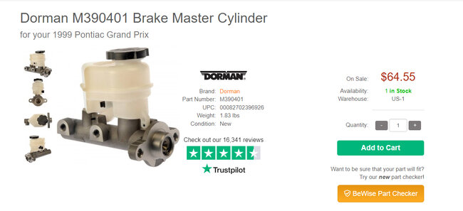

When you get one, make sure it is a good brand. I use a lot of Dorman parts at the shop. I don't work for them and trying to sell their products. I've just had good luck with them over the years.
I attached a pic below.
Let me know how things work out for you.
See pic below.
