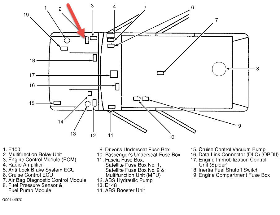

Passenger side brake light works but not the driver side and both lights do not work when truck is in motion. Bled the brakes because the brake pedal would almost reach the floor. Stops a lot better now but still a bit weak. The ABS warning light stays on. Would like to get the brake light working properly first thanks.

check to see if power is going to light and check ground maybe loose or corroded. as for the ABS issue it needs to be scanned for codes.

Brake switch has power but the harness not sending power to the brake lights. Is there a relay connecter that could be fried somewhere? Blinkers and tail lights work just no brake lights and ground wires are good still.

I tmay be the multi function unit by fuse box that is screwing up. which they show at right rear of engine compartment. see pic.
