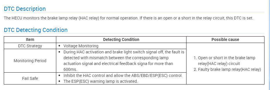

All 3 brake lights don't work and the ESC dash light stays on. Cruise control does work.

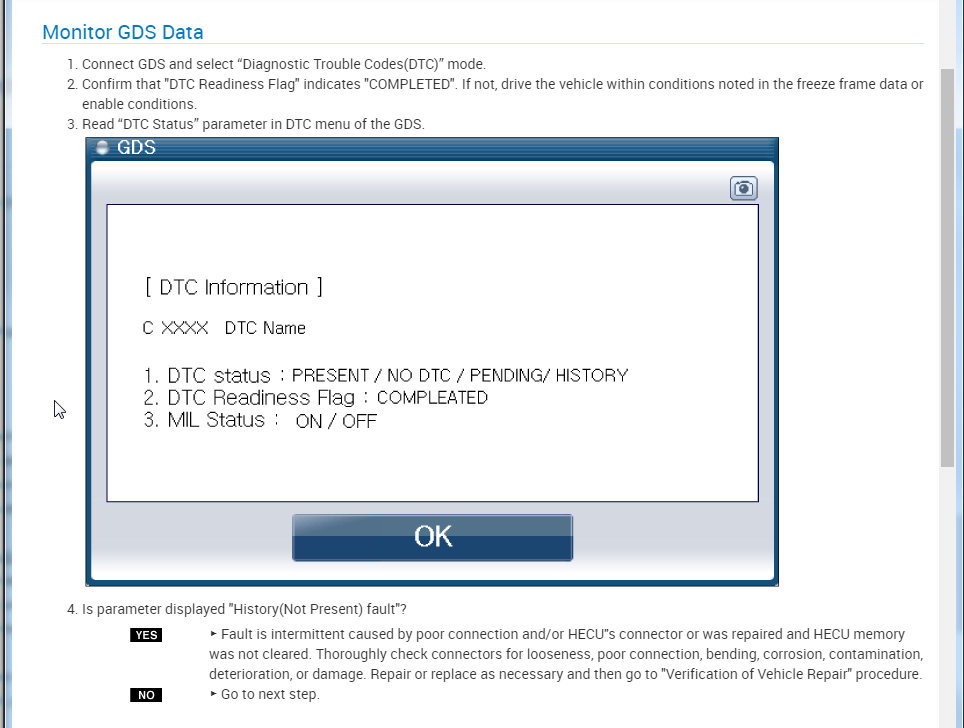

This could be a number of things. We need to start with pulling codes.
Here is a video on how to pull airbag and ABS codes. You will need to be able to access the abs module for codes in order to pull them all.
https://youtu.be/gnSGfEqrf_w
Let's start with the codes from this system and go from there. They may all be related or the ESC light could be different from the brake lights and Cruise not working.
Let me know what codes you are seeing and we can go from there. Thanks

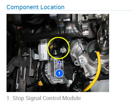

It's the stop signal relay assembly.

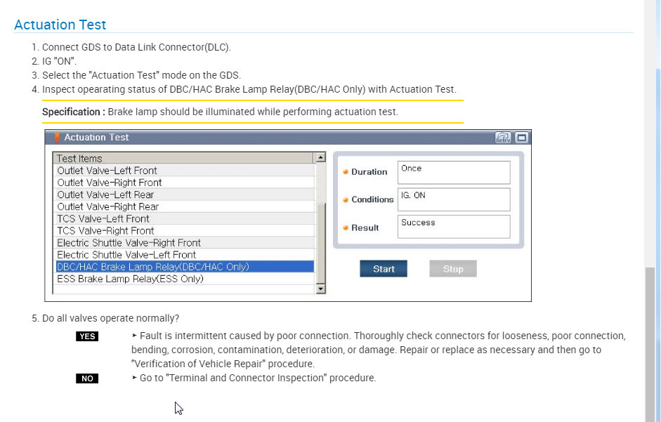

Okay. That helps. Do you have the actual code that he found? I will post the testing and all the info about it. Thanks
May 20, 2020 at 12:22 PM
LTSBRBL
  • 5 POSTS

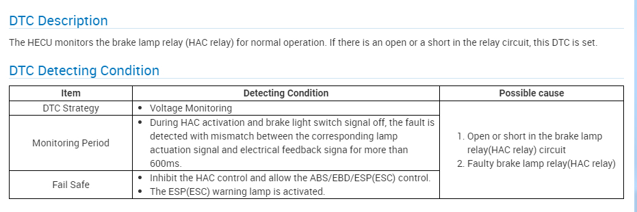

C2130 .
May 20, 2020 at 1:33 PM
Here is the info for this code. I just want to clarify if this was replaced and it fixed the vehicle or it hasn't been done yet? Thanks for the updates so far.
