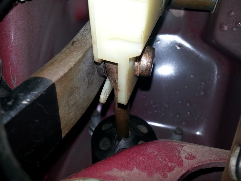

All three brake lights no longer work.
All lights still work as do the turn signals.
Since the upper center light does not work either would that indicate the brake switch on the pedal?
If so, how does that clip come off to remove the switch?

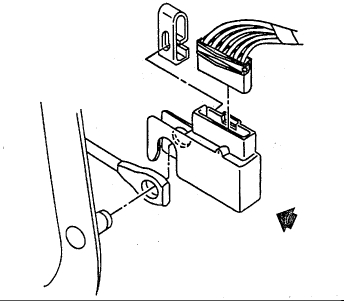

Yes, that would probably indicate a problem with the brake light switch. As for how to take that clip off, just stick a decent sized flat head screwdriver in the "U" end of the clip and turn it a bit to spread the "U" and then, while still keeping the screwdriver turned, slide the clip off. It may take a few tries, and is unnecessarily annoying, but it will come off. The images below decently illustrate what you are dealing with.
Also, here is a decent YouTube video on the subject: https://www.youtube.com/watch?v=iv2D_nm8Jck
And another one: https://www.youtube.com/watch?v=K8k5gSXAlJc
Please let us know how it goes for you.

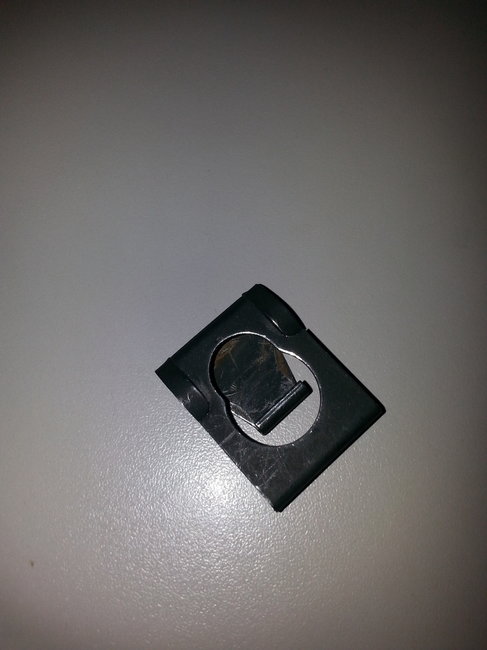

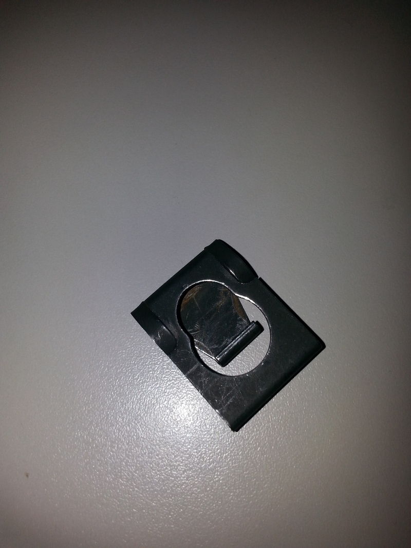

I would like to inform everyone that it was indeed the "Stoplight Switch" as it is called by AutoZone. However, take special care with that retaining clip as in the process of putting it back on it had flipped off on me rattled around and disappeared. So now I am on a mission to find a replacement.

Yeah, I should've warned you about that possibility. Sorry about that. But at least you got to the root of the problem. As for finding a replacement, AutoZone should have one on the shelf in a small set of retaining clips for GM's. Thanks for using 2CarPros. Come back anytime and bring your friends too.
