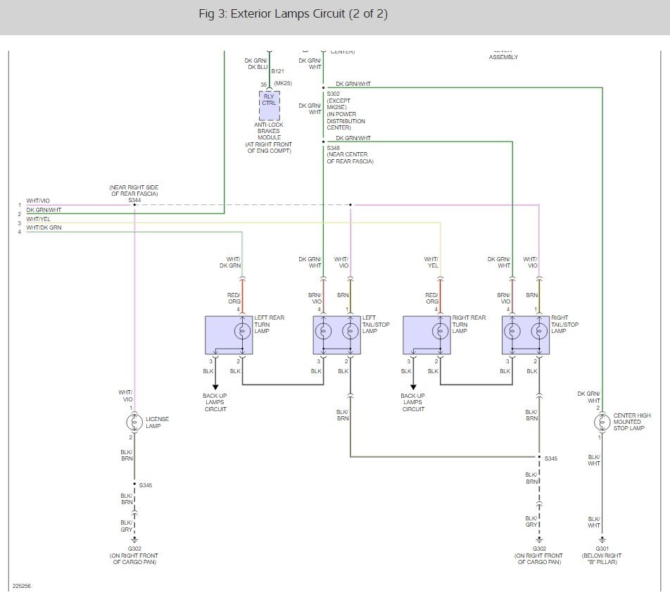

I have side lights but no brake lights except the one in the rear window and everything else seems to work.
Jul 11, 2017 at 7:15 AM
CARADIODOC
  • 34,381 POSTS

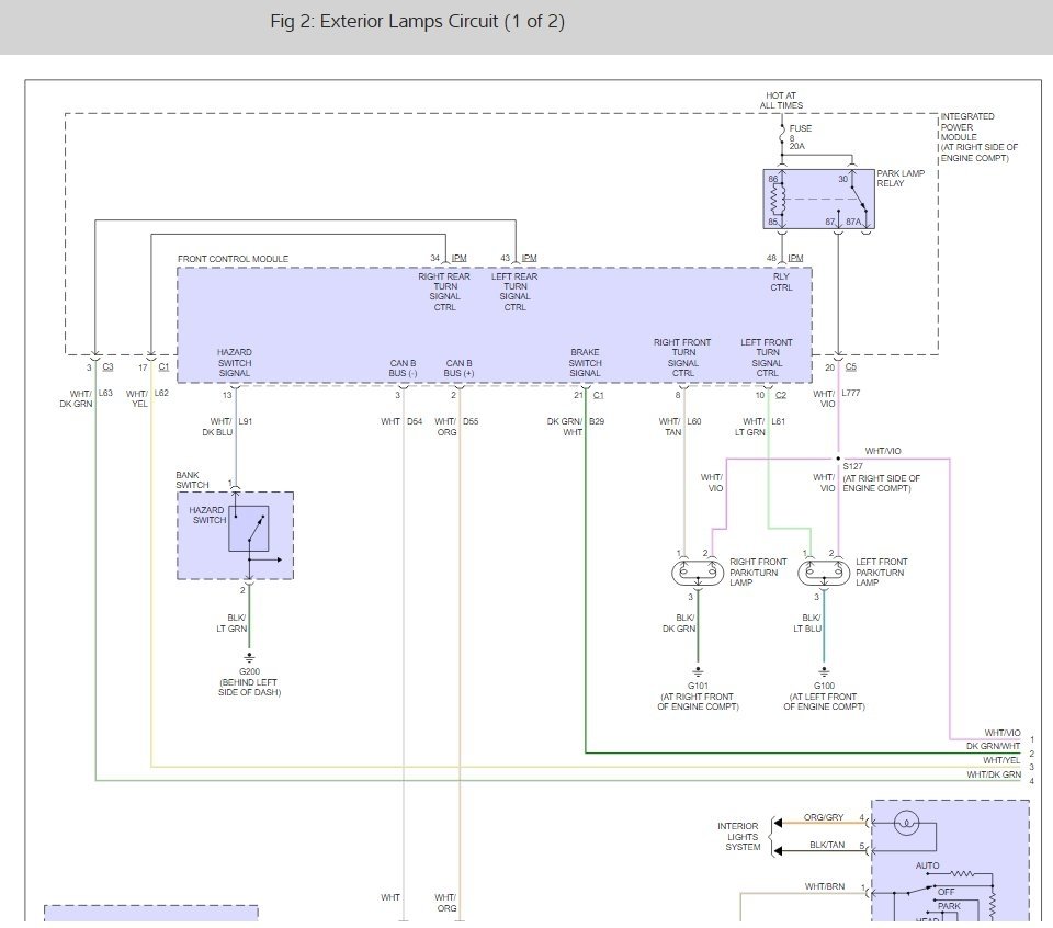

Since the center high-mount brake light works, we know the brake light switch is okay. That only leaves a break in a wire, which is not real likely, or a problem with the "TIPM", (Totally Integrated Power Module). This is another case of the insane engineers hanging an unnecessary, unreliable, expensive computer where it is not needed. The two rear brake lights are switched on and off by that computer. Common sense would have connected all three lights together and have them switched by the brake light switch. That seemed to work pretty well for almost one hundred years!

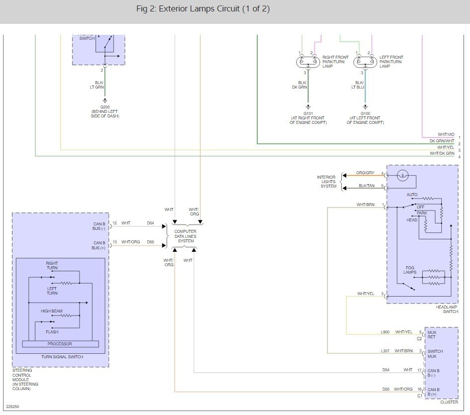

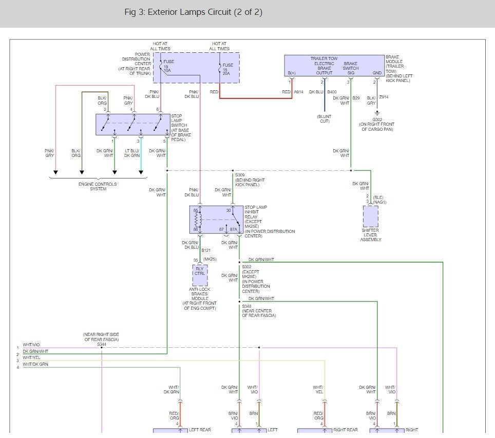

Don't rule out the brake light bulbs are out on both. Here are some guides and wiring diagrams to help you get the problem fixed.
https://www.2carpros.com/articles/brake-lights-not-working
and
and
and
Please run some tests and get back to us we are interested to see what it is.
Jul 12, 2017 at 4:37 AM
GRUMPY67
Hi Ken, I am not very technical when it comes to diagrams and stuff but I have put two new bulbs in I am right in saying the side lights are connected to the brake
light when they are one in the same bulb?
Jul 12, 2017 at 8:12 AM
  • 55,433 POSTS
Yes they look like they are the same bulb.
