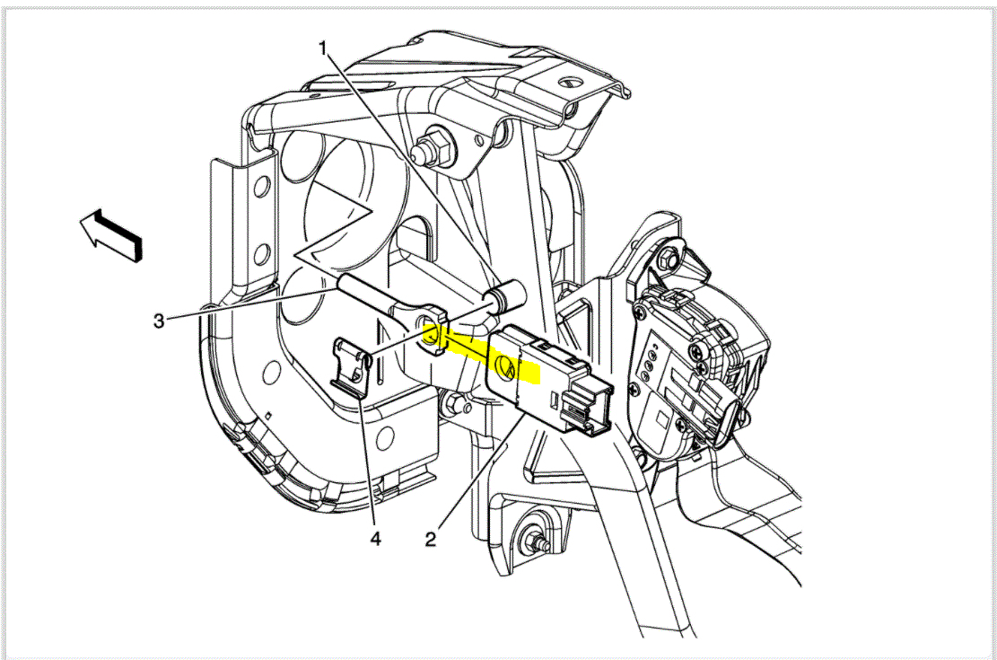

It sounds like an adjustment issue. Take a look at the attached pic. Make sure everything is together correctly. Also, pay attention if the brake lights are turning on when the brake is applied.

I took your advice and adjusted the switch to where I can hear it engaging and disengaging when I'm on and off the brake pedal, but the lights still wont come on. and yes the shifter is only stuck in park when the switch is plugged in.
Dec 22, 2020 at 2:48 AM
KAYDEN SPRUILL
But I was able to get the shifter to unlock when I did reposition it.

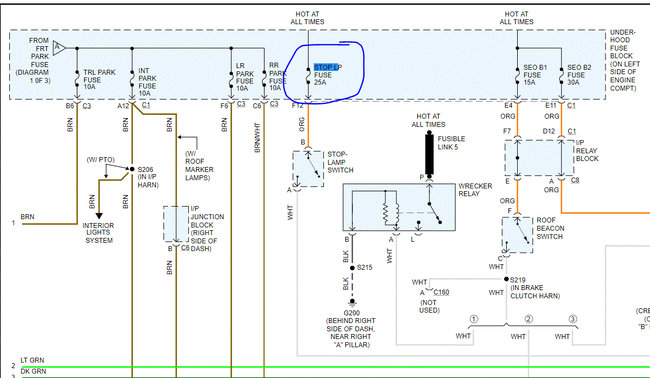

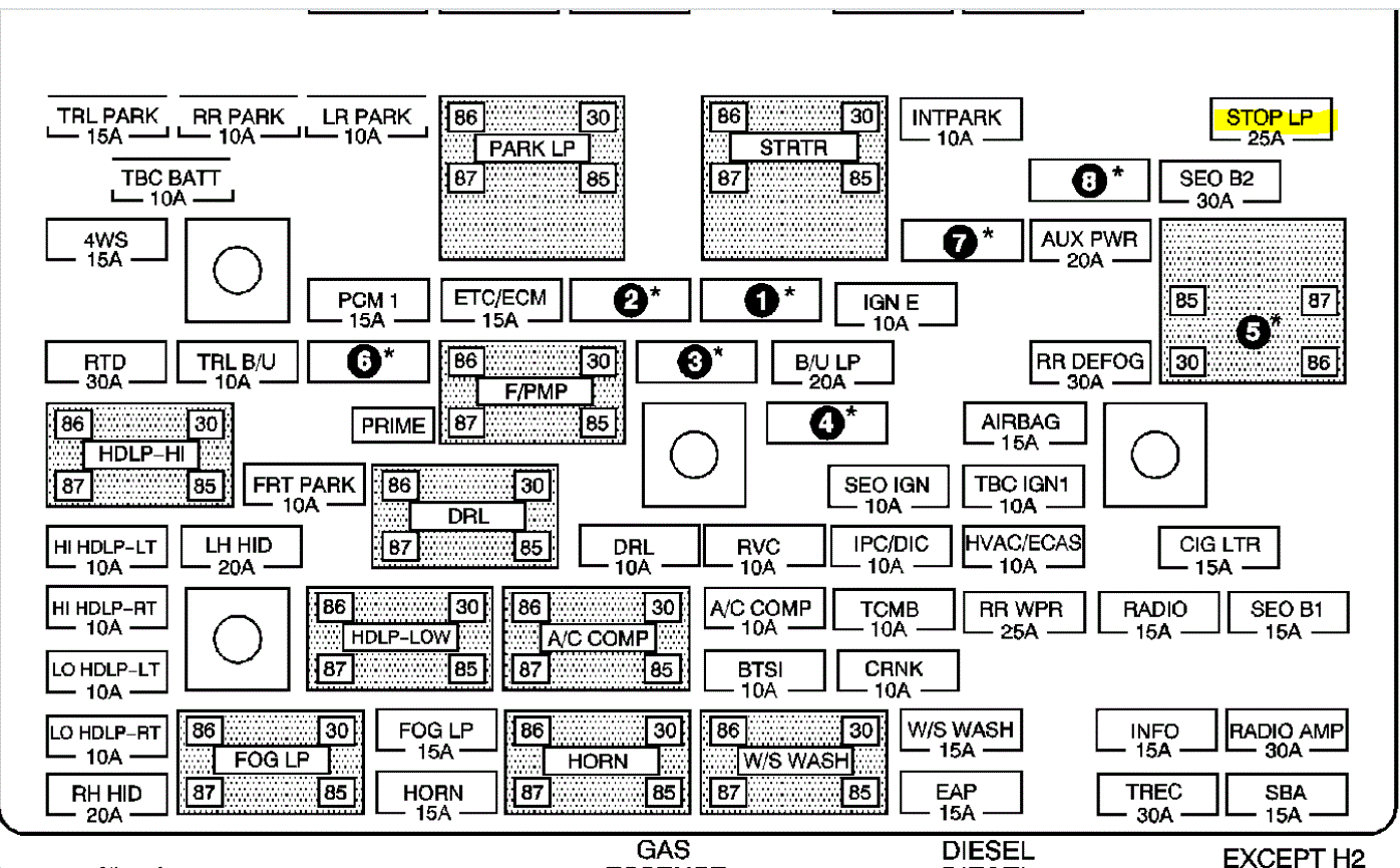

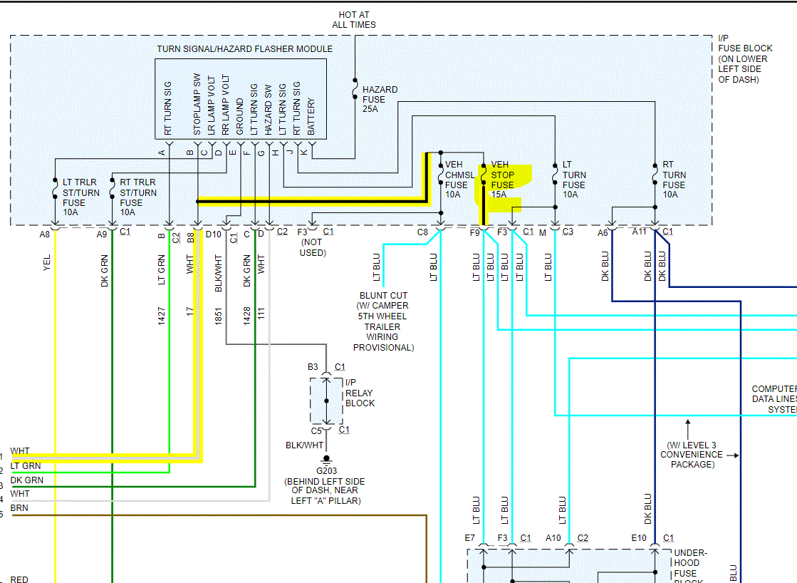

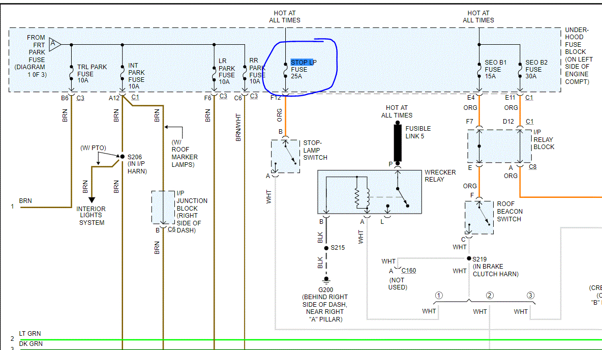

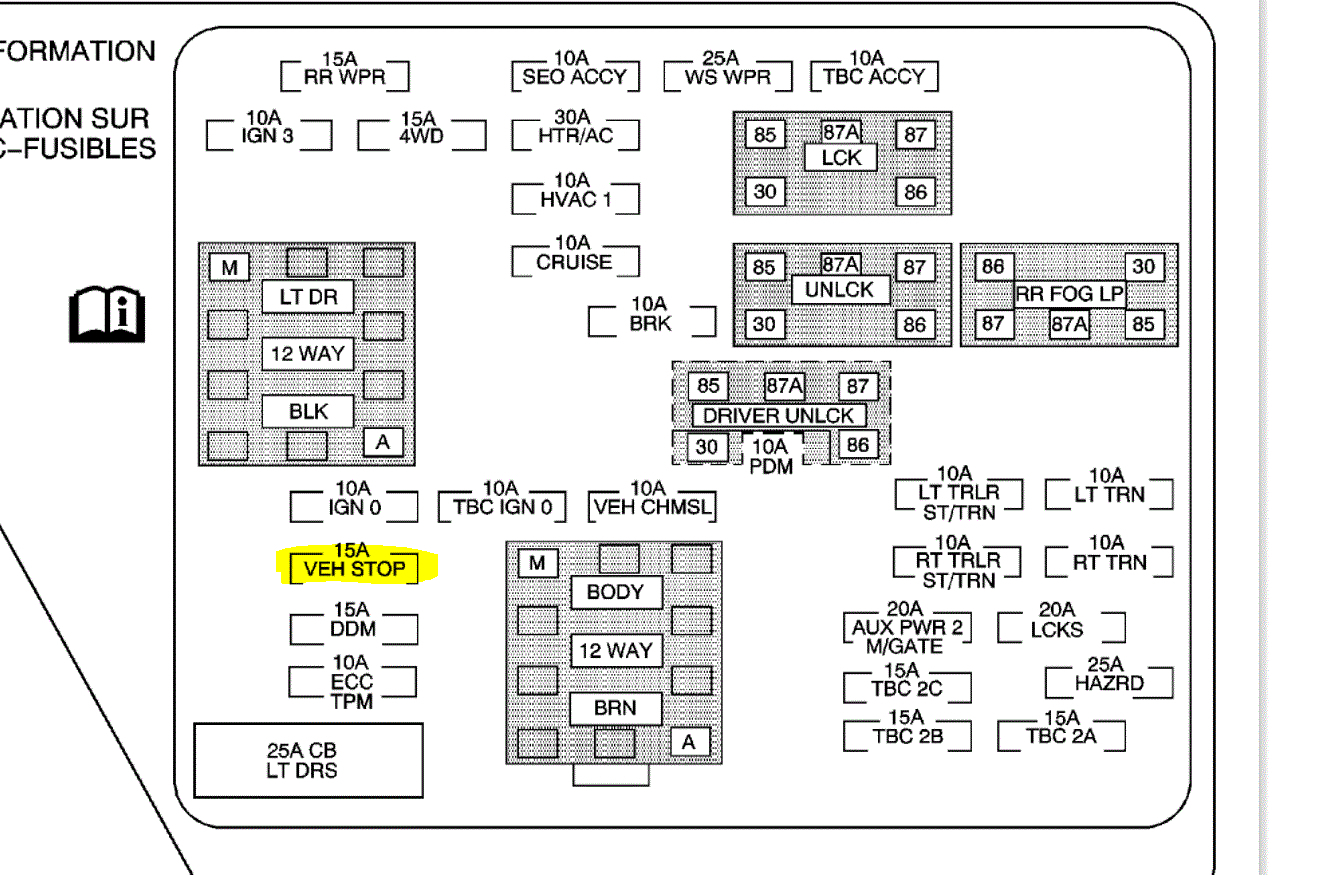

That's interesting. We need to start at the beginning. I attached two pics below indicating relevant fuses for the brake lights. I need you to check them and make sure there is power both in and out. I suspect we may have a ground issue causing power to back feed to the park lock actuator.
I also want you to check for power to the orange wire at the brake light switch. Additionally, check to see if there is power out from the switch at the white wire when the brake switch is actuated.
Pic 1 fuse is under the hood fuse box. Pic 2 is in the vehicle left side under dash. Pics 3 and 4 show fuse locations.
Here is a link you may find helpful when checking the fuses for power:
Here is a link to help with checking the wiring:
Let me know what you find.
