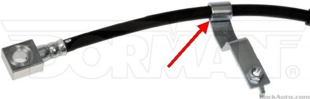

Hi guys. Lots of good answers and details, but I have a different solution. This happened to me twice on my Caravans, and once on a student's Neon.
Stop on a slight incline, shift to neutral, release the brakes, then observe if the van creeps down-hill on its own. I'll bet it does not. Place a block about a foot down hill of one tire so you don't look funny chasing after the van when the brakes let go. Crawl underneath and loosen the bleeder screws on the calipers. You'll see a little brake fluid spurt out, then the brakes will release. That proves the calipers are not sticking, and there was pressurized brake fluid trapped from returning back to the reservoir.
The elusive solution is to look at the metal bracket crimped around the rubber flex hoses. Rust builds up inside those crimps, and constricts the hoses. You can force brake fluid through the restriction with higher-than-normal pedal effort, but the fluid can't return on its own. Tho solution is to use a large flat-blade screwdriver or Channel Lock pliers to open up those crimps a little. This will also cause the higher and harder-than-normal brake pedal.
