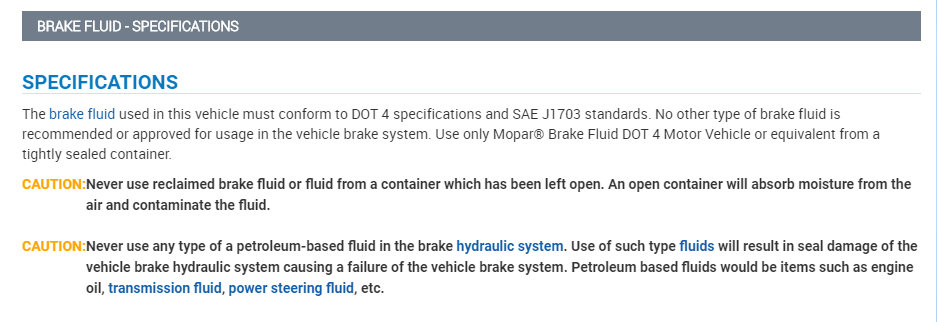

I need to know how much brake fluid my vehicle needs?
May 16, 2020 at 4:16 PM
There is no spec on how much brake fluid a vehicle needs because all air needs to be bled out and then the reservoir needs to be topped off. This means it could be one bottle or 10 depending on how much air was in the system.
Let me know the reason you are looking from the spec and we can go from there. Thanks
