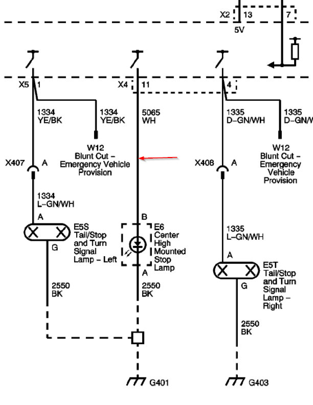

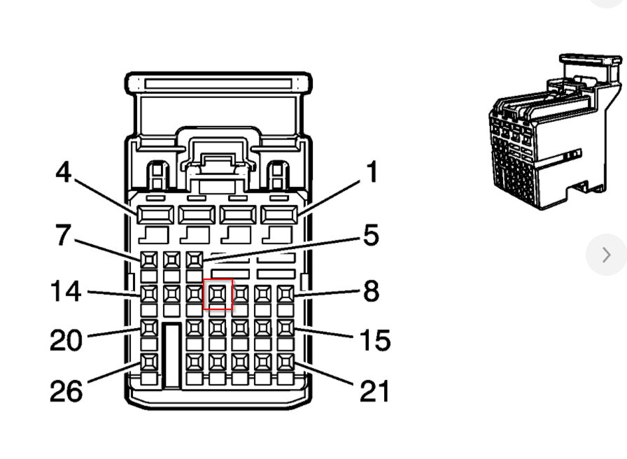

I am trying to hook up a RM -88400 Diode that I purchased from E Trailer on my vehicle listed above. I found the following answer for a brake controller and I am wondering if that is the same wire that I place the diode in line? Look for the black connector (all the connectors are different colors) that has 26 different slots for wires to insert into. In wire position # 11, there will be a white wire that carries the brake stoplight signal. Use the quick connector to tap the red brake controller wire into this circuit, and you will be good to go.
Sep 11, 2020 at 6:36 PM

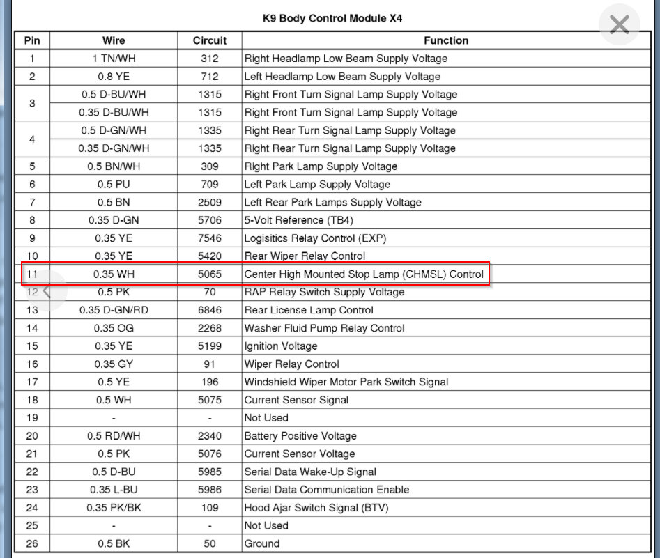

I assume you are talking about the connectors for the body controller? If so, you have two options for white wires but since they mention pin 11 they are not talking about the brake signal. That is the power wire for the third brake light. The brake signal wire is a 5 volt wire from the brake switch so I doubt it is that one.
I attached all the info for this connector and which pin it is. Let me know if I am missing something. Thanks
Sep 11, 2020 at 7:00 PM
  • 110,194 POSTS
I read your post. The red wire they refer to is what is being added, correct? What are you installing the diode to do? You don't want to add it in the vehicle's circuit. A diode is designed to allow power to travel one direction and not the other.

My question is: Is the #11 , white wire from the BCM the wire I need to use in this case.
Sep 12, 2020 at 12:42 AM

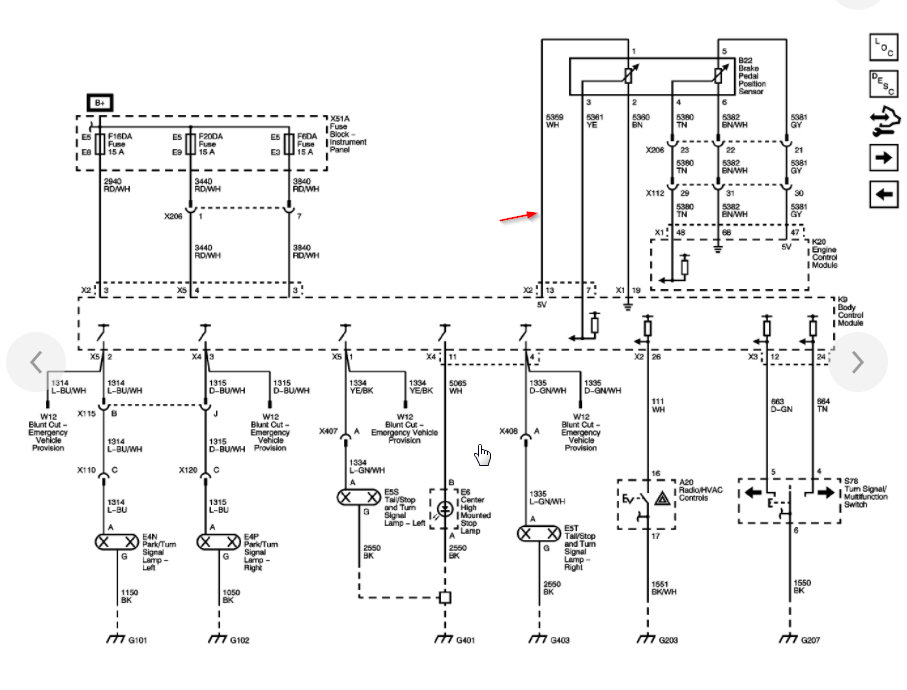

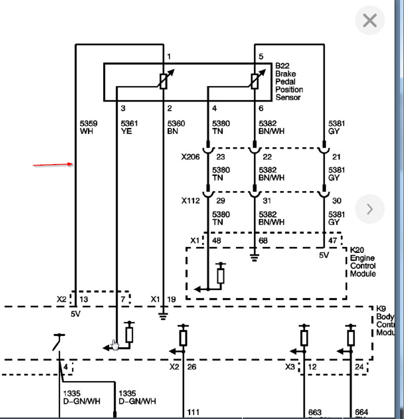

If you take a look at the wiring diagram I attached earlier, you will see that you have a brake pedal position sensor and not a switch. This is different in the fact that your sensor tells the BCM the position of the pedal and the BCM decides where to send power based on that position. A pedal switch that these directions are talking about is basically and on/off switch for the brake lights. So when you press the pedal enough to turn the switch on, it turns the brake lights on. With this vehicle the BCM actually turns the brake lights on.
Based on that, you don't have a "cold" wire coming from the switch because you don't have a switch. What I would suggest is calling the manufacturer of this kit and ask them which wire you will need with a pedal position sensor and we can help identify that if needed.
Let me know if this doesn't make sense. Thanks
Sep 13, 2020 at 6:49 PM
SULLY525
Thank you. I had already figured that part out. The #11 wire from the BCM has 12V when the brake is depressed but I am not positive that is the wire I need to tie into. I like your suggestion of trying to call the manufacturer. Will try that today. Thank you.
