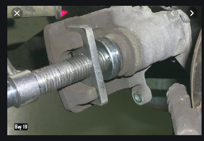

I tried to rewind my rear calipers with a pair of needle-nose pliers, but couldn’t apply enough pressure, I assumed due to corrosion. so I purchased a spreader tool that should have the right adapter. As I was reading on forums about other people who had trouble rewinding the caliper in their Volvo, some people said you need to loosen the parking brake bolt near the parking break lever to slacken the parking brake line so that the piston goes in easier. Is this required to get the piston in on my vehicle?

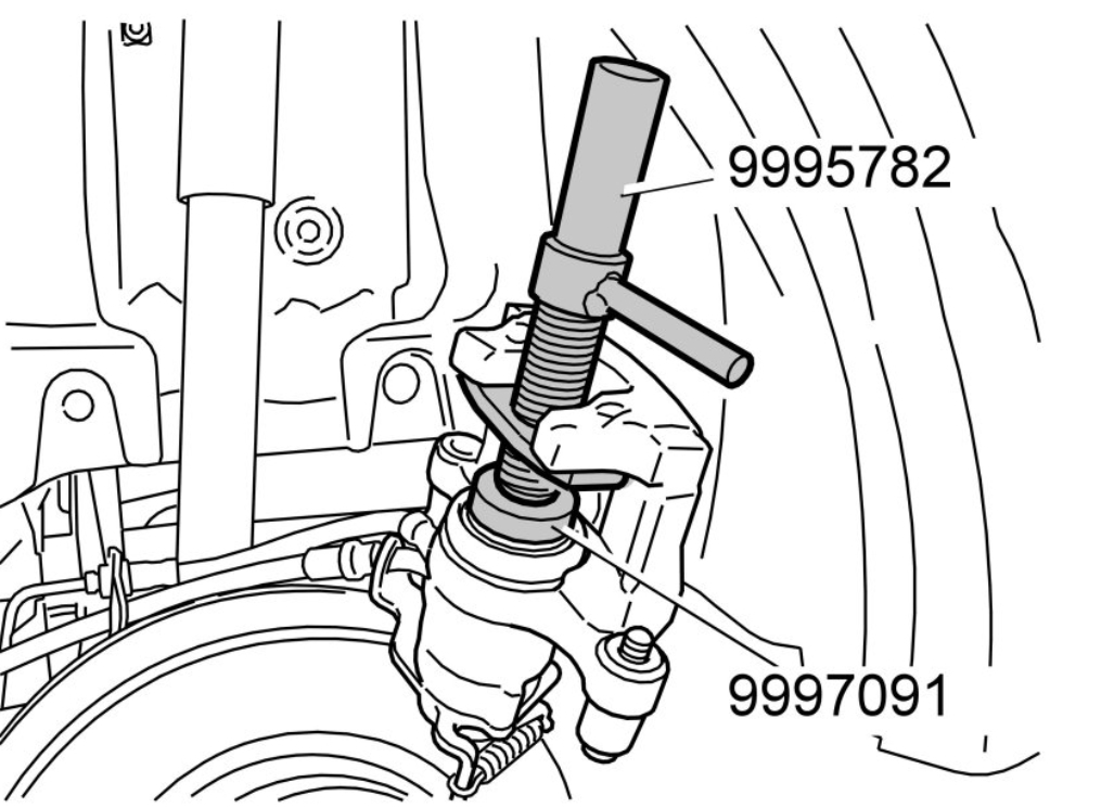

If the parking brake is released, it shouldn't cause this. Here are the directions for compressing the piston. Note, I don't know what type of tool you are using, however, the one called for applies pressure to depress the piston as it turns it in to place.

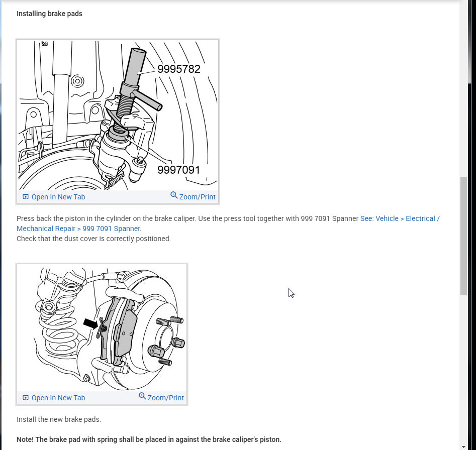

Installing brake pads
pic 1

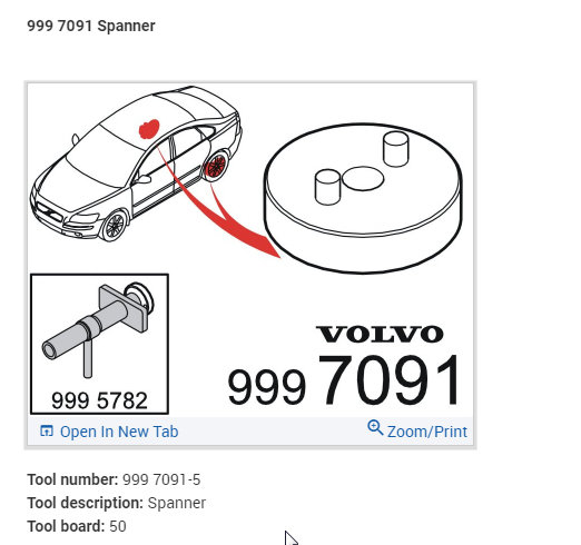

Press back the piston in the cylinder on the brake caliper. Use the press tool together with 999 7091 Spanner See: Vehicle > Electrical / Mechanical Repair > 999 7091 Spanner.
Check that the dust cover is correctly positioned.

Are you able to turn the piston?

There is nothing special with this so if the piston is not pressing back in then it is frozen and will need to be replaced.
I attached the detail about this tool that Volvo calls for if you want to compare it to the one you have. However, it is just a spanner tool so again I suspect they are frozen.
