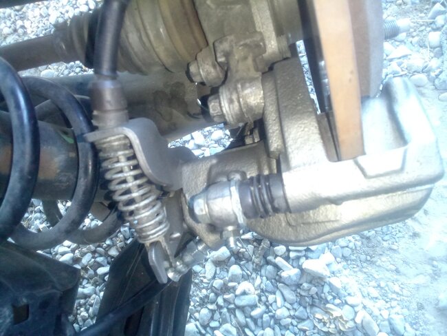

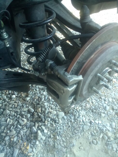

Okay, so I got the line and replaced it. Also pushed the brake while caliper was off rotor, and it pushed put yay! It did not, however, pull back in. Also rebleed brakes after replacing line and still not pulling back. I've replaced this specific caliper 3 times since Nov 2023 and it's done the same thing every time. Locks up gets whole tire hot just a mess. I've replaced the wheel hub assembly last time I did this as well. I've read that there might be air in the abs solenoid and I need someone with a special tool to release the air in the system. Does that make any sense or apply to a car this old?

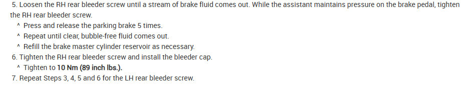

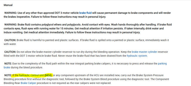

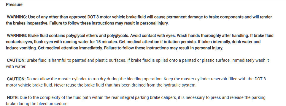

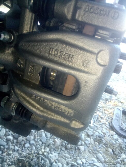

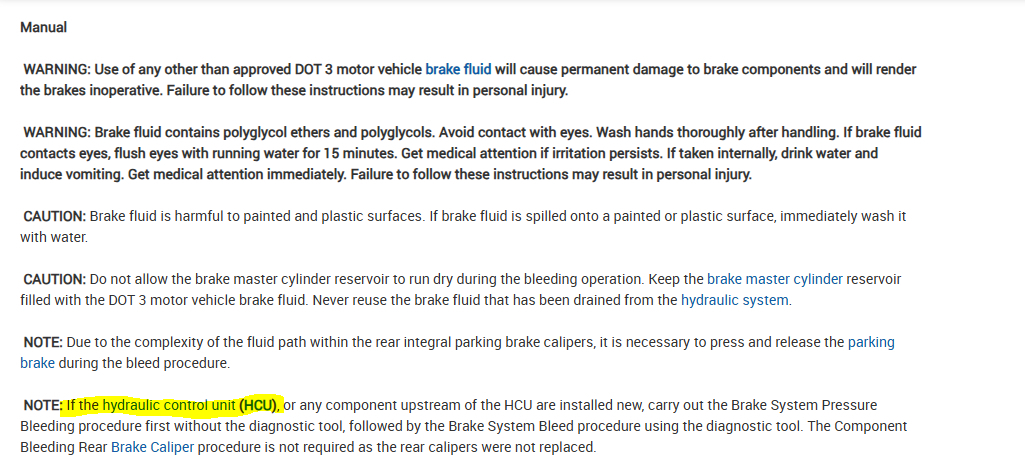

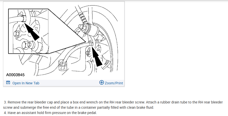

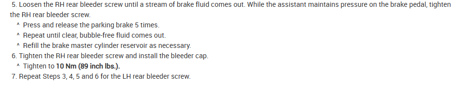

Do me a favor. Send me a pic of the caliper in question. Also, due to the complexity of the fluid path within the rear integral parking brake calipers, it is necessary to press and release the parking brake during the bleed procedure. Once the rear caliper is bled manually and the bleeder tight, it is recommended actuating the parking brake five times.

Nope I didn't do that with the parking brake. I followed your link on bleeding starting from caliper farthest from rez to closest. I had a helper pressing brake. Now that I changed the brake line when I was rebleeding brake fluid would come out of said caliper but as a drizzle not a jet like normal. When I tested the piston it was completely off the rotor. Then screwed it back in all the way installed and pushed brakes and it locked no wheel rotation nothing. No pressure released. I've had 2 of these same cars and the rear calipers have always been a pain.
However do you have a link for how to bleed the ebrake? I had no clue about that at all. I'll send I pic when I get home tomorrow. What part of the caliper do you want to see?

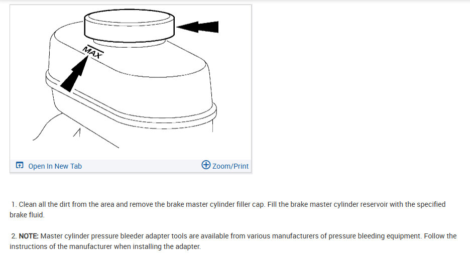

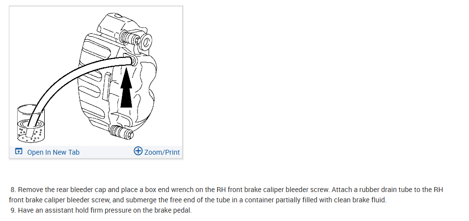

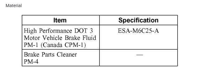

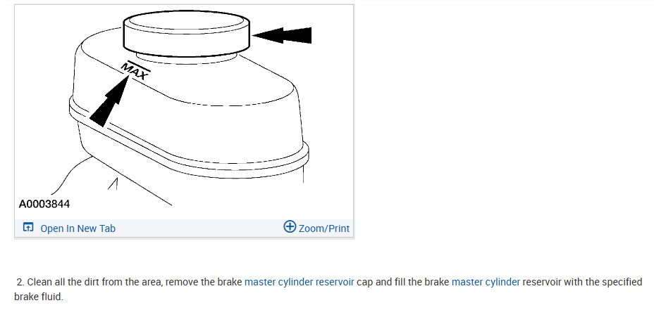

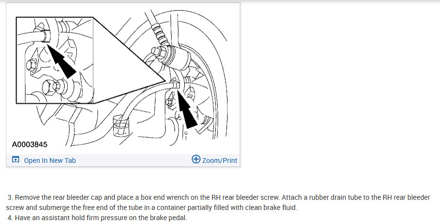

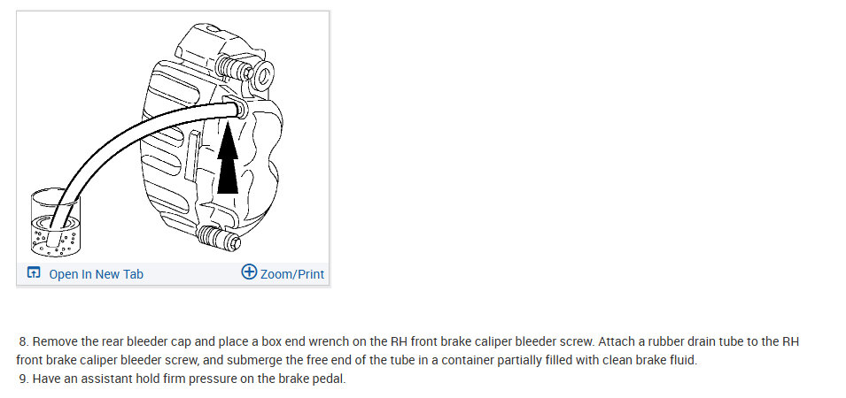

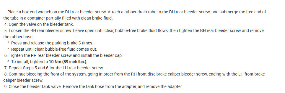

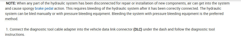

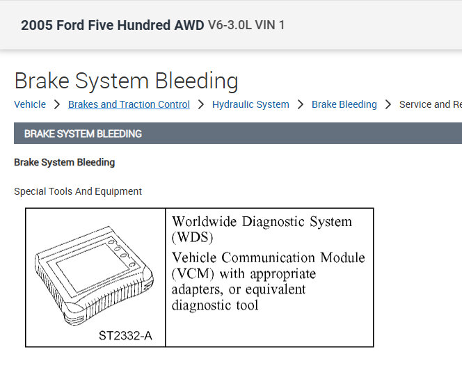

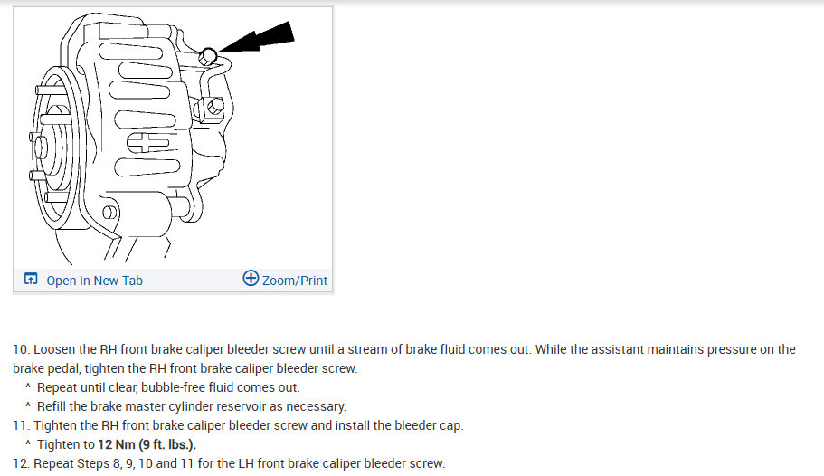

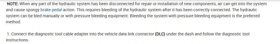

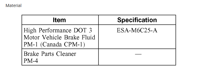

I attached the directions below from my manual. Note that it does indicate using a scan tool, but that is if the HCU was replaced.
I hope this helps. Let me know.
See pics below. Please ignore the next to the last pic. That was accidentally added, and I can't delete it.
Dec 19, 2024 at 9:49 AM

So I need a special tool to be able to do this? Also, some of the directions are repeated. Is it supposed to be done twice on the rear brakes?
Jan 4, 2025 at 4:11 AM
DAVENOOB
  • 371 POSTS
Also pic #7 says to close the bleeder valve then pump the parking brake until clear bubble free fluid comes out then close valve again. When do I open valve before I pump ebrake? Am I supposed to bleed as normal close bleeder, then immediately open same bleeder to pump the ebrake? Do I need to close bleeder valve between pumping brake and pumping ebrake if so what's the reason? Or is that just weird wording I'm just making sure I'm doing it properly thanks. Also, caliper does push out and I was able to twist back in with c-clamp and channel locks. Still doesn't release so want to make sure I get this ebrake bled correctly.
Jan 4, 2025 at 4:25 AM
  • 110,244 POSTS
After you bleed from the hydraulics, close the bleeder. Then, follow the park brake directions. Repeat the hydraulic procedure to see if there is air. If not, you're done. If there is, continue that process until no more air is present.

According to the directions, you may have to perform the procedure more than once. Did you try a couple of times?
Jan 8, 2025 at 10:47 AM
DAVENOOB
  • 371 POSTS
Sigh no I didn't do a couple of times. That said it has seemed to release a little but still need leverage to spin wheel. I'll do a couple more times thanks.

Okay, I know this took a while, but it worked thanks! Had car up on 4 5-ton jackstands and wind and rain came through. I woke up in the morning with the car sitting on the ground with no tires. One jack stand held so I had a jack point at least. I bled the brakes and e brake 4 times, and the 4th time noticed there were no air bubbles, but the fluid barely came through the bleeder, I had a hose on so I could watch bubbles. The 5th time through the cycle that rear caliper pushed a bunch of fluid through like it normally should! Guess what caliper is working properly! Thanks for the help, I'm not sure if clog in line or the eBrake not being bleed correctly. So that part of car is fixed thanks again!
