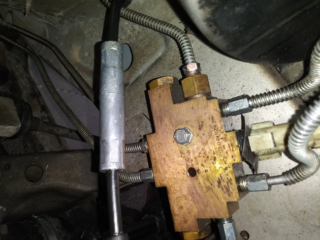

One day the brake pedal went all the way to the floor. I attempted to bleed the brakes I started with the rear passenger side and got no fluid. I tried the rear drivers side and got no fluid. I got fluid from the two front. I purchased a new master cylinder, when I was installing the new master cylinder I broke one of the bolts on the brake booster. I purchased a new brake booster install booster and master cylinder. I attempted to bleed the brakes again and got same thing at this point I checked the pads and shoes. Needed new shoes so I replaced and put new shoes. I attempted to bleed again this time I got no fluid from rear passenger . I did get fluid from all three other lines. I don't know what to do next.

If you got all the air out of the system and you do not have a pedal, I would try using some vice grips on the brake hoses. Clamp off the brake hoses with vice grips. Do all of them at the same time. See if you have a pedal. If you do, then you have an issue at one of the wheels.
If you do not, then your issue is the master cylinder itself not holding pressure.

After going through all of that I removed the brake lines and pushed compressed air through them and all are clear but still no fluid to rear passenger side. So the only other thing is the proportion valve. Can that be rebuilt? I have checked everywhere and no one has it or can get it.
Apr 16, 2020 at 3:08 AM
No, it cannot be rebuilt at all.
Did you not have a pedal when you clamped off the lines?
Does this have ABS brake unit?
Apr 16, 2020 at 7:37 AM
TOOSOC
How do I tell if I have a PV2/PV4 porpotion valve?
Apr 19, 2020 at 2:44 AM
It should be stamped on the valve itself.
Clean up the old one and look for the stamping.
Apr 19, 2020 at 2:46 AM
TOOSOC
The only stamp on the part is 628 0108.
Apr 19, 2020 at 2:52 AM
That is a PV4.
